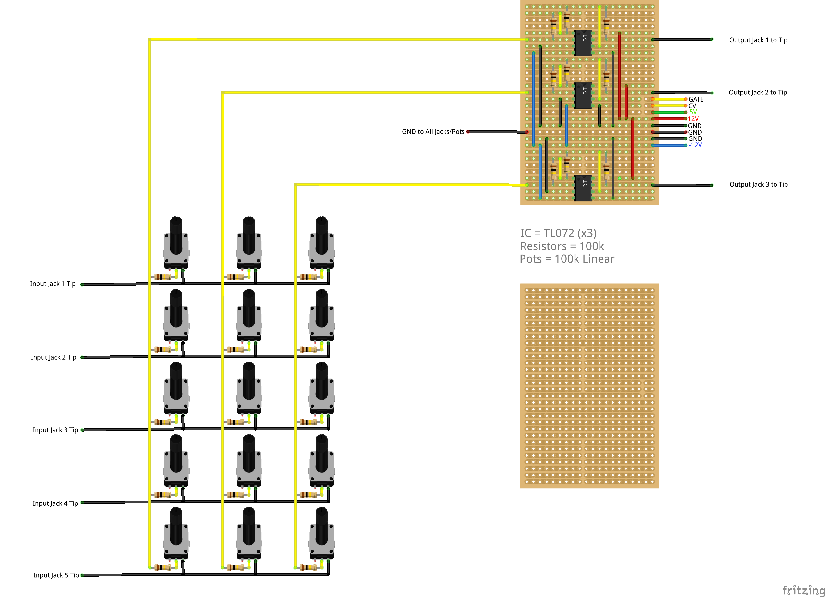

Subject description: Doepfer A-100 Matrix Mixer DIY Stripboard Diagram
I'm new to DIY synth...decided to start by building a mixer to get my feet wet. I decided to take a stab at creating the A-100 Doepfer Matrix Mixer from the circuit that is here: http://www.doepfer.de/DIY/a100_diy.htm.
I started by creating the stripboard layout below with small changes based on parts I already have (100k pots, TL072s), and was hoping that someone more experienced with this stuff can essentially check the layout to make sure I'm not doing anything crazy. Any help or suggestions are greatly appreciated.
