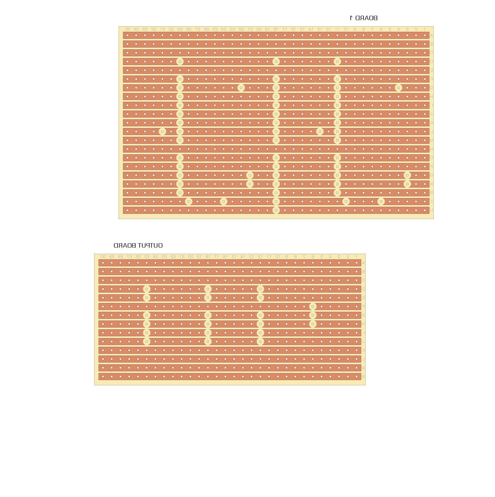

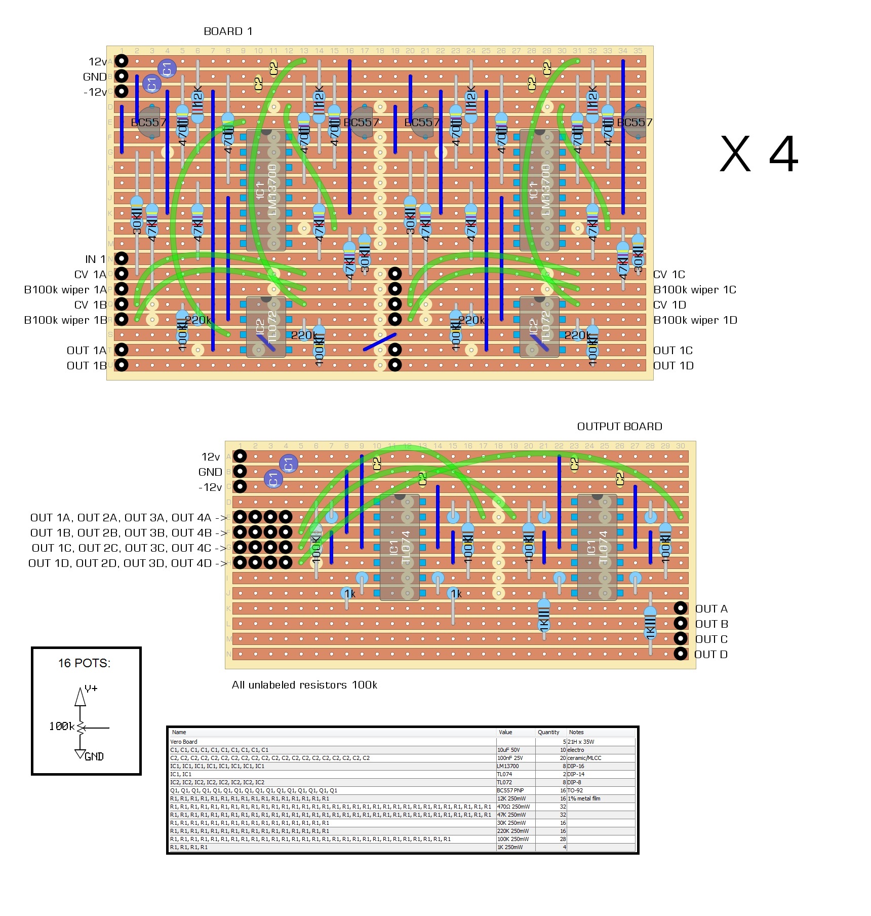

Feeling adventurous? Prove your stripboard manhood by building a 4x4 VCA matrix based on Nonlinear Circuits' Cluster module. 5 board stack! Shocked
Let me know if you find any errors in this layout.

also, some schematics would be nice...can't check for errors without schematics

Is it worth it? Probably not. It's a lot of work and takes up a lot of space. But then again there is a lot you can do with a VCA matrix. I'd say just buy the NLC board, its going to be a lot easier. I just did this one for shits and giggles.
Original schematics and BOM[/url]
