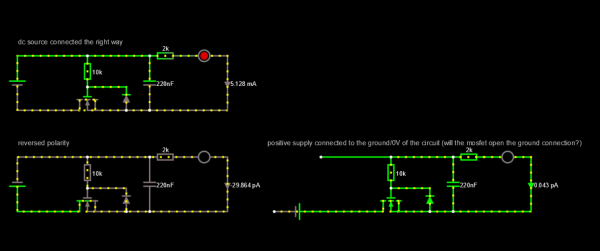

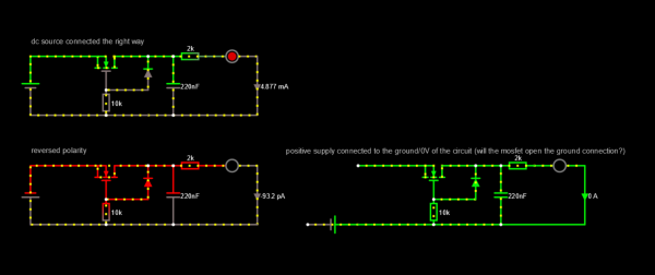

Hellooo,
the last days I was searching for a way to protect my circuits and synthesizers from reverse polarity and shorts. I think in the past I already did some damage to my semimodular synths, because I power several of my diy and commercial synths with one 12v power supply and a dc splitter cable. And I think what happend is that I accidentally connected ground/0v with the positive supply voltage, so there was a short. This happend a few times. I use those dc jacks with a metalring around the hole. In my circuits that metalring/connector is connected to ground, so when I plug it in and I touch the ring with the tip of the dc barrel connector and a midi cable or a audio/cv cable is connecting both synths, then I short ground to the positive supply. I even saw some little sparks the other day!
Now I am looking for a way to secure all of my circuits once for all. I guess there must be a nice way and I hope somebody here can help me. So what I always do, is I use voltage regulators (7805/7809) and I put a schottky diode in series, right before the input of the regulator. But I think this method is kind of useless when I accidentally connect the positive supply to ground, isn't it? So I thought it could help when I put the diode in parallel, but then I should use a polyfuse or something. And now I found another protection, which is using a mosfet. I read about it and simulated the circuit, it looked ppromisingso far.
But can I be sure that this circuit will protect my synthesizer against this positive-supply-connected-with-ground-problem? If so, I will start using it for all my diy circuits and designs.
Btw I am not sure but it could be that I fried my Behringer Neutron once, because of a similar accident. What definitely already happened, was that I burned some arduino-based circuit, because of no reverse voltage protection.
For better understanding, I added some screenshots of the simulation of the n channel and p channel mosfet protection.
So, what do you think is the best way to protect my synths? Very Happy

I see, everybody is to lazy to answer Laughing
The last days I really thought alot about different protection methods.
In the past I built a few of those circuits that looks like the one in the attached picture. I am not planing to put these circuit boards into any enclosure and I wonder if this is a good idea at all. My main concern is that there could be a risk of electrostatic discharges, that could damage my diy synths and also the connected commercial synths, when I accidently touch some of the components.
What do you think, could this be a real issue with those little pc mount circuits? Do they need any kind of shielding/enclosure? I wonder if its possible that an ESD event destroy ics or transistors, when the current is being reduced by resistors or other components? For an example when a discharge enters a eurorack modul through a mono jack cable, it is most likely that the first component it will reach is a resistor or a capacitor. This alone should prevent the semiconductors from damage, even when there are no clamping diodes. Am I wrong?

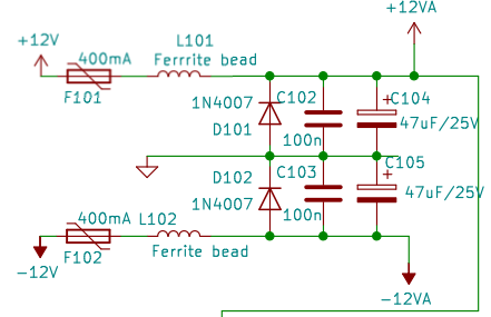

My way to protect against reverse polarity and shorts is like below: resetable fuses and diodes.
 Filesize:  31.05 KB
 Viewed:  11416 Time(s)
PostPosted: Fri Aug 16, 2019 5:30 pm    Post subject: Reply with quote  Mark this post and the followings unread
In-line diodes are better, but then you do have to live with 11.3V and -11.3V.
I also built this protection circuit quite a few times, but sometimes I just used a 10R or 22R resistor instead of a fuse. One time I had this variant on the breadboard and I was accidentally shorting something out and then the resistor burned a little hole in my breadboard Rolling Eyes looks like I am the master of short circuits!

Regarding your implementation of resetable fuses, if you use them on or before every module i guess you could get away with it, but when you use them on the main power rails bus board you might get some voltage drops caused by the resistance of the fuses itself and well your VCO's wouldn't like that and would drift.
Don't know the specs of the fuses you'Re going to use. But i now from my own experience, as i have build in fuses to protect the + and - 15V rails to protect my PSU and devices... After all i ended up replacing them with big much overrated ones (slow 4A upwards) that do have literally no effect in protection but also don't mess the rails voltages up. I no rely on my PSU's self protecting abilities. But for testing a module and using small fast types 100mA or 250mA they can be nice... Perhaps i would build for such testing purposes if you don'T have a separate desktop PSU a small adapter that can be sticked in between PSU and the PCB that needs to be tested first.
...And as pointed out by Scott already, i would use some connectors with reverse polarity protection that only fit into each other in one direction.
Depending on the amount of modules to power and size of your rack, you might also want to consider to not use those regular busboards as pointed out in several threads by Graham Hinton over at Muffs.
Because the cables are a bit thin and do introduce too much resistance and many modules would share a common way at length on the same small rails, which could create crosstalk, no proper gnd arriving at the modules because it's a few ohms above the gnd of the PSU, etc.
ixtern
Joined: Jun 25, 2018
Posts: 145
Location: Poland
PostPosted: Fri Aug 23, 2019 12:50 am    Post subject: Reply with quote  Mark this post and the followings unread
Typical resistances for some resetable fuses are (datasheet):
0.4A/72V: 0.71 Ohm,
0.5A/72V: 0.64 Ohm,
0.5A/60V: 0.425 Ohm,
0.5A/30V: 0.68 Ohm
1.1A/72V: 0.2 Ohm
1.1A/16V: 0.075 Ohm
4A/60V: 0.026 Ohm.
1. Resetable fuses should be used on every module.
2. VCO which pitch depends on the supply voltage is a very bad design and should be avoided or modded (in such a way I've modded TH VCO Maximus, for example).
wackelpeter
Joined: May 05, 2013
Posts: 461
Location: germany
Audio files: 10
PostPosted: Fri Aug 23, 2019 2:32 am    Post subject: Reply with quote  Mark this post and the followings unread
ehmmm... tell that Thomas Henry or any other VCO designer, all the different VCO'S i've build so far TH555VCO, 4046VCO, 258clone, ASM1 VCO rely on a stable voltage on their input within a few mV, otherwise the VCO pitch isn'T stable and you can't beef that simply up by adding bigger electrolytes on each of their power rails... a 10mV drop is on one of the rails is pretty much prone to cause some instability... Depending on what you have in your rack and how much is the difference of the current drawn at max and min this can cause bigger or smaller drops within operation, depending on your supply design and how much headroom you have calculated... and well, of course i'm not speaking about a permanent drop from 15 to 14,85V or so, i'm refering to a shifting voltage on the VCO's rails while running, for example going up and down between 14,85V and 14,95V or something like that...
I had run several of these VCO's in racks supplied by the MFOS wallwart PSU, with a 1A rating and drawing on the positive side something around 350mA... even with some cheesy 2x3300uF on each rail, before the regulator the output was slightly drifting after the regulators (somewhere in the 3-5mA region) that alone wasn't noticable but as said with a medium fast fuse of 1A before the module "bus" this translated into bigger differences that were noticeable...
So yes, adding them on each module would prevent that, but i think actually it's a bit of a overkill, at least for me and my personal needs.
I'll stick to the resistor/cap variant where i mostly exchange the resistors for ferrite beads afterwards.
ixtern
Posts: 145
Location: Poland
PostPosted: Fri Aug 23, 2019 2:56 am    Post subject: Reply with quote  Mark this post and the followings unread
wackelpeter wrote:
Thomas Henry designs were aimed to be rather simple and cheap, not to be the best. ASM-1 VCO had high-quality parts (like MAT-02, CA3140) but bad-quality design (no ref voltages, pitch pit connected directly to the supply lines), Buchla 258 also. Maybe anyway no so "bad quality" as a "cost cutting" designs as good stable voltage references were not cheap at those times.
Most of the modern analog VCO designs have separate reference voltages for pitch-sensitive parts of circuit.
BTW. For my unmodded TH VCO Maximus main source of instability was ... LED on the MIDI2CV module. Blinking LED causes a few mV change of the supply line what in turn caused small but audible pitch change (when freq coarse pot was not on the minimum position).
So in the times with no blinking LEDs, stability of the VCOs even without of dedicated reference voltages could be better Smile
