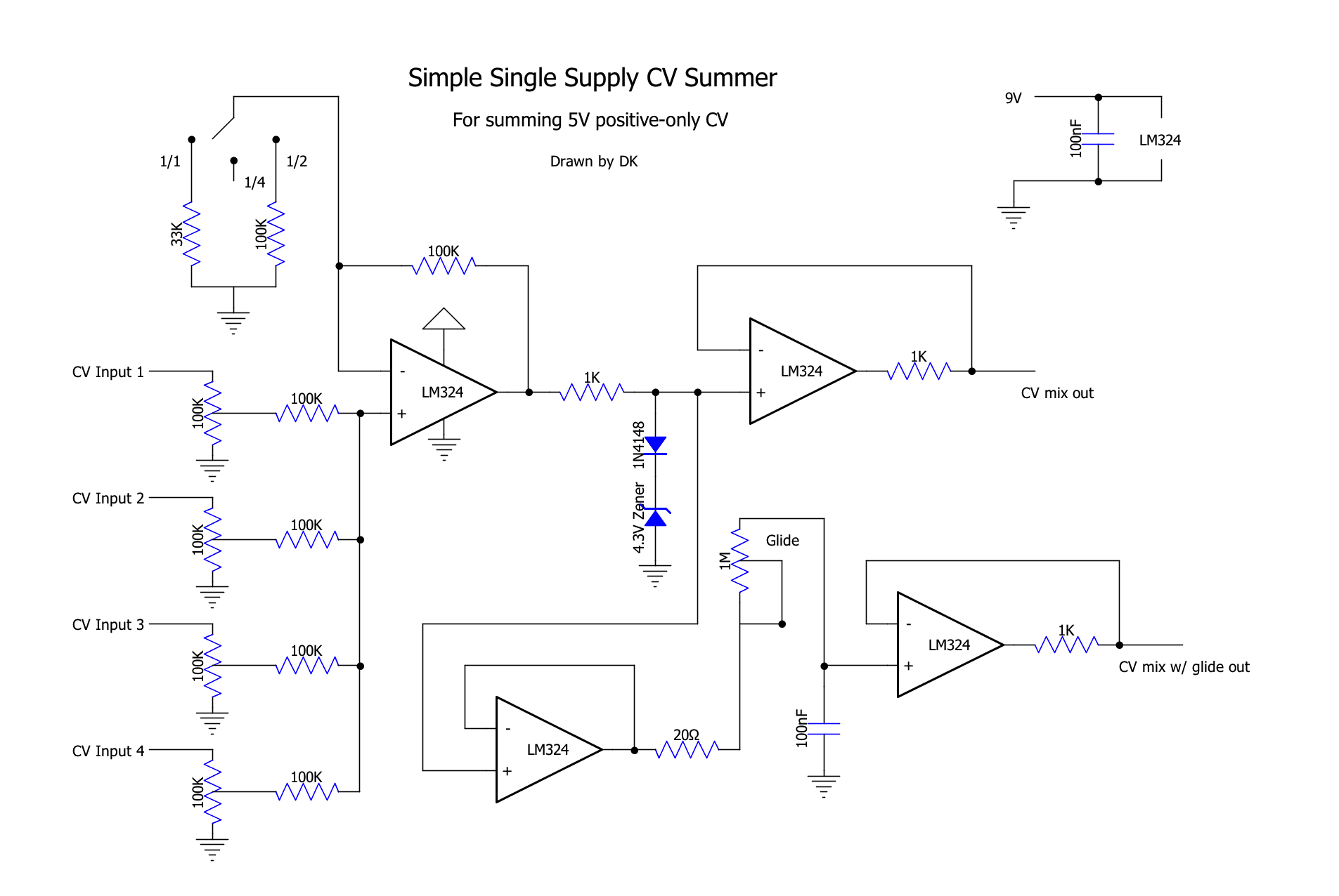

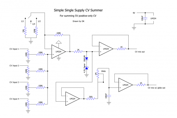

Juts a quick update. This is a schematic of what I've come up with so far. It has a switch for selecting whether the input CV's are mixed at 1/4, 1/2, or full strength. The only thing that's a bit uncomfortable is that at anything but 1/4 strength, there's the potential for the first amp stage to attempt amplifying the mixed CV signal over it's own supply voltage. With audio, that would just result in clipping, but I'm not sure what happens when it's DC? I'll assume for now a lot of dissipated heat and a fried chip...
Do you have any recommendations PHOBuS (or anyone else)?
EDIT: There are a few faults in this schematic, as discussed below. See below for an updated version.

Posts: 5881
PostPosted: Sat Aug 31, 2019 3:07 pm    Post subject: Reply with quote  Mark this post and the followings unread
dk wrote:
is the circuit on the datasheet not just a passive averager, with the op-amp serving as a voltage follower? There should be a resistor from the inverting input to ground for it to have gain, right?
I think that would be the resistors connected to V3,V4. which you could connect to 0V or another voltage which will create an offset.
But yes, you're correct, if you would leave those resistors out/unconnected it would be a voltage follower.
Now about the Simple Single Supply CV Summer schematic.
First thing is that you should add a resistor between the output of the first opamp and the diodes. Right now if the voltage gets higher than 5V
the diodes wil start clamping it down while the opamp will fight to get it higher. If you add a resistor the voltage difference between them can be
dropped across the resistor and they're both happy.
I am not sure if you'll get any problems with having the pots connected to the non-inverting input since that would change the input impedance.
Also I am curious as how you got those resistor values. Currently doing some calculations myself.
As for AC or DC, clipping is clipping. Unless your input voltages are higher than the supply voltage of the opamp it shouldn't really do any harm.
If you use an opamp as a comparator you're doing the same thing. Although sometimes opamps do behave a bit weird if you get close to the
supply rails. The only difference between AC and DC is frequency related. AC could have a very low frequency and practically be DC afterall.

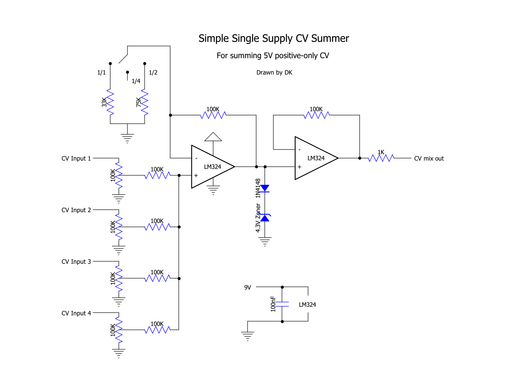

If I am not mistaken then instead of a 75K resistor you'd need another 100K resistor. That would get you a gain of 2x.
I think you're right. My bad!
First thing is that you should add a resistor between the output of the first op-amp and the diodes.
This is exactly why it's great to have someone to run ideas by! Very Happy Does it need to be a specific value? Or will a "standard" 1k do the trick? While we're on resistors, I guess I can leave out the 100k in the feedback loop of the output voltage follower, right? I think I only carried it over there when I copied the first op-amp stage...
So far, I've tried it with just 2 pots attached and 2 100k's just going to ground. I haven't noticed any problems connecting it to both unbuffered CMOS outputs as well as transistor buffers, but I guess it'll be good to keep in mind the change in impedance.
Posts: 5881
PostPosted: Mon Sep 02, 2019 4:14 am    Post subject: Reply with quote  Mark this post and the followings unread
1K should be ok, it's not very crictical but if it's too large the zener can't do its thing.
For the voltage follower you can leave out the 100K and connect the inverting input to the other side of the 1K resistor, so your output.
This will add current limiting while keeping the voltage stable when you connect a load.

Perfect... I'll update the schematic in repost. I'll try to measure crosstalk and see what the response looks like coming out of the pots, but based on ear alone (feeding a expo vco), my guess is that it's linear.
Just out of curiosity, I'll have the other half of the lm324 and just enough panel space for a banana socket and a knob, so I was thinking of trying to add a second output with a glide control, more or less taken right off the output section of Ray Wilson's 10 step sequencer (http://musicfromouterspace.com/analogsynth_new/TENSTEPSEQUENCER/pdf/tenstepschempage3_schem.pdf). If I were to take everything between U6-D and U6-C, excluding CV2 out which I wouldn't use, and try to stick it on to mine, what would be the past way to connect it? My first guess was to take the output off my circuit and connect to U6-D's non-inverting output on Ray's. If that's the right way to go about it, would the portamento/glide circuit have an impact on my 5V max level (ie would it be able to somehow go higher)? I realize that this makes everything a tad more complicated, but it seems like a pity to waste the space...

That should work, you could connect it at the same point as your second opamp so after the diodes.
Voltage won't go higher, if anything it would be slightly lower as a capacitor has somewhat of a resistance but it's negligible.
For measuring crosstalk you'd have to connect at least 2 signals/voltages to the mixer and measure if it changes at the source.
Think of it as using a passive multiple with one output going to the mixer and measuring the other ouput.
Since the resistor values are fairly large and your signals likely buffered it's probably not a problem, but it could be with the
standard 1K resistor used on outputs.

In the mean time, here's an updated schematic. Is this what you meant with keeping the output resistors inside the feedback loop? Also, how strict do you think the value of that 20R resistor in the glide circuit is? I'm not sure a value that low on hand, but obviously when I can get back to the breadboard I'll try whatever I do have. Is its function similar to that of the resistor between the first op-amp stage and the zener?

Posts: 5881
PostPosted: Mon Sep 02, 2019 2:13 pm    Post subject: Reply with quote  Mark this post and the followings unread
thumleft
yes, with the pot at 0 ohms the 20R limits the current that is the result of the voltage difference between the capacitor and the opamp, since the capacitor
can't follow the voltage directly (which is how the circuit works of course). Its value isn't very critical but you want it to be small otherwise you get too
much glide at the minimum setting. 100nF isn't very large though and it probably won't damage the opamp (at least not an LM324) if you'd leave it out,
but it might cause a bit of noise on the power rails so I'd leave it in.

The pots do in fact work linearly.
Cool. I think I might have a few 10R's floating around, so I guess I'll just wire them up in series.

An update and a question:
This does work fine for non-critical applications, but it's pretty dodgy when used in "sequencer" applications, where the knobs are independently stepped through. With the switch at it's highest gain, moving non-active knobs can shift everything by over half a volt, which is certainly quirky. Use for mixing LFO's, audio (my audio and CV's are both 0-5V), or other stuff where it doesn't matter works fine. The only adjustment from the last schematic I posted is that I have the glide pot wired backwards.
I do have a question about doing this with a bipolar power supply and the op-amps in inverting configuration, though. If you were to put multiple summing amps on the same chip, and/or multiple chips on the same board (PCB, vero, etc), do the ground lugs of the pots for each mixer need to be connected as close as possible to where the non-inverting input of their summing amp is, or can all pots of all the mixers be ganged together and connected to one ground point on the board?
