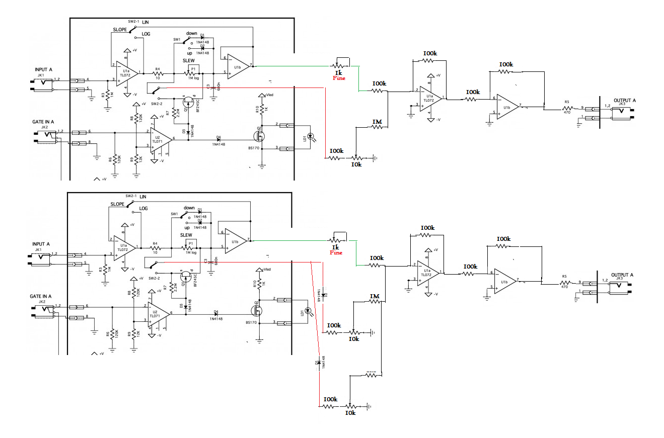

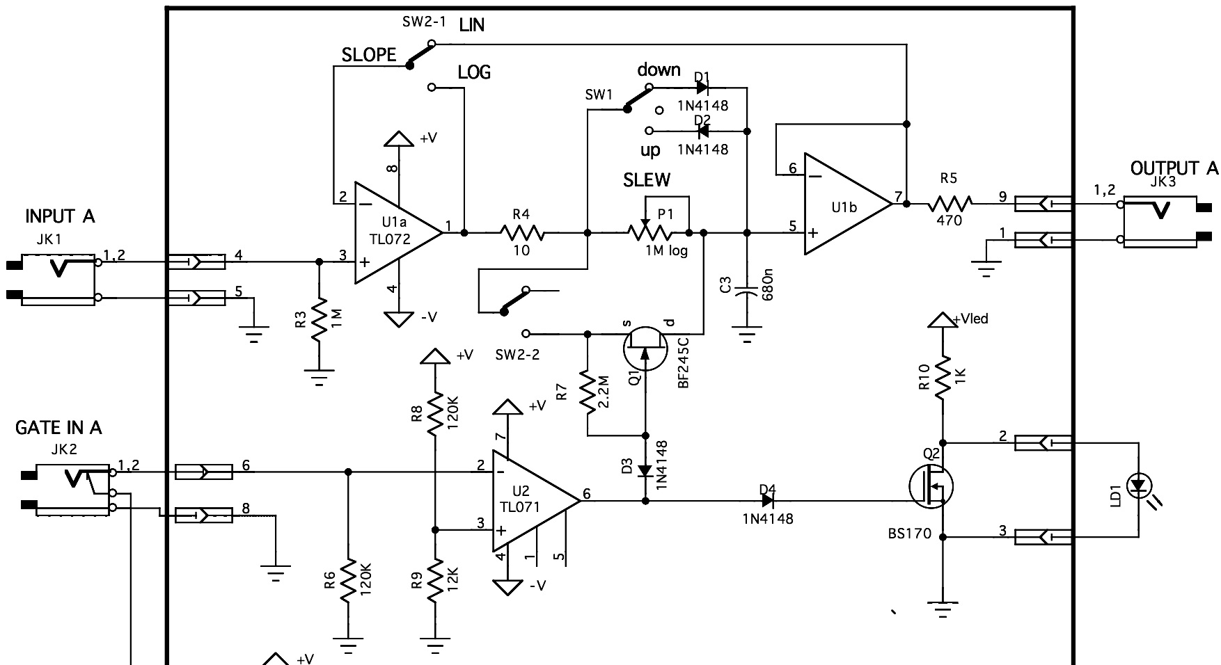

I build the yusynth Slew Limiter, works lovely!
I always care of tunings on my modular instrument, so i found some voltage differences at the output, that make my VCO connected to the Slew Limiter sounding a little out of tune (few milllivolts) when i switch betweewn LOG and LIN modes.
I send 1000mv to the Slew Limiter, it's output voltage is
-In LIN MODE: i read 997mv
-In LOG MODE: i read 1002
I read this post, which improved a lot the voltage drop:
http://electro-music.com/forum/post-269614.html
But it not resolved the voltages differences that i found switching between MODs.
Any idea in how to fix this?

i could imagine that this would work, but no garantie as always Peace Cool
what are u measuring if u put in a negative Volage?
the same but with negative sign?
if (so) printf "good";
else printf "u have to split up the two ways" Very Happy
the fine pot is for being able to adjust the log- voltage to exact 1000mV,
later adjust the lin-voltage
