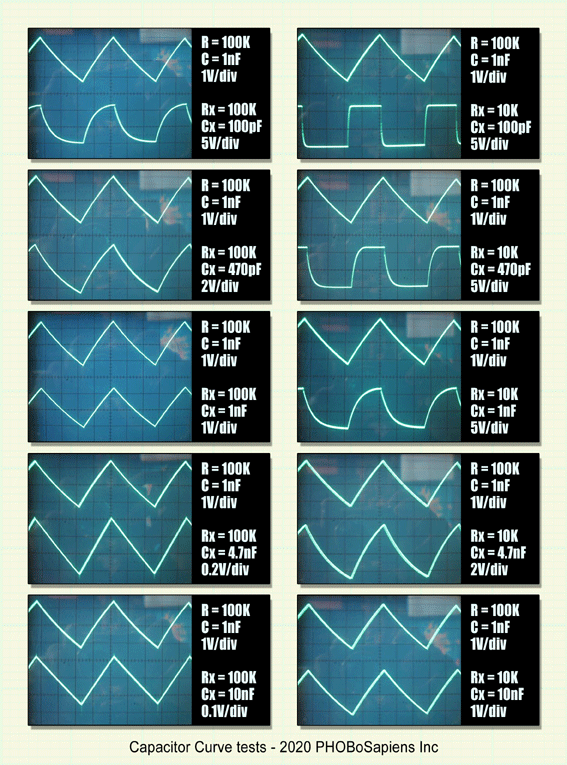

great video! I like the balloon analogy party!
And now I need to do an experiment myself because I was expecting the waveform to be much more curved.
So I wonder if that is caused by the resistor to GND (I would have connected it between in and output) or a result
of the schmitt trigger (doubtful).

Yeah nice movie, at first I was very sceptical about the anologies used .. and then was surprised by the balloon too Cool
Maybe the latter yeah .. the signal does not travel full range .. but it should still be part of an expo curve .. unless the schmitt trigger is implemented by feeding back directly to the input .. erm .. well ... a bit of the output is seen at the physical input ... could test that driving the gate with a resistor with a saw or tri wave.
Anyway .. also thought it to look remarkably flat.
yeah, now that I am a bit more awake it does make sense. I was thinking it doesn't matter what voltage you use to charge
the capacitor, ie 5V or 10V the cap doesn't care and the curve would look the same. But of course in this case the voltage it
gets charged with is higher than the treshold voltage at which the schmitt trigger stops the charging. And of course this goes
for discharging aswell so you cut of the top and bottom of the expo curve and then it looks a lot more linear. It's still less curved
than I was expecting though.
Doing some tests at the moment after recreating the result which does indeed look rather linear (but it isn't).
Posts: 5905
PostPosted: Mon Jun 22, 2020 1:36 pm    Post subject: Reply with quote  Mark this post and the followings unread
I did some tests driving an RC filter with the output of the oscillator to see if that would give somewhat different results,
spoiler: it doesn't. Of course I couldn't use a sawtooth oscillator as that would result in a squarewave output with a dutycycle
close to 0% or 100% depending on the direction of the diode. I tested with some different capacitor and resistor values and
the results aren't really surprising, as a matter of fact they are as expected.
The curve of Rx=10K/Cx=470pF, Rx=10K/Cx=4.7nF is more in line with how I thought it would look. This makes sense as
the window of the schmitt trigger is actually much smaller than I thought. With a 12V supply the amplitude of the voltage
over C seems to be only about 2.75V.

ha, you got me! nice analysis PHOBoS. yeah the wave is definitely not clean. I was surprised myself that I could get the oscillator to stay in tune over 5 octaves. but I think that makes it a very nice, rewarding first build for complete beginners.

I was just curious why it looked so straight. Wondering if somehow the schmitt trigger had some weird linearizing effect.
But it's just due to only using a small section of the expo curve which looks rather straight. Just using the oscillator to drive
an RC network with similar values would have been enough as it shows that the result is pretty much identical but I got curious
about what would happen with different values. If you make the values larger you get an even straighter shape but at a lower
amplitude. Note that for the oscillator itself it shouldn't make a difference what values you choose, the shape remains the same
and it doesn't have any influence on the tracking.
I don't know yet how you added voltage control though so maybe it affects the treshold levels which will also change the
waveshape. Looking forward to the next video Wink
