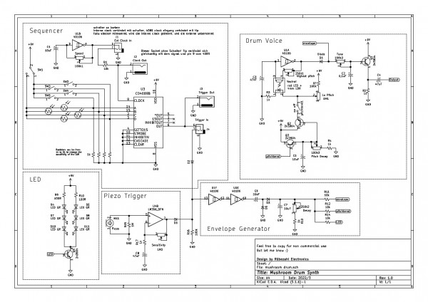

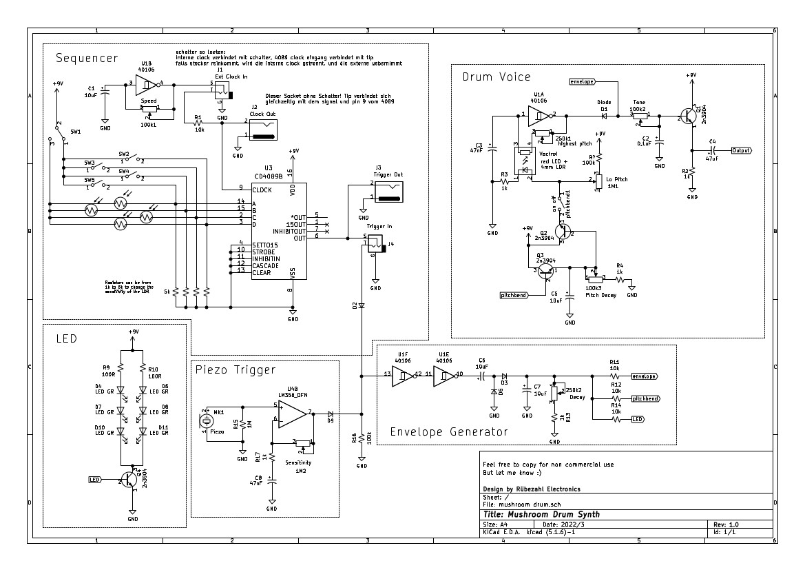

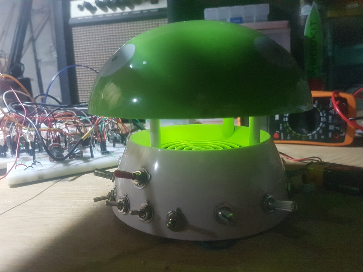

This drum synth is housed in a mushroom shaped mosquito light. It can be played by drumming on the mushroom head, or using the internal sequencer, based on a CD4089. The Sequencer can be controlled by 4 switches for the logic inputs of the 4089, or light sensors (housed in the mushrooms head as well) respectively. The sound is a pitch bent square wave oscillator with variable decay.
About the name: The chinese characters meaning is literally Drum Mushroom, but the pronouncation is gǔgūgū, which makes it sound very funny Smile
Here a little video of me playing it, both by hand and automated: video
The available controls are:
- Sensitivity (of the trigger pad)
- Sequencer Speed
- Decay
- Pitch Decay
- High Pitch
- Low Pitch
- Tone (Filter)

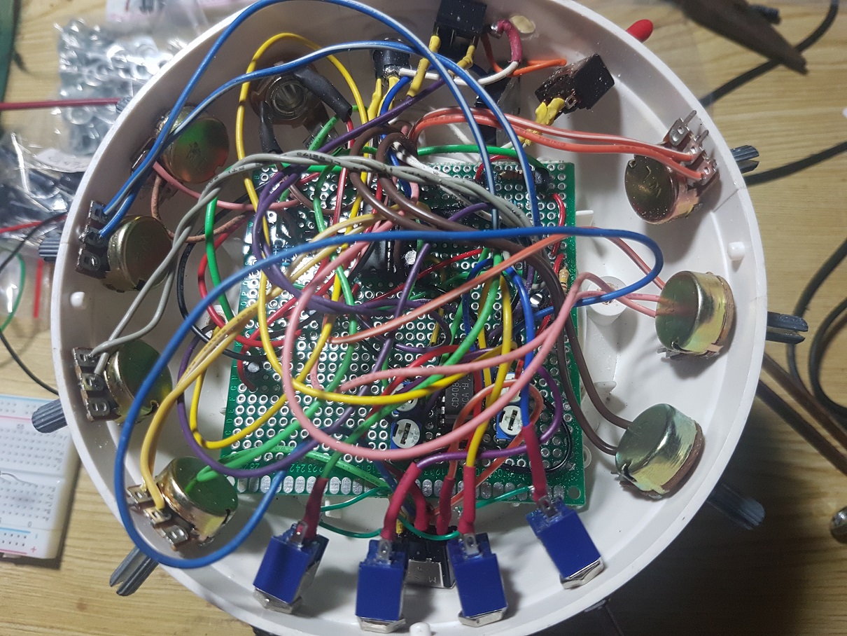

Like so often, i had the basic circuit running very quick, but many little details i wanted to add, and decisions i had to made resulted in around half a year that this mushroom finally made sounds. It’s a mosquito trap in mushorom shape, and i housed the circuit in both the head, as well as the body, so there are quite a lot of wires running between the two boards, just through the 4 thin plastic sticks, which made wireing also a little challenging.
