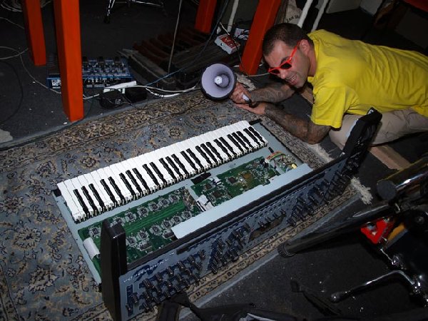

Now you can open Andy.
Be care when you put the Andy down, in normal position,
make sure it doesn't open accidentally.
To open, you have to pull up the upper panel and put it in position like you see in these pictures:

thank you so much,
by the way, you look great speaking to the a6!

cyclops
I open everything I buy...
PS
I put in the Andy before close it a bag of silica gel,as into my Wurly A200, in my Rhodes and into my Phatty.
Don't forget to visit this website:
www.teslawood.com
Edo

PostPosted: Fri Sep 21, 2007 1:21 pm    Post subject: Reply with quote  Mark this post and the followings unread
Thank you, that is excellent and should be added to the tips and tricks document.
I don't have one in front of me to double-check your procedure, but I have to add one thing: To lift off the front panel, hold it by the endcaps and pull the bottoms of the endcaps out away from the instrument just a little bit, as it may catch and break if you are too eager.
And to emphasize about reassembly: If you have removed any of the front panel PCBs, reseat it when finished and partially install two or four screws to barely hold it in place. Make certain that each button is loose in its hole, and holding it there, tighten the screws. Making certain that all of the buttons are loose in their holes and are as normal. If any are offset, the associated switch will be broken as you tighten the many screws.
This is obvious, but there are so many buttons on each PCB that it pays to be attentive.
You may also wish to run the self-test to check all buttons and pots after you've replaced the FP PCBs and ribbons/wires, prior to replacing the front panel and screws.
It helps to have an awl or other thin, long metal piece, to put through a center-of-unit screw hole to hold the ribbon metal in place. Set a couple of screws and you're fine.
Thanks again, hope this helps.
