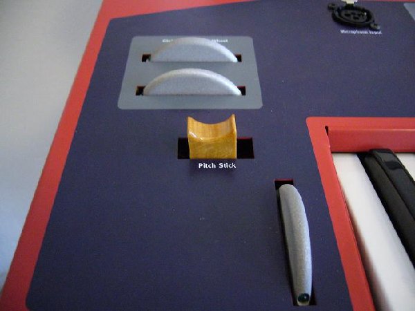

Hi everyone !

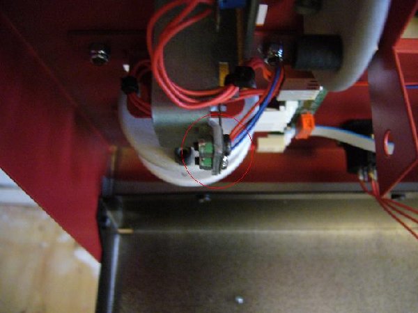

i bought a second hand g2x recently, everything is fine except for the pitch stick, which is not exactly centered. No big deal since it's perfectly functionnal, but i'd like to fix that at least for aesthetic purposes. (it will probably be more comfortable to play too) Has any of you ever dealt with something like that ?
I've opened the case but couldn't figure out what i should do, the pitch stick (the wooden part) is attached to this quite thin metal blade and i certainly don't want to break this...
(and this is my first post so Hello everyone ! i've been reading you for quite a few weeks now, and i am learnig a lot of things, so thank you !)
here are two pictures... it's certainly not a huge problem, and i really might leave it like this, but still. the thin metal blade is straight, i guess it's the part on which it is fixed which is not bent enough !

welcome very, and congratulations with the "X".
I'd not try to bend the metal pitch stick blade itself, it has some pressure sensitive resistors glued to it and people have been reporting problems with those loosening up without even trying to bend it.

PostPosted: Mon Apr 21, 2008 5:11 pm    Post subject: Reply with quote  Mark this post and the followings unread
Having done similar tweaking before, I'd recommend starting with the least invasive approach and see where you get before moving on to more radical (and possibly damaging) methods.
First, I'd look at that metal bracket and the way it attaches to the rest of the main structure. ie: - the end you can't see in the photograph. If it's screwed into place then I'd look at packing just a layer or two of 80gsm paper under one side of the attachment point. As it only needs to shift by a few degrees, this could sort it easily without making any permanent changes.

PostPosted: Wed Apr 23, 2008 5:55 am    Post subject: Reply with quote  Mark this post and the followings unread
Uncle Krunkus, this sounds like a good idea !
i've just opened it again, so here it is : the blade with the receptor is screwed on a larger metal part, which is attached to the case with screws too. Unfortunately this metal part also holds the modulation wheel, so i can't put paper under it, since the modulation wheel is well positioned. (there are also a couple of wire coming from parts attached to this metal part, some of them seem to be soldered on the mainboard. The cables are not exactly loose so it would probably be tricky to remove this part)
I guess i could put some paper between the pitch stick blade and the piece it is attached to. I would try to do that but i need a thinner screwdriver to reach this ! maybe i'll try this later, if i get the proper tools.
