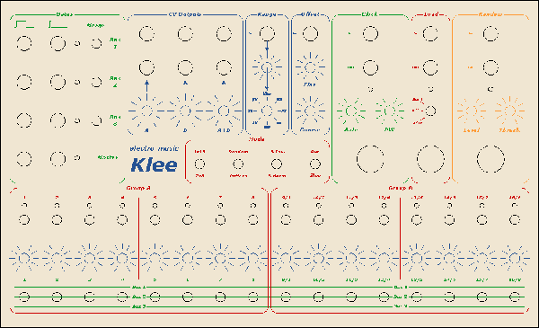

Ok, here's my design:
here's a blurry photo, not fully done, but assembled anywayz...
box by hammond, gfx printed on papilio inkjet printable clear adhesive vinyl.
 Filesize:  72.5 KB
 Viewed:  417 Time(s)
here's the design in digital finery, if that's your taste, times being what they are...
 Filesize:  25.89 KB
 Viewed:  517 Time(s)
Posts: 24500
PostPosted: Tue Jun 10, 2008 2:42 pm    Post subject: Reply with quote  Mark this post and the followings unread
Clear layout, nice looking panel!

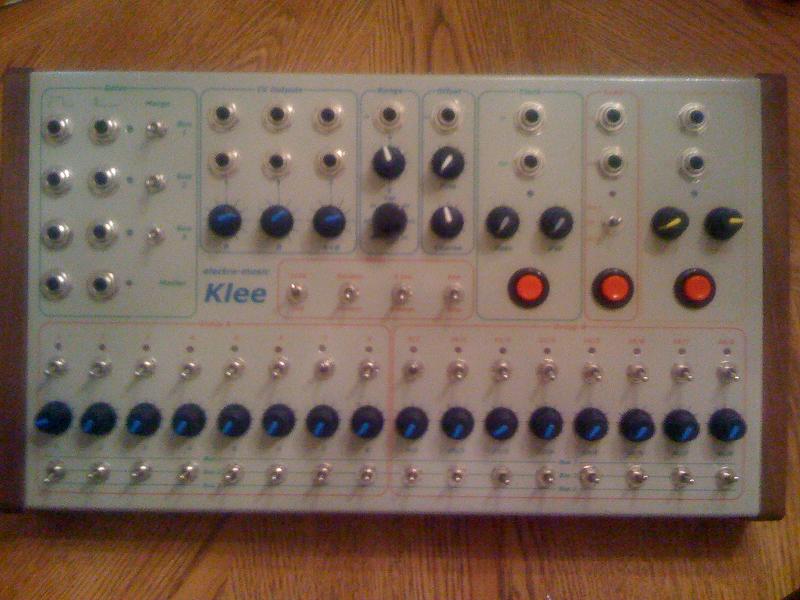

My Klee V2. Original a 19" panel homemade with sharpie marker (posted back in this thread I believe).

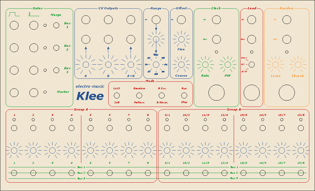

PostPosted: Mon Jun 23, 2008 2:26 am    Post subject: MOTM KLEE Panel Design
Subject description: 7-Space 5u high panel
Hi guys,
Based off of my MFOS Rotary panel, here is my in progress KLEE panel. I hope to get the kinks worked out of this and maybe production of them through someone (no announcement yet though). The start washers are where push button will go. Large nuts = jacks, small nuts = switches, etc. Those black plugs on some of the holes are Lumex LED's upside down to represent the style I will be using. Thoughts?
Thomas

Thanks for the answers about the sliders guys. I was thinking of having a go at designing one to become a bridechamber panel but not after that Shocked I'm buying one for sure. Looks great!
Edit: I just noticed you said no announcements yet. Didn't Scott Deyo say it's "officially ripped off"?
The only thing I'd change is expand the oval a bit to better fill the space that is available. That would give us just a little more space between the knobs.

Yeah, the knobs might look a bit close together, but in my rotary MFOS build the entire center circle of "fine" knobs is as close together as the closest of spacing on this build. I have no experience yet with the KLEE but those who I have spoken with say you end up playing with the load switches often. I don't want to get the oval so big as to interfere with the bus switches for gates or load.
The circle/oval is easy to adjust based on tweaking from the outside edge of the pots and there is no interference with the grabbing of them from both sides either. The only thing I might change is to either shift the oval to the right a bit or two move the switches by the external input jacks on the left. Now that I have had a full night of sleep I seem to think the spacing could be more balanced to the right side of the module.
Scott Deyo... hold on any planning till we get this just right please. Yes, Scott will likely be working to get this out to the masses for one of his awesome prices. Glad to see you're interested and thanks for the feedback. Can the KLEE users out there give this a functionality look over please? Thanks guys!
