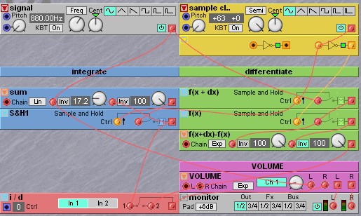

Now for differentiation, it is defined as:
Hmm we can't divide, but luckily we don't have to as we can't truly differentiate anyway (as it's a continues operation that we can't perform, we can only perform the difference operation, a time discrete variation) delta-x will be a small constant so we just have to amplify.
So what does it say, well we have to calculate the difference between a value at x and a value at x + delta-x. Then we have to divide by delta-x, which is a constant value so we can multiply by it's reciprocal.
So my original circuit idea was not quite right.
Ok a patch & a picture to illustrate, I'm not able to connect a scope (as my NM's are boxed into the radio thingy) but on theoretical grounds I believe the output signals should be phase shifted by 90 degrees with respect to each other.
The integrator should phase shift into the other direction than the differentiator does. The original signal is always on the left channel, the red switch selects either the i or the d signal for the right channel. I think I got amplifications and attenuations set to reasonable values, but it all depends upon the frequency.
Jan.

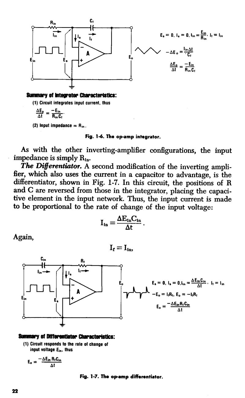

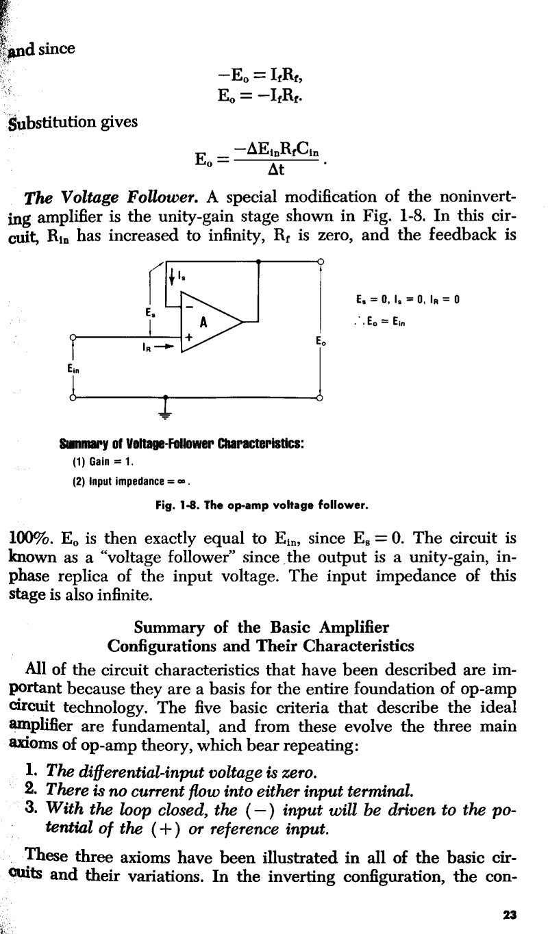

Well, Jan. If you were integrating over infinite time, then you would be right, but in synthesizers we integrate over finite time. So, maybe it is technically impossible to integrate over infinite time, but over finite time we can.
The most common place an integrator is used in an analog synthesizer is in the envelope generators. Integrators provide the ramps up and down. When we reduce the time constant of the integrator - the time over which we integrate - then we change the attack and decay times.
Integrators in analog synths are built with an operational amplifier and with a capacitor in the feedback loop. These are called integrators in electrical engineering parlance, I assure you, and they are in effect running averages over some finite time.
Sometimes in engineering, the pure math is bent a little in order to make wonderful things practical.

? ... integration of an impulse over any finite or infinite period time containing the duration of the impulse will yield the area under the impulse as the result of that integration.
To not be able to integrate over infinite time is not a problem, as long as it is assumed that the signal to integrate was zero before the integration started the results will be correct. If it was not zero during that time a constant can be added or subtracted to compensate, in practice though it is reasonable to consider the signals to have been zero before the machine was switched on.
That we are dealing here with a time disctrete system is not really important, there will only be a very small error in the integration as long as the signals are reasonably smooth over the period of the system clock, which to me seems to be safe to assume.
Now the funny thing is that, although you seem not to agree with me, you are presenting examples using perfect opamps (En=0, In=0), which will in fact yield perfect integrators and differentiators (when driven with a voltage source). So I don't quite see your point here.
Example, for the integrator :
The document states that :
delta-Eo = -Ein / RC
which implies that when
Ein = 0
it will be the case that
delta-Eo = 0
which means that Eo will not change.
And so, when an impulse is fed into this hypothetical circuit the output will make a DC jump and not return to zero.
I said hypothetical, as I'm well aware that the (En=0, In=0) criterium is an approximation and that the circuits in reality will be leaky.
My point was that its possible on the G2 to come up with something better than that. Please prove me to be wrong there.
There is a point in trying to do better, with good integrators it is possible to make state variable filters which is not so easy to do with low pass filters (I tried that on the NM 'Classic').
Considering differentiation on a time discrete system we seem to agree. That is, I see no light between your statement and mine (I only added the notion that delta-X is a constant, and I assume you will agree with that).
