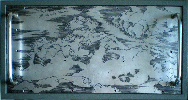

I am drilling the panel. It has been etched by my friend who is into engraving/printing. He did a panel with clouds for my Two Phasers case.
Before wiring and connecting the boards, I am thinking about using Tau's CV THRU as a possible Krautrock CV IN
Nevertheless, you *should* be able to feed a CV into the *Tip* of a TRS plug into the AMOUNT jack, with Sleeve and Ring both *unconnected*, and a connection of the Phaser's signal GND to the GND of the CV-producing device. The interesting CV range will be about 0V ... +10V in that case.

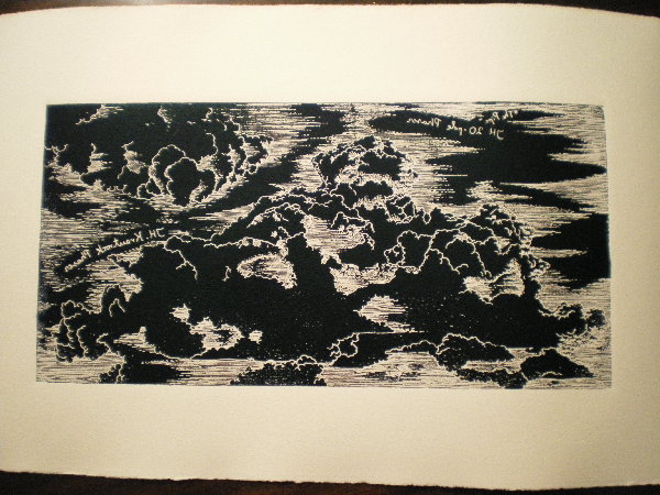

This is a printing of the panel. Words are reversed because panel was not etched to be printed, but to be a panel for my Phasers Case.

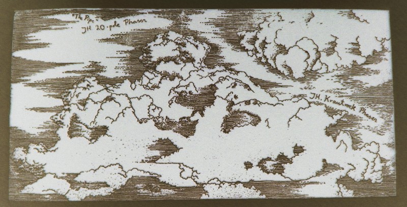

PostPosted: Thu Jul 10, 2008 2:34 pm    Post subject: Reply with quote  Mark this post and the followings unread
That's a pretty unique panel, I edited the image a bit to get a better idea of what it might look like as a panel and thought it would be a bit like below ...

PostPosted: Thu Jul 10, 2008 2:59 pm    Post subject: Reply with quote  Mark this post and the followings unread
That's how it looks
When it's finished I'll post pictures on the "Photos of what you've built..."
That's the panel in its box, with handles and first holes.

That is GORGEOUS!
can't wait to see it with knobs on.
I wish I had access to a printshop.
The process of such mediums is alot of fun when you get rolling.

Absolutely cool frontpanel!
*Please* put a picture of this in my "Pictures" thread as well, once this is finished!

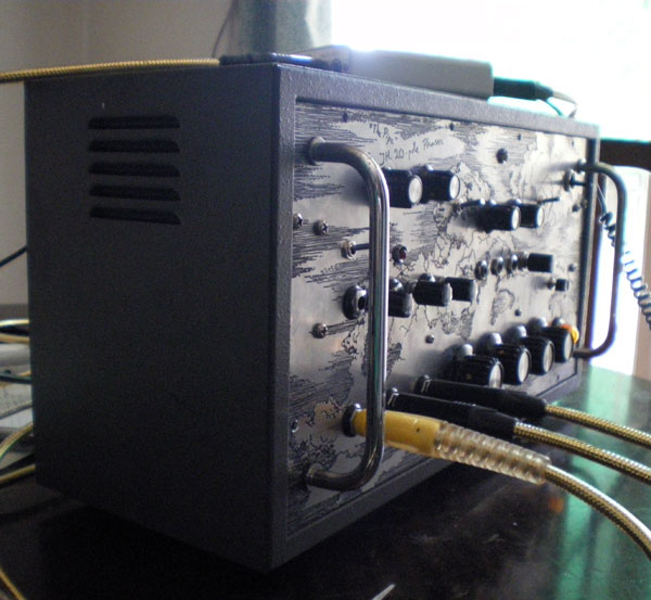

Anyway, I posted a picture of the finished case on the "Photos of what you've built..." thread (http://www.electro-music.com/forum/post-195588.html#195588).

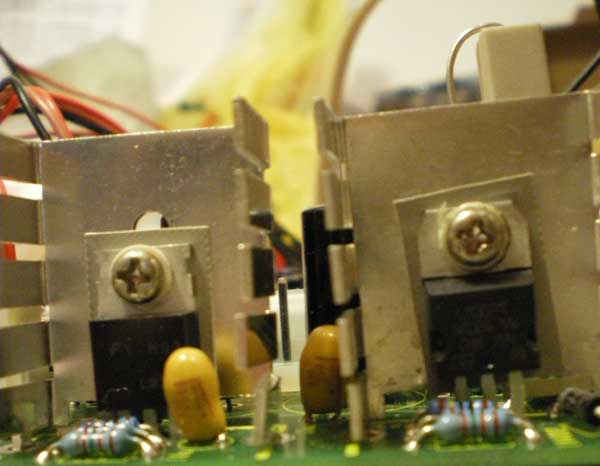

Also, I have noticed that the regulator's heatsinks get quite hot, in particular LM317's. Not that I got hurt when I touched it, but I don't know if I should find bigger ones before trying to feed the Tau board from the Krautrock's.

Are they too small?
 Filesize:  23.28 KB
 Viewed:  15022 Time(s)

I finally connected the 20-pole Phaser.
My first PCB to work perfect at first powering up!
Maybe my building skills are improving from project to project.
It is powered from the Krautrock Phaser.
It sounds great!
Now I will take it to my studio next to my modular to try CV In, CV Out and V/Oct In.
