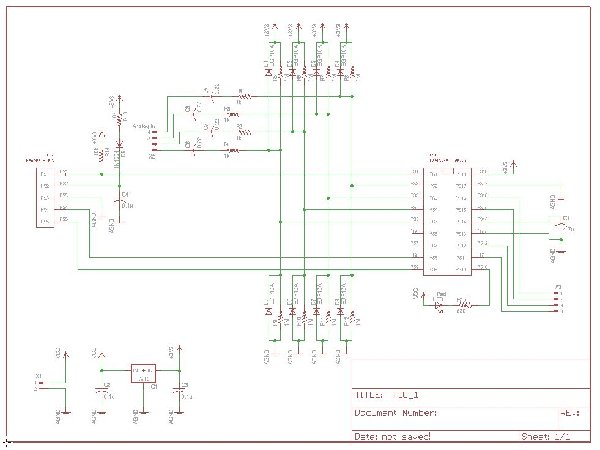

Joined: Oct 13, 2007 Posts: 6221 Location: near Austin, Tx, USA
Audio files: 267
Joined: Apr 03, 2004 Posts: 24476 Location: The Netherlands, Enschede
Posted: Sun Oct 05, 2008 6:05 pm Post subject:
Can't really read the diagram's processor pin functions, some thoughts anyway ...
- why AC coupling, this would be interesting for DC/control rate processing maybe even more than for audio rate.
- DC / control rate processing would like a good Vref probably
- Audio rate processing would need a good time base, but you use no XTAL.
- maybe a port would be nice to be able to do run time parameter changes, but it would complicate the software of course. _________________ Jan
Audio files: 267
Posted: Sun Oct 05, 2008 6:40 pm Post subject:
Blue Hell wrote: | Can't really read the diagram's processor pin functions, some thoughts anyway ...
- maybe a port would be nice to be able to do run time parameter changes, but it would complicate the software of course. |
Jan, you're brilliant! Why AC couple things at all? I will get rid of all the caps.
I can add Vref, would lose two inputs for that though.
Those two unused pins are the clk pins, so I'll add an xtal.
A digital port will happen later, for now it just wants to be a sinosc or a multiplier or whatever. _________________ "Let's make noise for peace." - Kijjaz |
