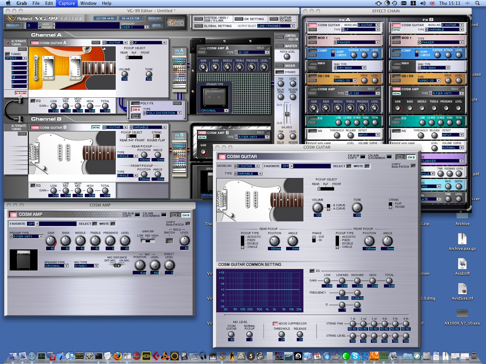

Well the audio is dependent on the type of Hex Pickup you have on the guitar.
You do not get the same sound as you would from a normal guitar pickup, for a peizo hex pickup on an electric you get a pretty thin sound.
Devices like the VG99 take the hex pickup audio and then allow you to emulate other pickups/guitars, the VG99 for instance can turn these signals into:
Electric
Passive Strat
Active Strat
Telecaster
Les Paul
Les Paul with p-90
Lips
Rickenbacker
335
L4
Acoustic
MA28
TRP-O
GB45
GB Small
GLD40
Nylon
Sitar
Banjo
Resonator
Bass
Fender Jazz
Fender Precision
Synth
11 different synth types
You can have two emulations running, each with its own FX chain and amps, you can also change tunings, emulate 12 strings etc.
You can also set up your own guitar, in the image yiou can see I have set one up with two single coils out of phase with each other.
So with the Fanout box I can record the 6 channels of audio along with the audio from the VG99 (say a clean strat), a bit latter I may say I wonder what this will sound like using a LP rather than a strat and then send the 6 audio tracks to the VG99 and setup a dirty LP instead.
Powerfull stuff.
Andy
