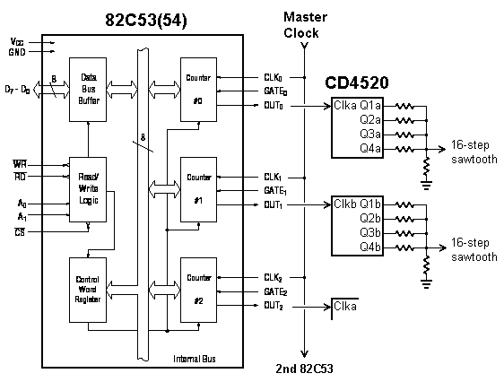

PostPosted: Sun Jan 11, 2009 8:19 am    Post subject: Reply with quote  Mark this post and the followings unread
Beating a dead horse?
Would this be suitable?
http://www.datasheet4u.com/html/C/D/4/CD4059_TexasInstruments.pdf.html
Or, with a microcontroller, this?
http://www.measurementcomputing.com/PDFmanuals/82c54.pdf
The 82C53/54 counters are 16 bit, so they could provide octave selection as well as note division. They also have more modes than are needed for generating square waves, so a cpld "clone" could be much simpler. (Maybe.)
Two 82C53's and three CD4520's would give 6-note polyphony (or paraphony), and only 6 simple VCAs would be needed instead of X# of diodes per key.
I'm proposing a compromise between doing it all in hardware or all in software, which is beyond some people. (This one, fr'instance.)
