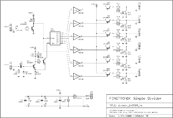

hi all,
i made a very simple divider these days, using two discrete schmitt triggers, a 4024 and a 4069. by far not that versatile like ken's great Master Divider.
it can be clocked by any signal that is crossing approx. 1.5V. the reset will need a trigger, pulse or square wave though.
it provides the original clock and the divisioons /2, /4, /8, /16 and /32.
i could do a PCB run for these. boards are small and will be cheap. but first i will manufacture a prototype for me anyways, in order to have a regular module.
[EDIT: schematic removed. for updated schematic see below]
comments are appreciated.

PostPosted: Thu Jan 22, 2009 1:46 pm    Post subject: Reply with quote  Mark this post and the followings unread
proto PCB arrived today. look nice. BUT: i breadboardrd the circuit using 2n3904 NPNs. for the PCB i used CA3046 or CA3086. they don't work (i tried two different brands).
then i inserted 2N3904 into the IC sockets (what a mess Very Happy ) and voila, it works.
what could be the cause that the CA3046 won't work?
at the base of the first NPNs of the discrete schmitt triggers i see about 11.5V when using the CA3046 with no clock applied. using 2n3904 i measure 1.15V (which far better Wink ).
what is wrong with using CA3046?
BTW the circuitry of the clock input is wrong. one transistor too much. why? just because the counter counts at each falling edge of the clock Rolling Eyes one has to look at the datasheets of the different CMOS very closely. somehow on it felt all well on the breadboard Very Happy
[EDIT: schematic removed. see updated schematic below]
Adam-V
Joined: Jan 29, 2007
Posts: 300
Location: Australia
PostPosted: Thu Jan 22, 2009 3:12 pm    Post subject: Reply with quote  Mark this post and the followings unread
Hi Matthias,
The data sheet for the CA3046 states:
"The collector of each transistor of the CA3046 is isolated from the substrate by an integral diode. The substrate(Terminal 13) must be connected to the most negative point in the external circuit to maintain isolation between transistors and to provide for normal transistor action"
Now I suspect that, since you have used Q5 as a pull-up on one of the outputs, this is causing some issues with the isolation as the substrate is not at the negative most point which for this circuit would be 0V. Try bending Pin 14 out so it's no longer connected to +15V and then ground pin 13 to see if the remainder of the circuit functions correctly. If so, you might need to re work the output stage so that the transistors pull down to ground rather than up to Vcc.
Adam-V

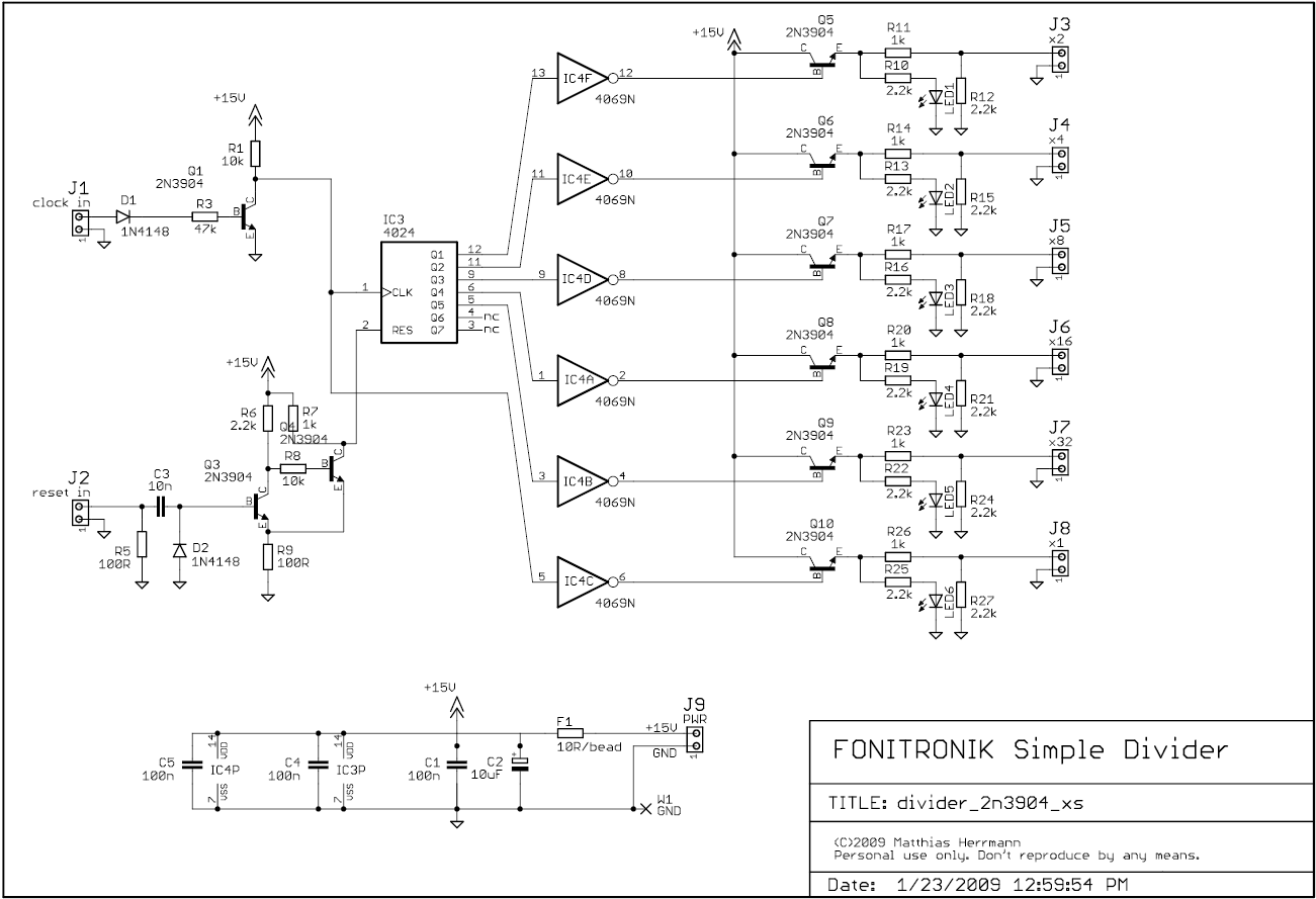

PostPosted: Fri Jan 23, 2009 6:57 am    Post subject: Reply with quote  Mark this post and the followings unread
thanks for the hint, adam-v. i will have to think about it.
however, here is a refined schematic of the circuit using 2n3904 transistors, whoever cares.
 Filesize:  62.49 KB
 Viewed:  4730 Time(s)
PostPosted: Sun Feb 08, 2009 4:17 pm    Post subject: Reply with quote  Mark this post and the followings unread
below you see pictures of my finished divider module.
as you will recognize, i used inverters. why? this way all divisions are "ON" when reset pulse is received.
i never have had a divider before, and for me it has been just natural to have it this way. i looked about it as it would be a sequencer: i.e. the Klee2 reloads on the pulse and is at the "one" of the pattern when reload (reset) pulse is received. i would think a divider should operate the same way, when it gets controlled by another divider or sequencer or whatever. am i wrong here? woult it be better to have all divisions "OFF" when reset is received? then the reset pulse would have to be the last step in a sequence!?
any opinion would be appreciated...

PostPosted: Sun Feb 08, 2009 9:29 pm    Post subject: Reply with quote  Mark this post and the followings unread
Nice work Matthias. I think your logic is correct and makes for a musically useful divider, at least as far as clocks are concerned, as it places the positive edges of the divided outputs on the 1, 2, 4, 8 etc beats.
I reckon you could have achieved the same result by using a down counter without inverting the outputs.
Adam-V

cthulu
Joined: Feb 07, 2009
Posts: 56
Location: Göteborg, Sweden
PostPosted: Mon Feb 09, 2009 2:20 am    Post subject: Reply with quote  Mark this post and the followings unread
Beautiful job!
To me the step from a working schematic to a final module is a huge one. Sad PCB and frontplate working
together... yuck! I'll look around in here for some clues though Smile
I think the trannies on the output are a bit redundant. Since you have the inverters I think you could just let
the divider sink the LED's and eventually just increase the output resistors. if Q1 can't pull the clock pin
low and sink an LED at the same time yould have to buffer it ( keep that one as it is... ). I don't know about inverting
the outputs or not, I just divide and conquer and haven't actually thought about it until I read this post...
Oskar
PostPosted: Mon Feb 09, 2009 3:06 am    Post subject: Reply with quote  Mark this post and the followings unread
Shocked she blinded me with science...
it could have been be so easy? however, now as you pointed it out i get aware that these transistors are just relicts from the first breadboarding without inverters Laughing

PostPosted: Mon Feb 09, 2009 1:31 pm    Post subject: Reply with quote  Mark this post and the followings unread
very nice work Matthias !
i have sometimes troubles with my doepfer divider A-160 +161 when i feed lots of destinations and when i like to run up to high audiospeeds.
maybe its not stuppid to have the transistors. ( but i don't understand any electronics Embarassed )
Adam-V
Posts: 300
Location: Australia
PostPosted: Mon Feb 09, 2009 2:52 pm    Post subject: Reply with quote  Mark this post and the followings unread
I agree, the transistor drivers on the outputs are a good thing.
Adam-V
PostPosted: Mon Feb 09, 2009 3:19 pm    Post subject: Reply with quote  Mark this post and the followings unread
i couldn't find any max current rating for the outputs on the datasheet. maybe i am just dumb...
