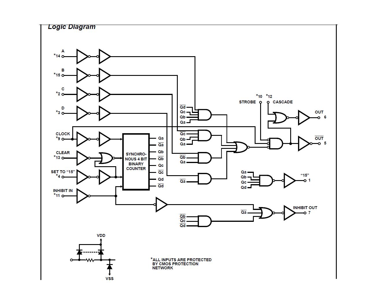

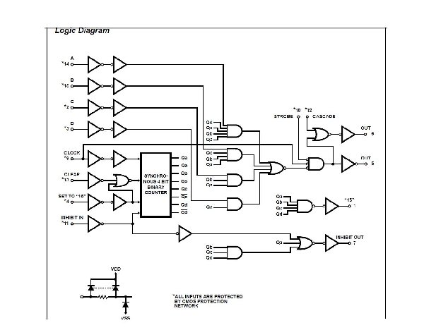

PostPosted: Tue Jun 30, 2009 12:59 am    Post subject: Reply with quote  Mark this post and the followings unread
Ahh I remember this thread now. The datasheet that revealed the extent of my ignorance. The part that I don't get is the relation between (what I presume to be) the outputs from the counter and the inputs to the 5 and gates immediately to the right of it. What's the deal with the bar over some of the variable names? Inversion?
http://electro-music.com/forum/phpbb-files/4089_202.jpg
(page "1070" from the intersil sheet)
I believe Qa with a bar over it is "Not Qa"
