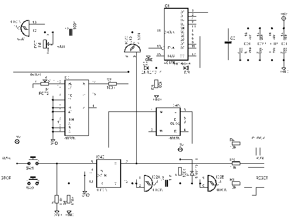

PostPosted: Sat Feb 14, 2009 1:25 am    Post subject: Reply with quote  Mark this post and the followings unread
You could create a master clock unit with swing without a microprocessor and the core of it could look something
like this. The 4053 is switched each 6th clock pulse routing the swing pot differently. Sorry, I don't know any
simpler ways to do it... and this doesn't include the reset or run signals.

PostPosted: Sat Feb 14, 2009 4:48 pm    Post subject: Reply with quote  Mark this post and the followings unread
that's a really great idea. what about if it took the clock and reset/start/stop info from an external din sync source?

PostPosted: Sat Feb 14, 2009 5:41 pm    Post subject: Reply with quote  Mark this post and the followings unread
You could make that work. I don't have any DIN machines and I don't remember how it works. I think
the other two signals are really easy to realise and we have a leftover 4013 half for S/R action. Two NAND
gates are unused too. I'd need to read up on it but you can take it from here if you like. Hm... you could probably
make some really sick grooves if you put in a switch to make the 4017 reset from other counts than 6...

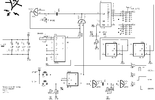

PostPosted: Sat Feb 14, 2009 6:06 pm    Post subject: Reply with quote  Mark this post and the followings unread
Something like this... When you set the 4013 RUN goes and stays high and there is a reset pulse for a couple
of ms. You can stop the LFO by tying one of the legs of it's gates to the RUN signal. That way it would behave
in a more consistent manner. You can also take the clock from the other gate if this one don't work.

PostPosted: Sat Feb 14, 2009 8:21 pm    Post subject: Reply with quote  Mark this post and the followings unread
Right... now I'm sleepless.
Doepfer on sync.
http://www.doepfer.de/faq/gen_faq.htm#Sync
DIn sync wiki.
http://en.wikipedia.org/wiki/DIN_sync
Apparently the reset signal isn't needed but now it's there anyway.
Now it could be ready for breadborad.
The clock is held high during stop so this way it will give the reset, if needed, time to finnish. Also the 4017
is resetted during stop so it will start from zero every time and you will get the swing action on the same clock
beats every time.
I don't know about the resistors on the outputs. There should be some protection anyway, if this won't work
then some buffers would be needed.
Happy bugghunting!

PostPosted: Sun Feb 15, 2009 6:37 am    Post subject: Reply with quote  Mark this post and the followings unread
Still on the case.
I added a mode switch. In position 4 it's the same swing function as earlier. The other positions I don't really
know, better to breadboard to find out what pins of the 4017 to tap rather than to try to visualise the steps.
I also changed the reset section to trig as the graphic shows but I don't really know if the reset is supposed
to be high and go low or vice versa. Someone else please? I couldn't find any information about it. The only
thing is a vague memory of someone, perhaps Craig Anderton, mentioning that there is this thing that needs
to be pulled low before you hit run and that it could be just a simple momentary switch... I don't even know if
that was a roland sync thingo!?? Confused
Anyway the way I intend it to operate is.
When you hit start:
1. run goes high
2. reset pulse
3. first clock pulse
When you hit stop:
1. run goes low, 4017 resets to 0 and 4017 clock input is put and held high. This way insures that the clock
needs to first go low before the 4017 is clocked so the reset is given time to do it's thing.
I just remembered that a friend of mine got an 808 and he is getting one of these soon if it turns out to work
as it should.
ps. If someone knows of circuits to achieve swing please show me to it! Smile
