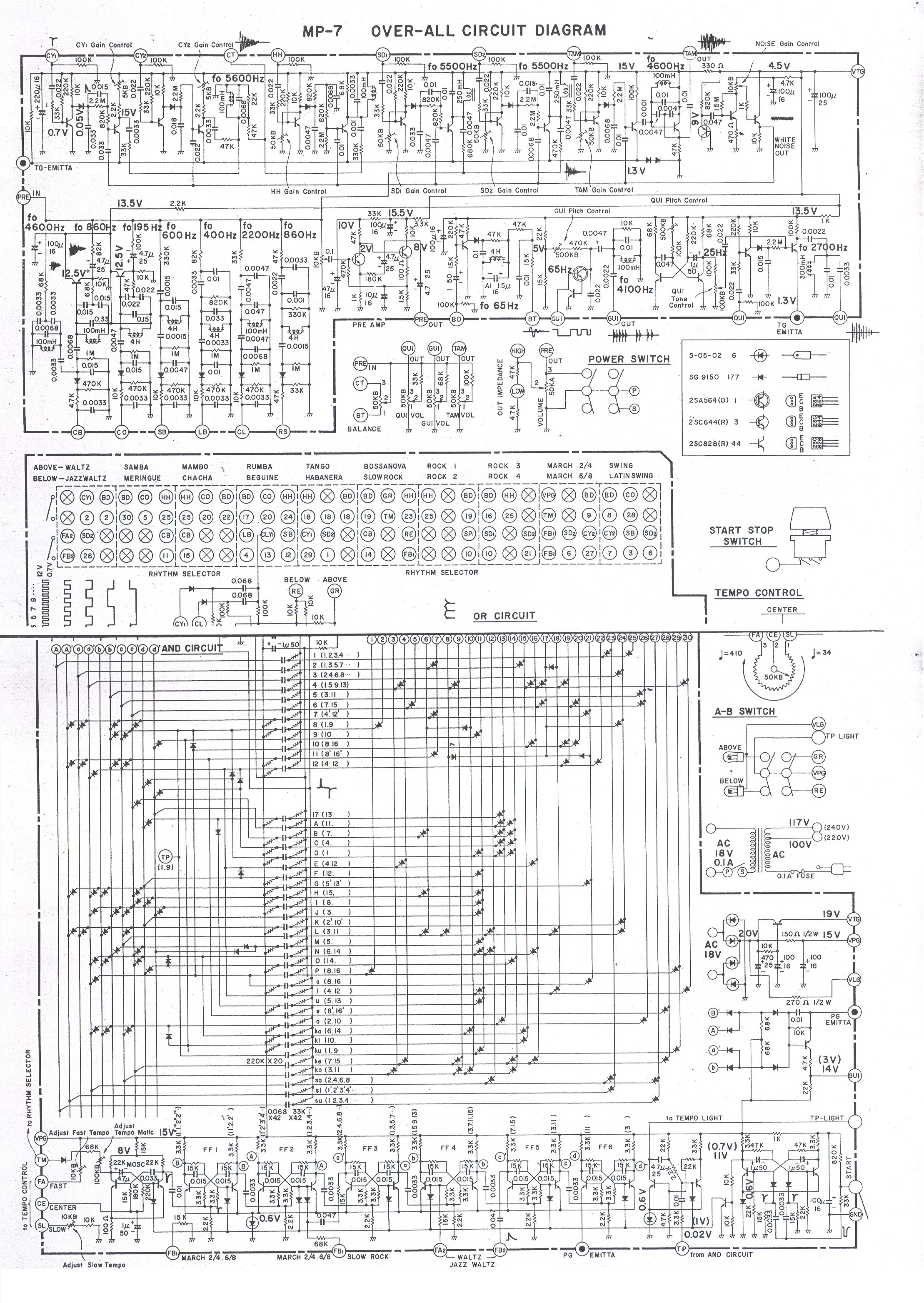

I'd like to build the percussion module out of this diagram. However, there is an NPN in the schematic with two circles around it. But in the legend (key) the transistor with two circles on is depicted as a PNP. I'm a bit confused which transistors are used and where.
I've not yet checked availability of the components at this stage, or if there are compatibles.
the full schematic can be found here:
http://www.jeanmicheljarre.pl/radek/samples/minipops.jpg

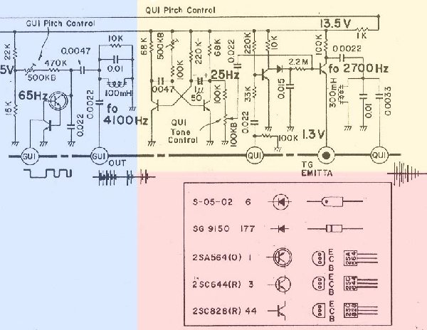

If I'm reading my international transistor equivalents guide correctly, the following should be:
2SA564 = BC258
2SC644 = BC182
2SC828 = BC167
DOUBLE CHECK THE ABOVE!
I still have no idea what the transistor next to the bold '65Hz' text is though. it could either be 2SA564 (going by the two surrounding rings) or 2SC644 (going by the polarity).
Help would be a virtue right now Wink

I also got that sch for MP7 but unfortunately it seems to be incomplete: a part is missing from the central region (rhythm section).
@esnabez: could you please send (or post) the entire schematics of the univox? thanks,
Btw, I think replacements BC183B and BC237B are OK.

I would imagine the Guira uses Gate rather than Trigger, since the inbuilt sequences have different length notes (almost like a synthesizer sound). The Quidjada & Tambourine would work triggered (one-shot).
Correct me if I'm wrong, but if you look at the Korg diagram that I posted in the initial thread (you'll need to cross reference between the korg & univox diagrams for component numbers). It appears it is in fact a Gate signal input which goes to the collector of Q21 base of Q20. This also is also depicted with a square 'pulse' wave (on/off) symbol just underneath where it says (GUI).
It would be great to have an up to date 'clone' of the gui/qui/tamb, with the hard to find inductors substituted. Anyone know what would work as good substitutes?

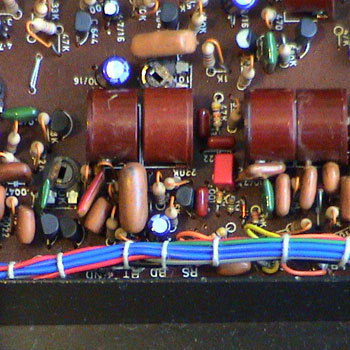

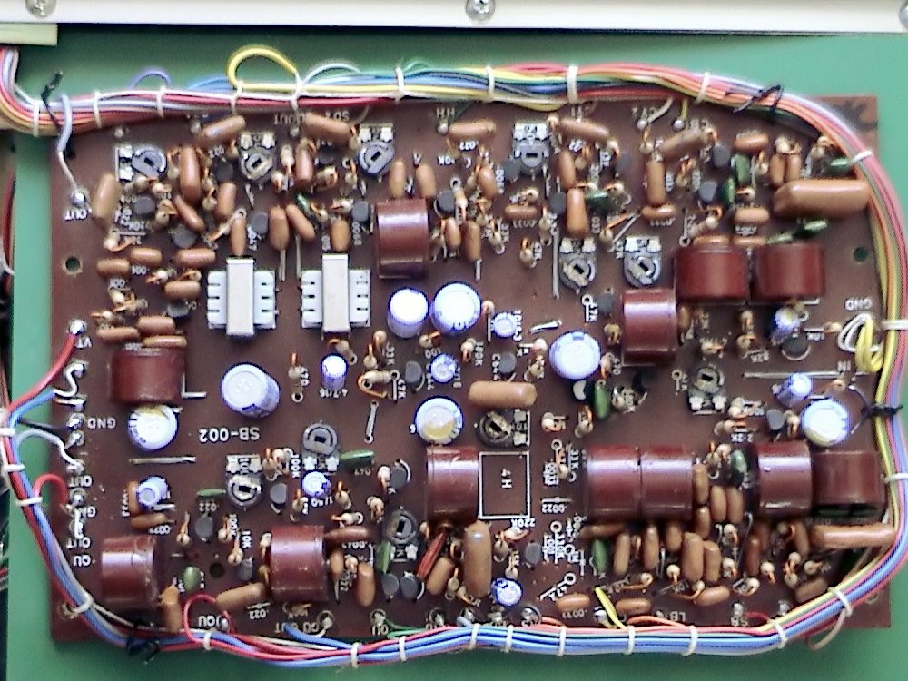

I had an additional reason for being interested in this. I just bought the Univox SR-95. Everywhere says this is a 're-badged' Korg Minipops but I didn't see anyone mention that the rimshot sound is missing and the cowbell substituted: ta ta ta CLONK ta ta, ta ta ta CLONK ta ta... Rolling Eyes. However, looking at the sound generator board you can see near the bottom centre a missing inductor (4H Shocked) with several other components around it missing. The pulse trigger wire below it is marked RS (rimshot) and when you put 5 volts across it it plays the cowbell sound. There is a CB pulse connector at the top of the board that you can see here (yellow wire) which plays the same sound. So, I reckon that adding the missing components and disconnecting the rimshot trigger to the cowbell, then the rimshot sound could be added.
Thought I'd share that, hope it isn't too off topic.
SR-95 voice generator board
 Filesize:  189.62 KB
 Viewed:  883 Time(s)

For those reading this who missed my previous posts, I'm adding the missing rimshot sound to the Univox SR95 that the Korg MP7 has. On the SR95 it is substituted by the cowbell sound. However, the tone generator circuit board is the same with some components missing.
'ickystay' very kindly sent me the required inductor that are hard to find. I've now soldered all the components in place. I also replaced all electrolytic capacitors, thought it was probably not necessary.
As you can see the inductor is the same as the originals.
I wasn't sure whether it had worked at first but that's because the rimshot is drowned out by the cowbell, as expected, but it is there Smile.
I now need to find out where they are coupled and I'm sure this is on the pulse generator board. I really need the layout of the MP7 board to look at now in order to determine where it differs from mine. I expect there's a jumper somewhere. I can't find the MP7 schematic at musicparts.com only the SR95 which I've already bought. Can anyone help with this?
Many thanks.

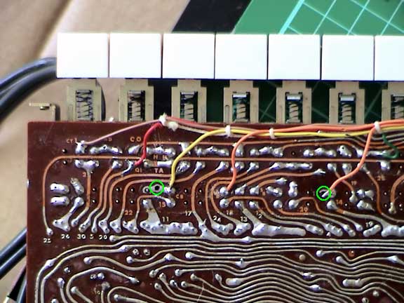

There are 2 through-board jumpers on the pulse generator board that connect the cowbell and rimshot together, one of these needs removing. If you're careful you should be able to pull one of them out with tweezers while melting the solder. I, on the other hand, pushed both of them into the board causing problems. I thought they were connected with a wire jumper.
The only way to fix this was to buy myself a solder sucker and remove the rhythm selection button 'cage' completely to get to the other side of the board.
It now works fine. I can post a recording if anyone wants to hear.

Buttons removed
 Filesize:  26.2 KB
 Viewed:  39921 Time(s)
Where the cowbell and rimshot are connected
 Filesize:  60.3 KB
Better to pull the link out from one of these two points on the other side of the board
 Filesize:  48.64 KB
