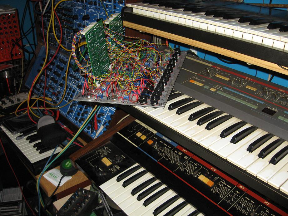

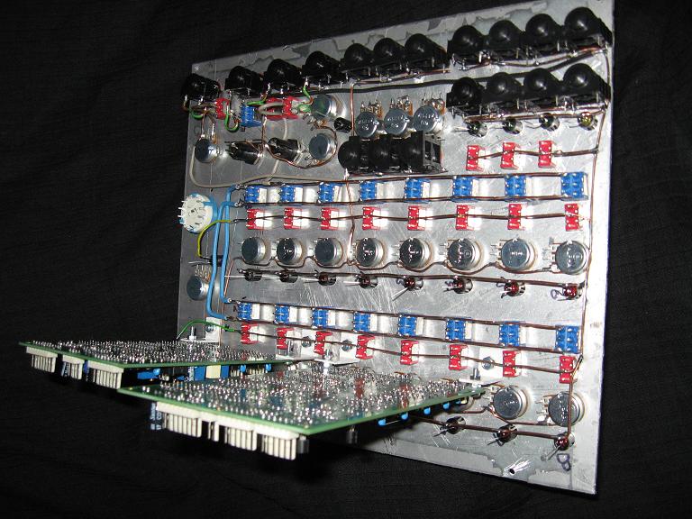

PostPosted: Sat Jan 23, 2010 4:52 am    Post subject: Klee is breathing and alive
Subject description: Another happy Klee builder

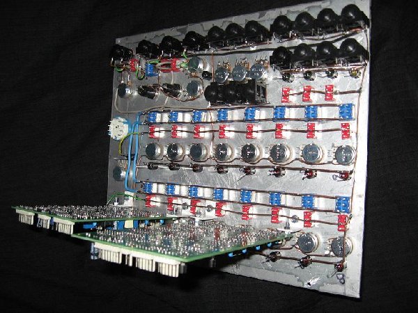

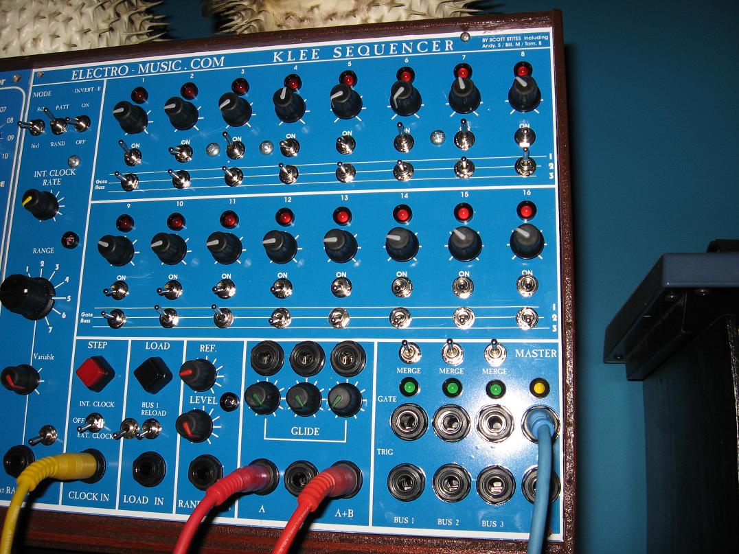

It works , hooray (after sorting some silly mistakes on my part).
The pattern switches i initially thought made an "on" when switched to ground but it's really an open circuit is "on" & ground = "off".
All a good learning proccess Smile .
A very satisfying project from start to finish, very happy customer !.
Here are some pics of the construction......

EdisonRex
Joined: Mar 07, 2007
Posts: 4579
Audio files: 172
PostPosted: Sat Jan 23, 2010 4:59 am    Post subject: Reply with quote  Mark this post and the followings unread
You never showed a picture of the panel wiring completed LOL.
It's supposed to look like a plate of spaghetti.
Looking forward to hearing what you do with it!

PostPosted: Sat Jan 23, 2010 5:04 am    Post subject: Reply with quote  Mark this post and the followings unread
Congrats!
Looks beautiful Smile Neat wiring there.

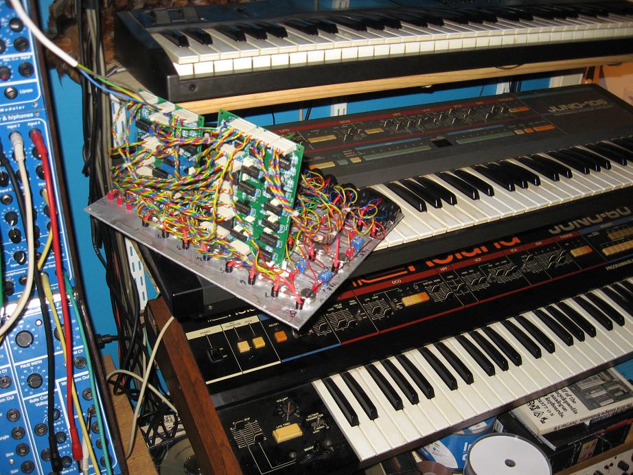

Posts: 1217
Audio files: 159
PostPosted: Sat Jan 23, 2010 5:07 am    Post subject: Reply with quote  Mark this post and the followings unread
spaghetti on request ha ha .
Thanks Paul Very Happy
 Filesize:  163.87 KB
 Viewed:  681 Time(s)

Posts: 1217
Audio files: 159
PostPosted: Sat Jan 23, 2010 5:17 am    Post subject: Reply with quote  Mark this post and the followings unread
wmonk wrote:
Congrats!
Thanks Thomas , until you see the molex wiring , he he.

Posts: 1217
Audio files: 159
PostPosted: Sat Jan 23, 2010 5:58 am    Post subject: Reply with quote  Mark this post and the followings unread

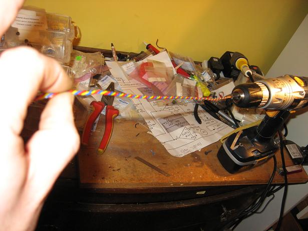

wmonk wrote:
Heh! Still neat there! Way cool man.
What was the wiring time? Rolling Eyes
Hope to hear some samples soon Smile
About a week of evenings & a weekend to strip / crimp / solder the looms together .
Used a crodless drill to twist the wire looms together then snip off length needed.

Skrog Productions wrote:
Klee hooked up to 3 MFOS VCO's / 3 VCF's / 3 VCA's . externally clocked from a MFOS 16 step sequencer. with a CGS psycho lfo patched to the external range input & MFOS S&H patched to load in & MFOS Grainy noise to the random in switching the external ins on and off during the sequence No FX (dry as a pharaohs sandal) .
this mp3 just a patch up & try some switches as it runs .
You rock! Very Happy
Seems like a lot of work, 5 evenings and a weekend. But the result is great Smile
So you twisted the wires first, and then soldered the crimps to it? Did you use stranded wire?

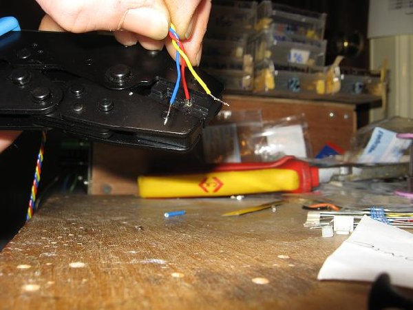

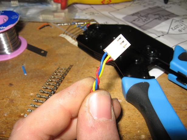

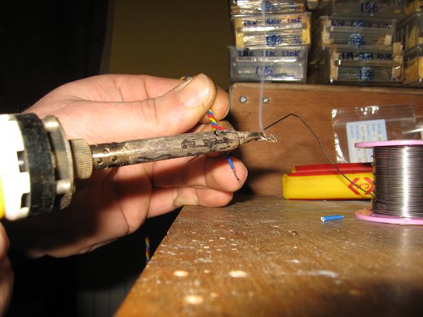

PostPosted: Sat Jan 23, 2010 7:24 am    Post subject: Reply with quote  Mark this post and the followings unread
wmonk wrote:
[quote=
Yes , stranded wire , should have used 16/0.2 wire for the crimps but i had a few drums of 7/0.2 to use up , tinning them first got a good hold for the crimp then tin after crimping to secure them....
 Filesize:  50.65 KB
 Viewed:  470 Time(s)
 Filesize:  44.61 KB
 Viewed:  459 Time(s)
 Filesize:  51.37 KB
 Viewed:  485 Time(s)
 Filesize:  48.47 KB
 Viewed:  454 Time(s)
 Filesize:  49.11 KB
 Viewed:  469 Time(s)

PostPosted: Sat Jan 23, 2010 7:31 am    Post subject: Reply with quote  Mark this post and the followings unread
Nice Dave! Good technique there. I don't use a crimp tool now. Do you recommend to use one? Are they expensive?
Weblog!
Posts: 1217
Audio files: 159
PostPosted: Sat Jan 23, 2010 7:35 am    Post subject: Reply with quote  Mark this post and the followings unread
I got my crimper from Rapid uk , i think it was about £20.00, it's done well to do this & the complete ASM-2 crimping as well and you can change the crimp teeth as well .
Dave.

PostPosted: Tue Jan 26, 2010 1:09 pm    Post subject: Excellent! Reply with quote  Mark this post and the followings unread
Congratulations on your completed Klee Sequencer. The demo was great, too!
I am currently designing my Klee panel... I really like your panel so I hope you don't mind if I borrow the design.
In order to fit my Aries synth, the panel must be 9" tall... I anticipate a 9 x 12 panel.
