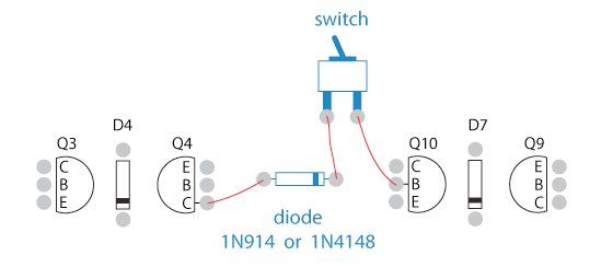

hello all,
I want to do this mod as well and just want to make sure I understand the instructions correctly before I pick up that solder iron Smile ..
Did I make the right connections?
Especially those connections to the two transistors Q4 and Q10..
I just guessed that is the right EBC order?
thanks..

PostPosted: Tue May 11, 2010 7:31 am    Post subject: Reply with quote  Mark this post and the followings unread
The switch and the diode have to be in series, on your pic it looks like the switch shortcuts the diode, which is not the way to do it...
So, a wire goes from one transistor to the diode, then to one pole of the switch, then the other pole of the switch goes with a wire to the other transistor. Just keep in mind that when there is the diode the second oscillator hardsyncs. So, to not let it sync the switch should interrupt the diode connection by interrupting one of the wires that go to the diode.
I don't have a MS20 anymore, so regrettably I cannot post a pic of the internals with the mod.

PostPosted: Tue May 11, 2010 9:14 am    Post subject: Reply with quote  Mark this post and the followings unread
thanks for the reply!
so in short: I just cut the signal after the diode.. thanks..
just two more questions..
- is there a difference in using either 1N914 or 1N4148: can I use both?
- is the EBC order (or when rotated 180 degrees: CBE) universal?
As I said I'm not really into electronics but I looked at transistor specs and they all seem to have the order as drawn in the image..
So it's safe to say my assumptions are right?
