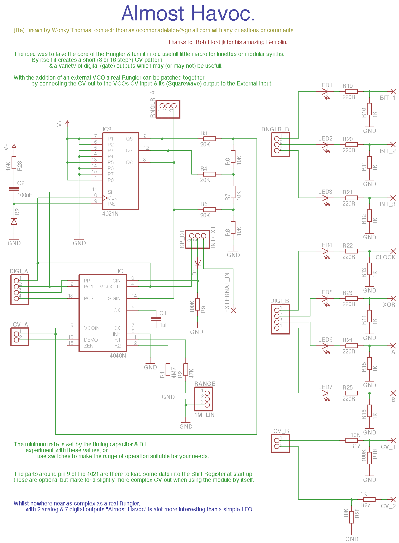

DGTom wrote:
Nice & Crunchy with those extra XORs processing Cool
Some interesting stuff; the good thing about the 4046 is its super easy to tap off a nice saw wave as well which is good to mix in with the squares from time to time. I used a 4M7 for the static timing resistor which gives a really broad range with a 1M pot.
How do you get a sawtooth wave from the 4046? Do you have schematic?
Thanks

adamon, google up the service manual / schematics for the Roland TR-808; its like a lesson in miniaturisation, or, how to squeeze a synth voice into the smallest part count possible. The envelopes for the drums are more or less resistor / capacitors driven by transistors, the VCAs are transistors etc.
Check out what U2 & U4 are doing in this schem;
http://www.musicsynthesizer.com/WoggleBug/WOGGLSCH.GIF
Basically you tap into the timing capacitor with a pair of diodes & buffer the output with a voltage follower. I should say "saw-tooth-ish" its not perfect, but, mixed in with the squarewave it does add some nice flavour.
Here is a simplified version of what I'm working on, should work with lunettas. My version buffers the R/2R & has a comparator on the External Input so that its compatible with my analog modular.
Hope the drawing makes sense. I use headers alot, keeps the drawing easier for me to follow & its how I hook stuff up; my stripboard builds use very little wire these days, I just solder the board to the back of the pots / banana jacks.
About the audio clip; recorded straight from the breadboard again, but, keep in mind I'm using the "Rungler-esque" set-up as a set of control voltages, the sound is a SVF, the output of the Clock is ringing the filter, the VCO is being used, but, only to produce a hi-freq. pulse train to be loaded into the 4021 data input.
I've noticed that the higher the frequency of the VCO the more 'random' the networks output. It'd be interesting to add a divider, or even a Melody Generator, to the 2 x 4046 + 4021 CMOS Benjolin. Have the VCO run really fast, clock the 4017 & use the rungler bits to control the 4051.

Very nice and mellow sound. Thank you for the advice with the diodes, I will try this later.

I got frustrated trying to get a decent triangle wave & frequency range out of the 4046... so at 1am I took everything off the breadboard & started over!
Much happier with the results, a little tweaking of the feedback / filter section is needed, but...
http://dl.dropbox.com/u/252415/Predator_Drone_Pt_2.mp3
as you can hear... it goes from standard PWM type buzzing to OTT feedback mayhem just by turning the feedback / damping pot. You can turn the feedback all the way off for the pure PWM sound or turn the VCOs freq all the way down & have pure waves of feedback noise being controlled by the Rungler. The little "coda" (quick fade to silence & back up for a moment, then silence) at the end is essentially the same pot movement as the first change at the start, great fun!!

I am building a semi-modular CMOS synth and want to include a rungler-ish circuit in it.
I thought of having the CLK as an input from anywhere on the synth (40106 oscs, 4040 dividers, 4093/4070 gates, 4046 PLLs and 4049 squared signals)
and then have the data from a triangle wave on 4046 and the R2R/4021 output feed back into the 4046. should just be a simple pseudo-random clock source for patching further around into the other logic ICs.
still a little in doubt about how I should approach this but I think I will hi-jack this thread and post updates on my progress. the main puzzling thing for me atm is how the OP-amp/XOR gates gets integrated into this whole mess...
