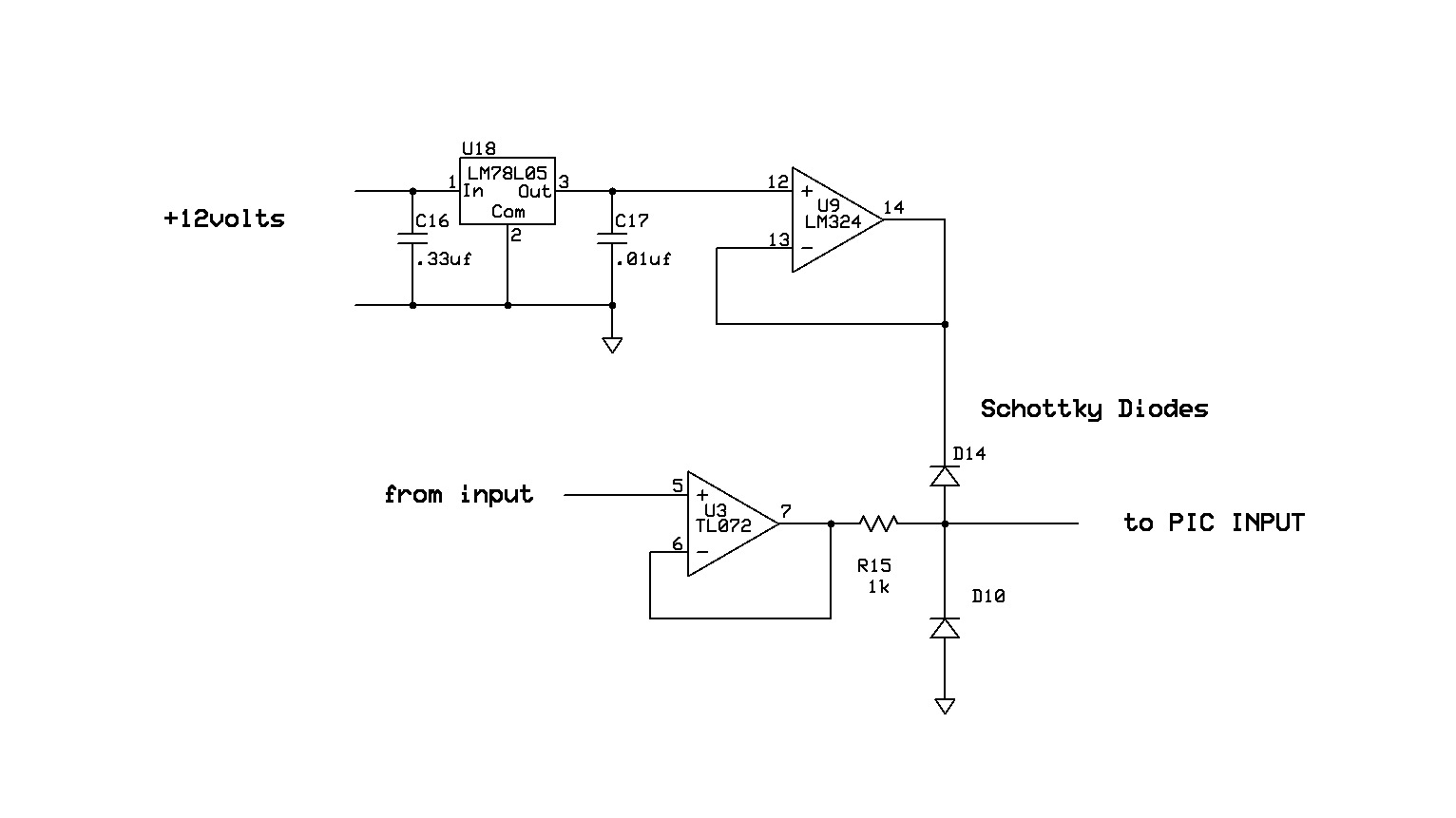

FYI here is how I'm handling the input overvoltage problem in a PIC quantizer I'm building.
The Op amp U3 will go up to 5 volts and at that point it will be clamped to the output of U9 which is being fed by a 5 volt voltage regulator. You could use the 5 volt supply, but you might get some digital noise flowing into the PIC input.
With Scottky diodes the voltage going into the pic should not go over 5.3 volts and the input should be very linear up to 5 volts.

glitched
Joined: Mar 25, 2006
Posts: 80
Location: phila., pa USA
PostPosted: Fri Dec 10, 2010 9:12 pm    Post subject: Reply with quote  Mark this post and the followings unread
Would we use the existing op-amp (LM358, in this design) or are you saying that we'd need to add an additional op-amp?
Also, a typical diode, like a 1N4001, wouldn't work?
clee
Joined: Dec 08, 2009
Posts: 42
PostPosted: Fri Dec 10, 2010 9:51 pm    Post subject: Reply with quote  Mark this post and the followings unread
By my quick look at the schematic there is no input op amp, so it would have to be all new circuitry. It could be done with one dual 8 pin op amp. Regular diodes could be used but the voltage going to the PIC would be higher. It could go up to 5.7 volts and down to -0.7 (I think that's the voltage drop across a diode). The nice thing about schottky diodes for this it that the voltage drop across them is lower.

glitched,
None of the circuit that I drew is on the board you have. It would be entirely new circuitry, and would go between the input jack (or out of the sequencer if you are using this as a built-in) and the input pad of the quantizer board.

Wavemultiplier, that looks like a very good solution. I'm going to have to get some schottkys in my next mouser order to try that out. Thanks for sharing that.
Glitched, Wavemultiplier has it right, the layout on your board wouldn't accommodate that circuit.
