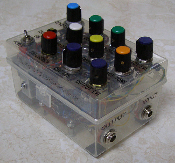

OK, I have now finished building the project, it is looking and working well. More info and pictures at:
http://www.electronicpeasant.com/projects/bassbox/bassbox.html

Good job, Doug! These are the kinds of mods I was envisioning when I started this thread. I particularly like the waveform shaping!

I really love this project and case you made. I went over to your website to check the project out and wondered if you can provide some details on you Piezo trigger?
Hey, I am thinking for an added wow factor, and since the case is clear, it would be cool to put some super bright LED's inside the case so that when it triggers, the entire case pulses with a beautiful glow of light Wink nice for on stage stuff. Cool

Thank you very much for your nice comments! The details for the trigger/pedal are on this page: http://www.electronicpeasant.com/projects/ssdrums/ssdrums.html
Bill
That is an excellent idea! My only concern would be battery drain, but if they only flash when triggered it shouldn't be too bad.

Just want to thank you for those great mod ideas. I incorporated the waveshaper and the seperate pitch decay control, and it does a fabulous kikdrum now. I use a log pot for tuning so I have better resolution in the bass area and have the connections from wiper to ground on the decaypots on minijacks so I can control the decay with the vactrol module from Doepfer.
I like to have a variable decay on my kicks, makes a groove much more interesting.
The bass+++ lives happily next to the mps. That is such an inspiring combo.

Here's an easy one for people who use switching jacks that I borrowed from the MPS. Take a wire from the CW terminal of your Impact Volume to the switched jack on your CV input. (If you don't use switching jacks you should still be able to do this, I don't know if it's bad to just add it as is to a 2nd CV signal.)
This basically just modulates the Shell Pitch with the Impact tone. It is a fairly subtle effect here because the Impact decay is so fast, but when you set your CV pot high it basically creates a very short pitch bump as part of the attack of your drum sound. If you read Scott Stites' theory of the MPS, it is a realistic component of a drum sound (skin tightening upon impact). But more to the point, it adds just a bit of oomph to your drum sounds even without adding Impact volume.
The only downside here is if you are using your unconnected CV as a Fine Tune control when no CV is plugged in, you now have 2 functions depending on this knob. Ultimately I'm considering adding an SPST switch instead, so that the Impact Volume CW can be connected via resistor to the junction of R20, R21 and R23. It's not like this effect is so extreme that you need to finesse it with a pot -- on/off seems fine to me.
This attached file demos the mod. It's just a simple pattern played four times:
1) Straight Shell sound, Impact Volume at 0
2) Impact to CV Mod Shell Sound, Impact Volume at 0
3) Impact to CV Mod Shell, Impact Volume 10
4) Straight Shell Sound, Impact Volume 10
Comparing 1 and 2 gives the best sense of the mod. I uploaded this as wav with markers for each of these variations -- you can check out the first few cycles of each hit to see how they differ.
