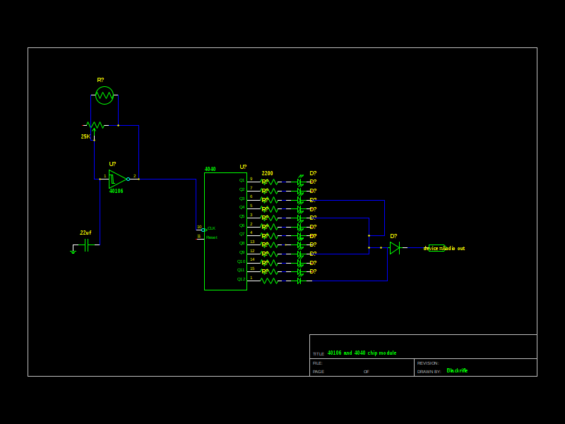

I am not near my module now, but here is the schematic as best that I can remember. A couple of things. All the LEDs should have been connected to ground (I left that out of the shematic). And pin 11(reset) on the 4040 I left unconnected. I think that is it, if there are any more questions about this module ask away.

Blackrifle
Joined: Feb 16, 2011
Posts: 9
Location: United States, Kentucky
PostPosted: Mon Feb 21, 2011 1:43 pm    Post subject: Reply with quote  Mark this post and the followings unread
Maybe you can post an image file (.jpg or something like that)?
Here ya go. Sorry about that, took me a bit of time to figure out how to save it in the program I was using as something a little easier for everyone to use.

PostPosted: Tue Feb 22, 2011 6:47 am    Post subject: Reply with quote  Mark this post and the followings unread
hi Blackrifle, welcome to the forum.
I just took a quick look but I spotted 2 things where you could have gone wrong. Any input on a cmos IC always needs to be tied to ground, this is to prevent the input from "floating". Floating means that the input has no clear way of telling it has to be high or low and will pick up any signal from outside making it behave very irregular.
The common practice here is to tie inputs straight to ground when never using them and use a 100k resistor to ground if you want to be able to use it later as a patchpoint.
In your situation that would mean tying the reset with a 100k to ground and tying all the leftover inputs of the 40106 gates straight to ground.
It's also common to use a 0.1 uF capacitor as close to the +V and GND of the IC as possible to stabilize the powersupply.

PostPosted: Tue Feb 22, 2011 7:34 am    Post subject: Reply with quote  Mark this post and the followings unread
tjookum, thanks for your help.
Was just trying to figure out how to use the software for the schematic. I do have all the 40106 inputs tied to ground. However I did not tie the reset of the 4040 to ground. Could that be why some people commented about two separate frequencies from the sound file I uploaded? Hmm something to ponder on.
Also I ran out of jumper wire so I only have three outputs of the 4040 going straight to my amp through a 1N914 diode. The other outputs are just flashing LED's however I think there is some "bleed" over because I can definitely here slight moderation's in the audio when different LED's flash.
I will have to look a bit closer though, because I do remember there are either 2 or 3 LED's that are not lighting up at all. Could this be because of the reset pin not being tied to ground through a 100K resistor?

PostPosted: Tue Feb 22, 2011 9:42 am    Post subject: Reply with quote  Mark this post and the followings unread
Is erery output running trough a resistor and LED and to the output, or is the LED tied to the ground and is the diode connected to the pin of the chip?
Blackrifle

PostPosted: Wed Feb 23, 2011 6:08 am    Post subject: Reply with quote  Mark this post and the followings unread
Kabzoer,
Yes and no, sort of. Let me explain. In the sound sample every output is running through a resistor and LED, however I only had enough jumper wires on hand to run 3 to audio out, these three outs are going to one 1N914 diode which feeds directly to the tip of my audio jack. All other outputs are running through resistor to led, then to ground. When I get enough jumpers put together I will run all outputs through resistors, then LED's then out to audio. Personally I like the sound the diode gives, but this is a personal preference. I got the idea from the Nicolas Collins book: Handmade Electronic Music

PostPosted: Wed Feb 23, 2011 9:49 am    Post subject: Reply with quote  Mark this post and the followings unread
So you connect different outputs to eachother without diodes? I wondered if that works so i tested it and yes, you don't have to use diodes but it makes a different sound. And what difference does the diode at the output, is there much change in the sound?

PostPosted: Wed Feb 23, 2011 2:37 pm    Post subject: Reply with quote  Mark this post and the followings unread
In response to this here is what the book I previously mentioned earlier has to say word for word"
If you mix the outputs together using a component called a “diode” instead, you’llnotice that the individual oscillators interact and distort in an archetypically “electronic music” way—they produce a “ring modulation”-type sound, in which sum and difference frequencies are exaggerated and the individual source pitches obscured...If you sum more than three oscillators together with diodes you might notice that the
signal gets oddly noisy; if you don’t like this artifact you might mix three to one jack and
three to another for a nice stereo sound field, or mix up the orientation of the diodes.
Sometimes this diode-mixing works connected to some kinds of amps and mixer and not
to others. If a multi-diode mixer does not work with your amplifier, try connecting an
additional 10kOhm resistor between the output point (where all the diodes tie together)
and ground."
I guess in other words just sort of experiment around with different configurations of diodes.

PostPosted: Thu Feb 24, 2011 9:59 am    Post subject: Reply with quote  Mark this post and the followings unread
I read the book, but i think that you need a diode on every output to get the effect. I tested your design without LEDs and just connecting different outputs randomly with jumper wires or diodes and i really enjoyed the resulting complex rhythm and tone variations Very Happy
