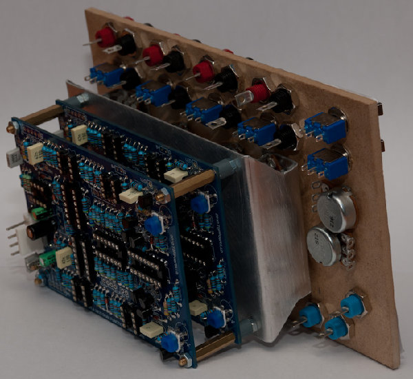

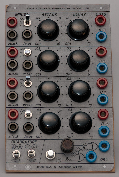

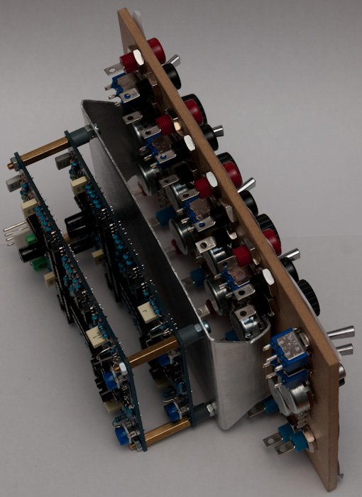

Just a few pics of my 281 prototype, Buchla style.
Before ordering a professionally made panel I made a panel out of 3mm thick scrap wood to check out if everything would fit on and behind the panel. The panel design was made in Front Panel Designer and printed on paper.
I made a custom bracket to mount the PCBs so I wouldn't have to drill additional holes in the front panel.
The total depth behind the panel (power cable included) is about 9 cm (3.5").
Looking at it I think I will drill some extra holes in the bracket to allow easier routing of wires to the PCBs.
Although I built a Klee sequencer I am a bit hesitant to start wiring this... Wink
Maybe it gives you some ideas of how to mount everything to your own panel.
Buchla 281 prototype

I may be alone in this, but I have a problem with actually putting "Buchla & Associates" on the front panel. To me, that moves it from the realm of tribute, into the realm of forgery.
Chris Muir
beautyofdecay_
Joined: Aug 14, 2009
Posts: 38
PostPosted: Thu Apr 07, 2011 4:18 pm    Post subject: Reply with quote  Mark this post and the followings unread
Hi Chris,
You may be right about that.
This is just a prototype printed on a piece of paper. Now I think about it, I will remove the name from the final panel.
What I wanted to show however was the mounting of the PCBs to the panel Wink
Regards, Andre.

Looks great beauty,what will cost you more or less a proffesional made panel,if i may ask?
beautyofdecay_
Posts: 38
PostPosted: Fri Apr 08, 2011 10:55 am    Post subject: Reply with quote  Mark this post and the followings unread
The panel in the picture would cost 135 Euros at Schaeffer. A bit too much for my taste.
I'm looking into local/national companies who can do silk screened panels but do not know any pricing yet.
