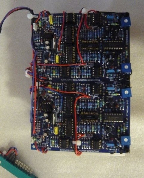

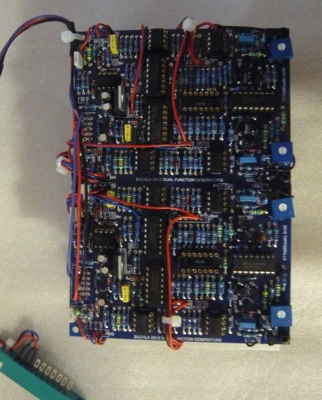

PostPosted: Thu Oct 20, 2011 1:17 pm    Post subject: Reply with quote  Mark this post and the followings unread
Not easy to attach the boards where they belong to be attached,but am good...

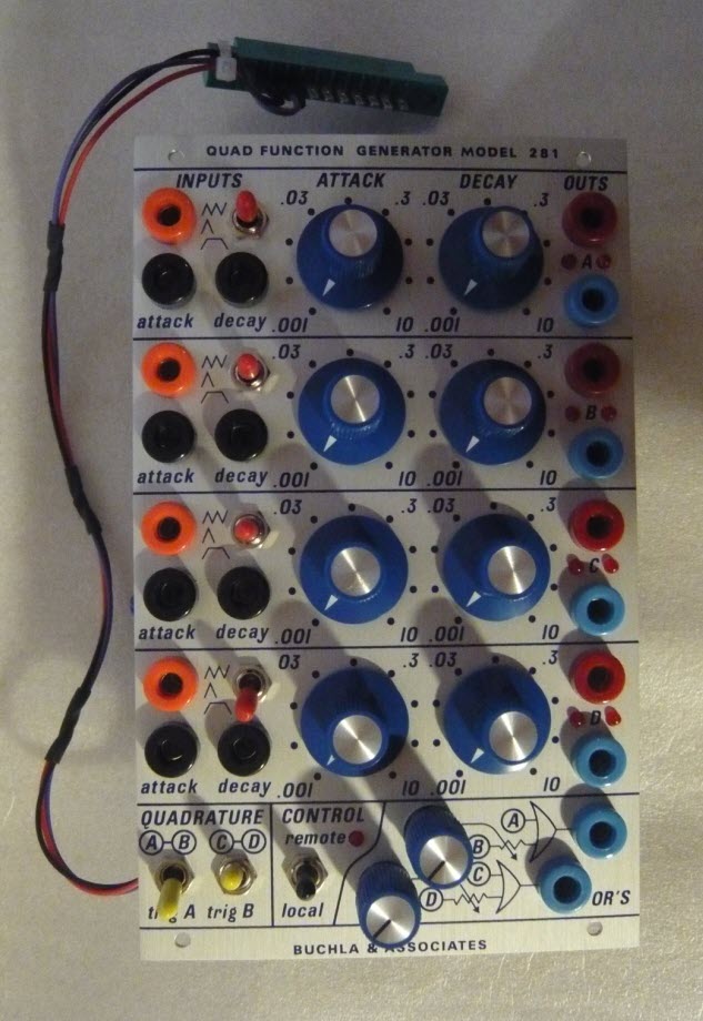

PostPosted: Fri Nov 11, 2011 11:19 am    Post subject: Reply with quote  Mark this post and the followings unread
Just missing the 4016,damn
btw,i have two kits on offer (panel,knobs,populated pcb's).

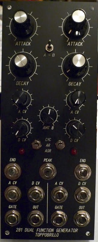

PostPosted: Sun Nov 20, 2011 12:58 am    Post subject: Reply with quote  Mark this post and the followings unread
Here one of my two 281 modules.
What a great module.
Thank you Toppobrillo

PostPosted: Sun Nov 20, 2011 4:21 am    Post subject: Reply with quote  Mark this post and the followings unread
That looks great ATOM. I'm also considering adding extra pots to regulate the amount of "Attack CV" and "Decay CV". I also plan to use "switching jacks" for the "Attack CV" and "Decay CV" inputs. This way I can wire them up so that the "output of the EG" is wired to the Attack CV and Decay CV inputs when a patch cord isn't inserted into these jacks. You can then use the pots to reshape the output of the EG from a linear-type envelope output to an exponential-type envelope output.
Did you wire your module up in this manner? If so, how does it work. (Some scope shots would be wonderful!)

PostPosted: Mon Nov 21, 2011 6:00 am    Post subject: Reply with quote  Mark this post and the followings unread
Yes. I had wired the module as you described. Works great.
Expo decay
Peak out one slope expo, one normal.
ATOM
