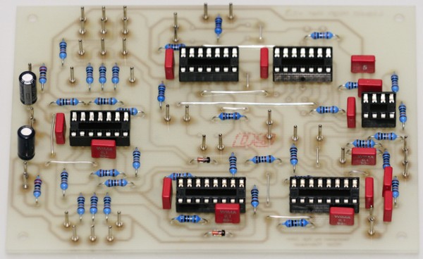

This guys have been hiding in a vintage Dutch sugar box, but at at the end of the day the board is almost populated. Only the four 10nF caps are missing. I hope to get them by next week.
hide of resistors
 Filesize:  171.65 KB
 Viewed:  28156 Time(s)
mostly populated board.
 Filesize:  248.17 KB
 Viewed:  1808 Time(s)

PostPosted: Wed Aug 03, 2011 1:08 pm    Post subject: board finished Reply with quote  Mark this post and the followings unread
Quick update: The board is finished now and some wood cut for a prototype front panel. Drilling the holes next.

I'm also almost through with stuffing the board.
Will have some quality time for DIY next week and should be through with this fairly soon.

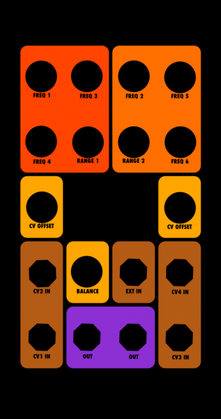

It took some time to collect the front panel elements from various sources, now I come up with this draft:
Liquid Hihat panel draft, regular version

PostPosted: Wed Aug 10, 2011 4:50 pm    Post subject: Reply with quote  Mark this post and the followings unread
AGH! I have no idea why I wasn't getting email notifications for the last replies! Sorry!!!
Usually I am very quick to reply! Anyway...
That looks FANTASTIC! Very Happy Awesome! Nice work -- keep it up!
