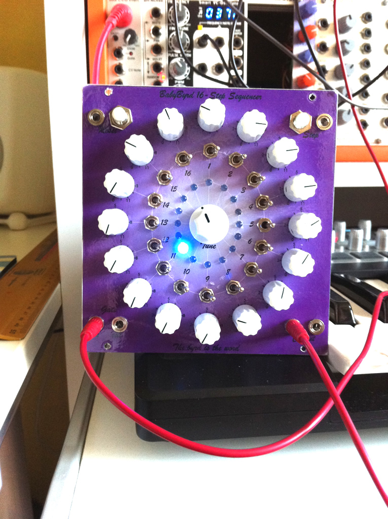

PostPosted: Wed Sep 14, 2011 9:17 am    Post subject: Reply with quote  Mark this post and the followings unread
What the .pdf suggests definitely works. This is what I came up with in the end!
But Richard is right, start with an 8-step version and refine that one. Then, once you've gained some experience start working on the "Baby 16" sequencer.
And be prepared for a hellish type of wiring job when you work on the 16-step sequencer! Laughing
 Filesize:  322.2 KB
 Viewed:  1227 Time(s)

PostPosted: Wed Sep 14, 2011 1:37 pm    Post subject: Reply with quote  Mark this post and the followings unread
Thanks Richard, I hadn't seen that newer link. I have already built an up-to-ten trigger step sequencer from the 4017 with banana jack outputs, i was really hoping to move on to longer sequences. As you say that pdf brock posted looks promising, so I'll give that a go some time in the next few days.
hv0190 - that thing looks awesome, not sure if i misunderstood you but is it based on the schematic from the datasheet?
hv0190
Joined: Apr 18, 2011
Posts: 25
Location: Munich
PostPosted: Wed Sep 14, 2011 11:44 pm    Post subject: Reply with quote  Mark this post and the followings unread
Hi Toothpaste,
yes, it's based on the datasheet schematic, it's not a bad idea to try and understand how it works. For a start I'd take a look at this website:
http://www.doctronics.co.uk/4017.htm#sequencing
As far as I can understand it (I'm still a noob), the whole thing works like this:
Once the last output of the first 4017 goes high it enables the EN-pin (13), thus stopping the first 4017; at the same time - through the 4081 AND-gate - it makes the second 4017 start counting (because now the clock signal can come through). Once the last output of the second 4017 goes high it resets the first 4017, so this one starts again at pin 3, while the second 4017 is stopped again as the last output of the first 4017 goes low (thus disconnecting the second 4017 from the clock).
I actually combined this with Fonik's Baby10 ideas to add step/reset possibilities:
http://www.modular.fonik.de/Page22.html
There are still some very occasional glitches that I cannot account for (every now and then it sort of skips the first step, could have to do with the clocking signal or maybe I should use proper LED drivers Shocked ), but basically it works flawlessly.
The big white knob in the middle is simply used to regulate CV output (1V, 2V, 4V, 5V = 1 octave, 2 octaves etc.) and the switches mute the respective step.

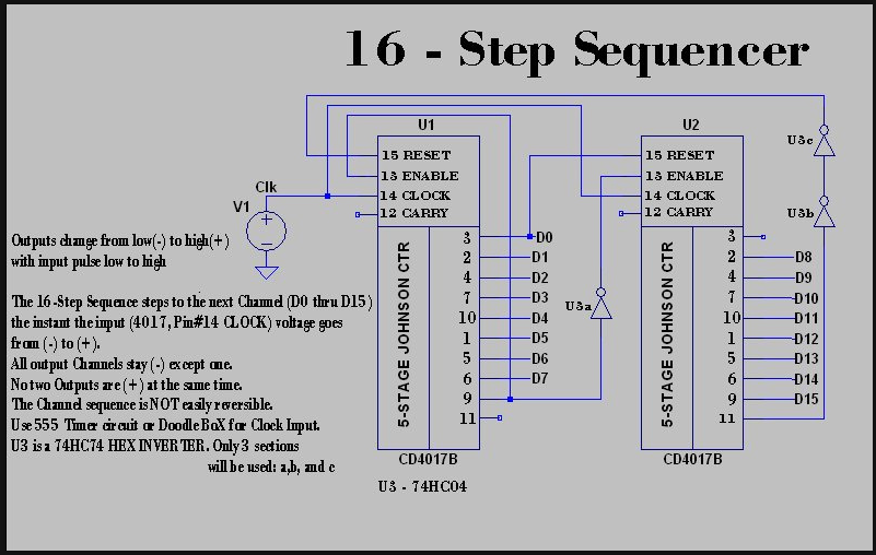

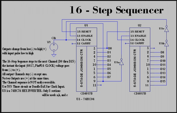

PostPosted: Tue Oct 25, 2011 2:45 am    Post subject: Reply with quote  Mark this post and the followings unread
I haven't tested this myself, but I'm pretty sure this will work. I also don't know how it compares to what is shown on page 6 of that datasheet either. I hope it helps though.
 Filesize:  211.72 KB
 Viewed:  4345 Time(s)

PostPosted: Fri Mar 30, 2012 6:32 pm    Post subject: Reply with quote  Mark this post and the followings unread
Can anyone take a guess on the values of C2 and R4 in Hoshuyama's schematic? I believe these components are responsible for the power-on reset function. Also, would the pulse circuits connect directly to the 4017 stages?
brock
Joined: May 26, 2011
Posts: 112
PostPosted: Sat Mar 31, 2012 10:50 am    Post subject: Reply with quote  Mark this post and the followings unread
I think almost any values will work for C2 and R4. I'd try 1uF and 10K, reset will finish before the internal oscillator clocks.
Yes the pulse circuits connect to the 4017 outputs.

PostPosted: Tue Jun 12, 2012 7:33 pm    Post subject: Reply with quote  Mark this post and the followings unread
I just put this together on the breadboard and verified this works!
