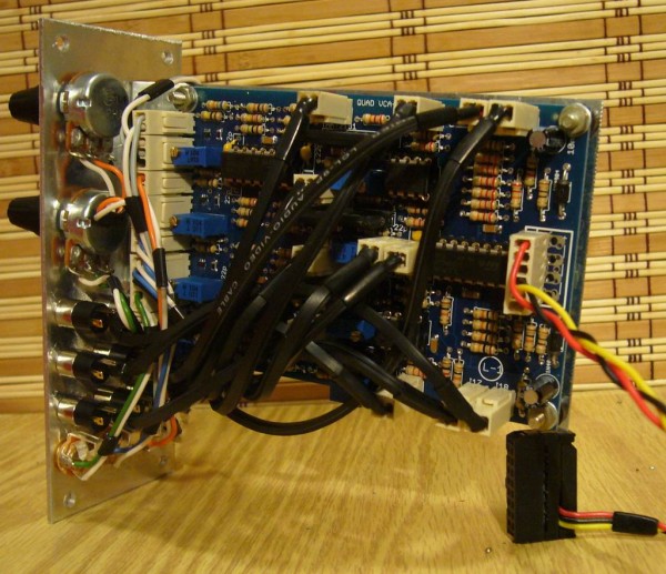

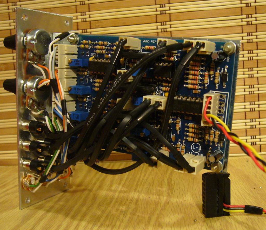

I have designed PCB for hi-quality Quad VCA-Mixer. This is really workhorse for every modular system. I was needed several hi-quality VCA's with mixing possibilities for my system. Now I going to order PCB's. I need to estimate quantity of PCB's to order. Please PM me who are in and quantity needed.
Boards have some SMD parts which will be already installed (I will order smd-components insertion).
Installed parts: 4 x BC847BS dual transistors, 4 x 2K TEMPCO resistors, 14 x 0,1 mkF decoupling caps.
Price 45$ per board with installed SMD-parts; and airmail shipping about 5$ anywhere.
FEATURES:
- Eurorackers are welcome! PCB size 105 x 70 mm, have EURO, MOTM, Dotcom power connecton possibilities (12V version differs from 15V version with two resistor values).
- VCA's design based on THAT Corp. design notes and uses maybe the best available VCA chip THAT2181.
- VCA's have tempco CV inputs as suggested in THAT Corp. design notes for more accurate results.
- it's possible to mixing channels in pairs and all together.
- all connectors have on board ground pads for shielded cables.
- I used hi-quality OPA2604 opamps at VCA's outputs but regular TL072 will fit too.
Estimated start of sales - february 2012.
I will make web-page with detailed assembly instructions.
Please PM me about quantity with contact info, I will contact you when boards will be ready.

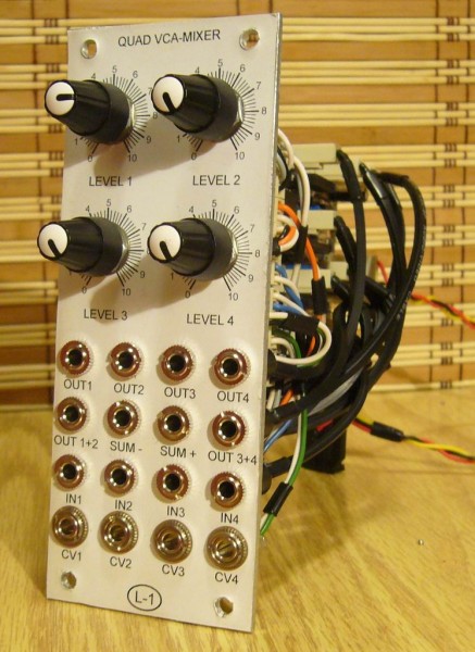

I can't spend much money for front panels therefore make DIY with acceptable results. I will make web-page with detailed instructions for board and frontpanel assembly. Here is example foto of my 3U module.

Mongo1
Joined: Aug 11, 2011
Posts: 411
Location: Raleigh NC
PostPosted: Wed Dec 14, 2011 8:49 am    Post subject: Reply with quote  Mark this post and the followings unread
Very nice!
I've been trying to do my panel work as cheaply as possible, and it hasn't really met my expectations yet. I've been trying to do some stuff with laminated artwork on sheet metal, but I keep running into problems getting holes to line up between those two layers, and the angled aluminum stock I use as my PC board mount.
I'm working on developing some jigs for my drill press that may improve accuracy. Hopefully that will help.
Gary

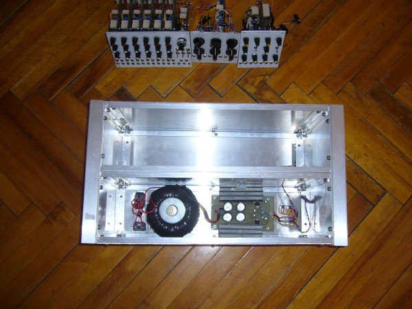

Technology I use is not the best but very cheap and strong. This is rack without power rails.
 Filesize:  2.18 MB
 Viewed:  353 Time(s)
Mongo1
Posts: 411
PostPosted: Wed Dec 14, 2011 9:21 am    Post subject: Reply with quote  Mark this post and the followings unread
Wow - that is really nice stuff. I love that inductor! Did you wind that yourself or buy it ready-made?
L-1
Joined: Dec 11, 2010
Posts: 39
Location: Belarus
PostPosted: Wed Dec 14, 2011 9:33 am    Post subject: Reply with quote  Mark this post and the followings unread
I only ordered laser-cutted aluminium plates, it's not expensive, because I tried to cut at home without required precision. All other is DIY include huge 250VA trans.
