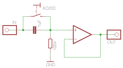

After some afternoon testing, I finally had to install the input resistors. Looks like the AC coupling caps would not discharge without those, and the AC mode wasn't working correctly.
I've attached a schematic of what I finally did to my inputs. Is this looking good? Sorry for my lack of electronics knowledge.
Thanks again!

Hi vcfool,
yes, AFAIK your schematic is very good, and it works perfectly.
It actually is the same circuit I was suggesting as "option 1" in my message dated June 21st, 2011; no wonder we came to the same solution, I would say it's a standard one
Sorry for not answering sooner, but it's good to see that you found the correct answers on your own.

Great!
Thanks once more for the answer and the improving modification.
