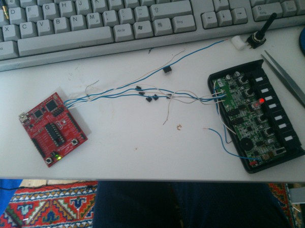

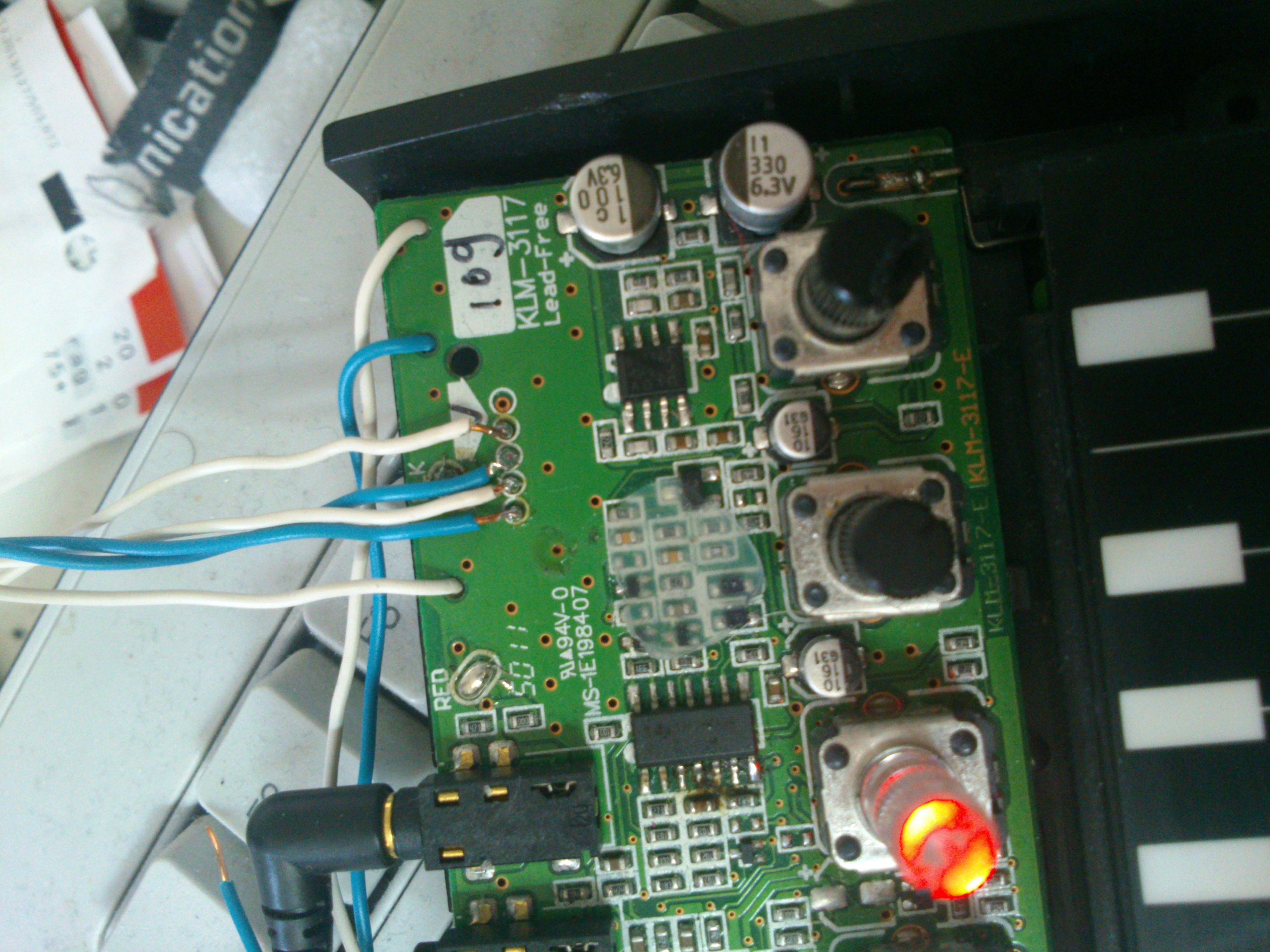

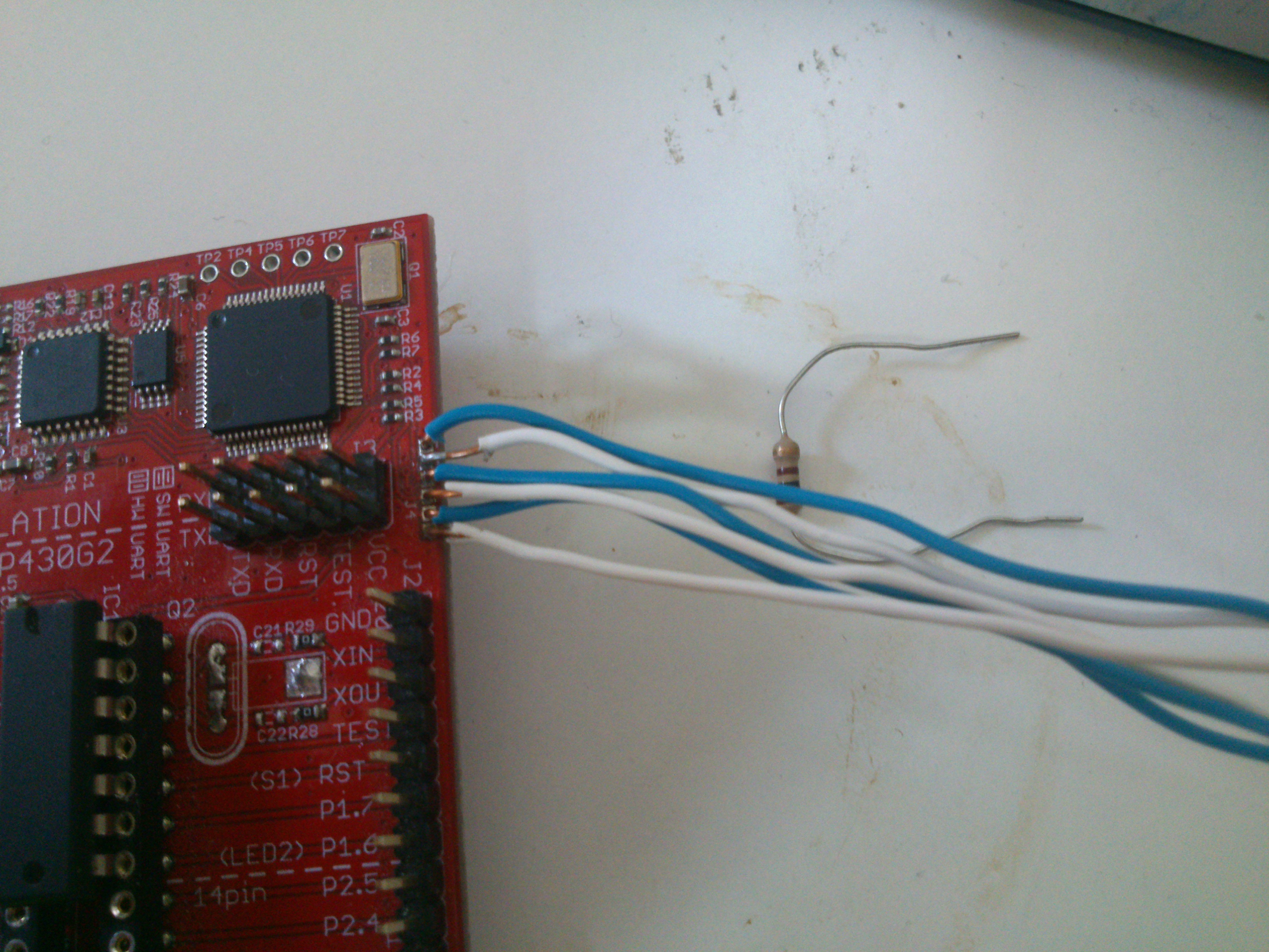

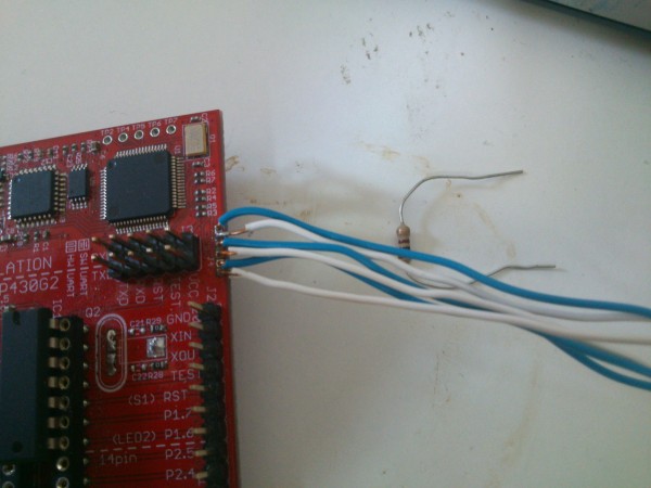

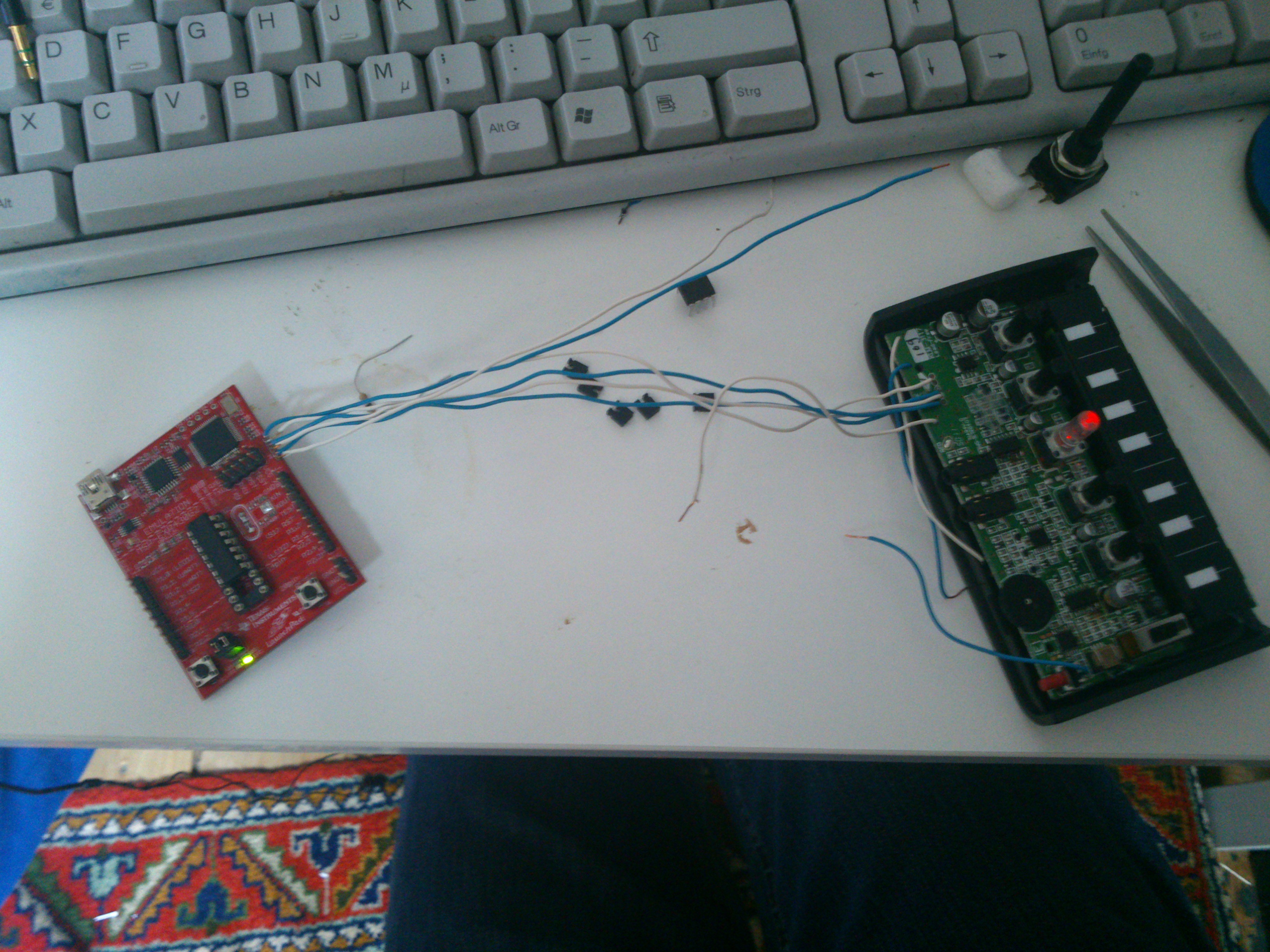

PostPosted: Thu Mar 27, 2014 9:43 am    Post subject: Programm your Duo with Energia and the TI Launchpad
Subject description: New discovery
Hi guys,
I discovered that the MSP430 within the Monotron Duo is quite easy to program.
You know the free space on the right hand of the PCB?
Well, the five holes over there form a programming header, which will allow you to programm the MCU with your Launchpad.
If you take a look at the schematics you'll find these header next to the MCU. I soldered these pins right to the J4 Header on my TI Launchpad, but you'll find some tutorials on the web on How-To-Use-the-ti-launchpad-as-isp, so I won't explain any futher.
Code:
_________________________________________
|   Launchpad J4   |   Monotron Duo     |
|   2 (VCC)         |   4 (VCC)         |
|   3 (SBWTCK)      |   1 (CLK)         |
|   4 (SBWTDIO      |   2 (I/O)         |
|   5 (GND)         |   3 (GND)         |
My next step was to take a raw dump, hexout and disassemble everything via mspdebug. I also did a disassembly with nakem_asm but since I don't know assembly this does not really help me. Maybe some of you can do better, I'll attach everything.
The last and most interestig step to me was to programm the MCU via Energia in a Arduino-like language. If you fire Energia up, make sure you remove the programming headers on the launchpad ( you know.. those tiny plastic bits) so you are only connecting to the MSP430G2331 in your Monotron. Then go to Tools -> Boards and select "Launchpad w/ msp430g2331 (1MHz)".
To program your Monotron Duo in a way that you can use it in a musical way (I define making noise as musical), you need to understand what the different pins are doing.
Code:
|   Pin Number  |   Testpoint   |   What I assume it does.                                      |
|   P1.0        |   Vrib        |   Reads the value of the Ribbon for Gate and Pitch.           |
|   P1.1        |   knob        |   Reads the value of VCO1 Pitch for coarse tuning.            |
|   P1.2        |   pitch       |   Controls Pitch via PWM. (-> @alfa66 )                       |
|   P1.3        |   gate        |   I bet you know what it does ;-)                             |
|   P2.6        |   SW2A        |   Changes interval of the Pitch played on the Ribbon.         |
|   P2.7        |   VCO1        |   Takes the output of VCO1 Pulse. Propably used for tuning.   |
I don't know if I got everything right, but I attached a sketch that I will use for experimentation. Since there are 3 unused Pins on the MSP430 and a spare opamp on the PCB I see many possibilitys for extending the Synth.
In the next days I will try to create a sketch that allows normal Monotron use (without pitch quantization). Afterwards I could imagine to add a two more potis and use the opamp as LPF for CV control (-> @alfa66) of the VCF ( or maybe VCO2) and adding a digital AR-Generator, LFO, S&H or even a sequencer. I won't promise but there is also a chance of "native" MIDI control Wink
I'm looking forward to see what you will do with this,
Lars Christian
