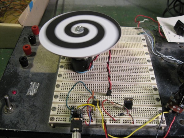

PWM is the best way to go to avoid dissipation problems and reduced torque. It's easy to do. Attached is a one chip solution I whipped up on the workbench. I used the PICAXE 08M just because I had some laying about. The more modern 08M2 could also be used.
I've shown two different options, one using a Darlington and the other using a power MOSFET. Either works quite well and both run cool. A pot is used to provide the control voltage, but this could be provided by a synth. The range is 0 to +5V and controls the motor from 15% to 99% full power.
Also attached is the code. It ended up being 32 bytes long, so there's a lot more space left over for any modifications you have in mind. There are also some extra port pins.
Remember, the Program Editor for this chip is free, and the "programmer" is nothing more than a cable---total outlay: $4 for jacks and wire.
Finally, I've attached a photo of my test rig. Hope that gives you some ideas.

JAMESveeder
Joined: Nov 16, 2010
Posts: 34
Location: tucson
PostPosted: Mon Nov 05, 2012 1:44 am    Post subject: Reply with quote  Mark this post and the followings unread
Wow, I appreciate all of the replies, and thanks for the thorough reply, Thomas_Henry!
So essentially what I would need to do is take the control voltage from the sequencer, convert that into a pulse width signal (which I'm assuming is just taking the square pulse coming from the sequencer and changing the duty cycle based on voltage?) and differing duty cycles will change the speed of the motor, am I right?
Forgive me if I'm not getting this, the learning curve for DIY electronics is quite steep in my opinion haha.

PostPosted: Mon Nov 05, 2012 3:48 am    Post subject: Reply with quote  Mark this post and the followings unread
yep, if you use thomas's circuit you will have to make sure that you scale your voltage down to 0-5v though, and just use your "CV out" into pin 6
