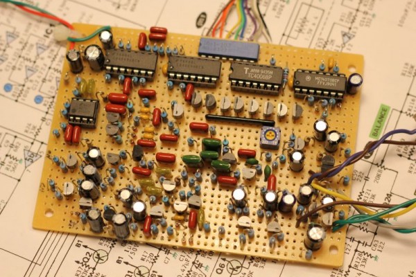

This is my second post today. The first was about the Hammond B3 Propeller, and this one is about another project I have been working on the last few weeks. I have never owned a DR-110 or played with one, so I decided to try and perfboard all of the DR-110 voices and see what they sounded like. Here is a little demo of the perfboard. I mentioned the Propeller B3 post because I am using the same MIDI file here but this time all of the instruments in the MP3 demo are from a Yamaha MU-50 except the drums. All of the drums are from the DIY DR-110 board. I used BC550 and BC560 transistors throughout except for the snare drum, that was a 2SC945 with a very high HFE.
The row of eight transistors in the top middle of the board are inverters and signal conditioners for the triggers. The blue DIP resistor array are the eight input triggers. I am going to add a small 8 pin PIC microcontroller to provide the the four sequential triggers needed for the clap voice.
Regards,
Theff

Theff:
That is some crazy amount of perfboarding! I thought of doing this in the past but knowing the number of connections made me sober up! Wink I ended up buying a less-than-perfect DR110 for a reasonable price and completing it that way. Feel free to use my PicAxe program to do the hand clap triggers. Nice job!
Synth DIY since 1977!

Hey Dan,
Thanks, I started out just wanting to see what the cymbals sounded like and then couldn't stop building. I built each voice one at a time and tested them as I went along. Thanks for the PicAxe suggestion!

I was surprised how good the OH, CH, and Cymbals sounded compared to most of the white noise/multi-oscillator circuits that I played with before. That's what kept me building the additional voices. Boss really did their homework when they designed the filters and VCA envelopes for the DR-110. Simple but very effective.

Would you mind sharing the PIC code? I totally forgot about those four essential clap triggers. I modded mine years ago - and it has been on constant loan to a friend in Belgium BUT I he is coming over next month, and he will bring it back!
I think I will work on it some more then.

I have only done a very quick and dirty version of the PIC code using a 12F675. I am going to clean it up soon and will certainly post it here when it's done.

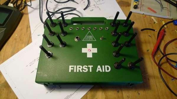

I've had a broken one of these kicking about for decades (seems like), I recently found this forum/thread and decided to do something with it.
This is what I ended up with Smile The logic board on mine was scrap and the power supply was b0rked (guessing someone plugged it into something they shouldn't?) I powered it up on the bench and could trigger the individual sounds using the tempo clock signal, so I figured I could salvage something out of it.
I applied most of the mods in this thread, so nothing new to report really and added individual trigger ins for each sound (and accent). I haven't got round to triggering the clap properly but probably will do at some point (enough other stuff to work on at the moment).
I put it in an old first aid box because that was the first thing I found that was roughly the right size...
Just waiting for some knobs to finish Smile

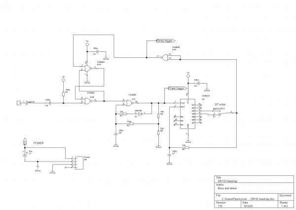

At the request of tupinamba,
I have posted a current schematic and the HEX file to program the PIC 12F675 to drive the clap triggers in the Boss Dr-110.

PostPosted: Tue Sep 27, 2022 5:29 pm    Post subject: Reply with quote  Mark this post and the followings unread
Theff's and my trigger input circuit are doing basically the same thing. The DR110 trigger lines are normally at +6v and trigger when a 0V or ground connection is present. Most of us use a 0 to +V(5-12) trigger to fire drum sounds, so the 4049 hex inverter is used to convert positive going triggers to negative going triggers.
The inputs are what differentiate Theff's and my circuits. He uses a voltage divider with a zener diode to ground to prevent excess voltage at the inverter input. I'm guessing he uses something greater than 5V to trigger his drum circuits. For mine, I use a signal diode on the input to prevent misfiring and the 10K resistors to ground ensure the inputs return to a 0V state. Without the resistors, they would fire once, then hang up at 5V and not retrigger. Yes, My drum triggering logic is all based on +5V.
The clap requires several mis-timed triggers to create an ensemble affect. I used the picaxe and Theff used a uC, but really any programmable logic device such as an arduino could generate those pulses. You can even use RC techniques to create the timing.

I didn't have a 74HC393 counter, but a 4024 works fine. I added a switch to allow the initial trigger to be either 3 pulses (as in the original) or 7, which produces a quite different effect.
With separate control pots for the decay of the triple and 'echo' triggers, and balance and tone controls as per mods found here, the module is capable of a wide variety of sounds. As built, it requires an external noise input - if noise is used, the handclap sound can be produced, but virtually any signal can be used as a source - eg from a VCO (it seems not to mind negative voltages either), allowing a huge range of pings, rings etc.
