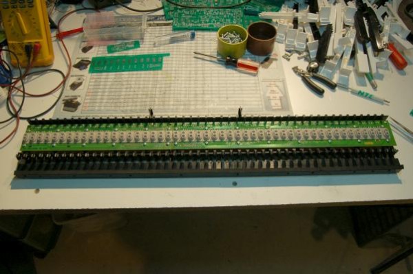

I started off to build a simple cv keyboard, but "feature creep" crept in (pun intended) and it turned into this.
I made up some pcb's to retrofit the Fatar keybed to be a resistor network.
The keyboard has 4 buffered outputs each for CV, Gate, Trigger, Bender and Modulation (sine and square outputs),
it will also have a ribbon controller built in, but the ribbon will be on a separate pcb (for now anyway)
For controls it has an Octave switch, fine tune, portamento, LFO rate and amplitude, a scale control for the ribbon
and pitch and mod wheels with a switch to route the lfo sine to the keyboard cv
The keyboard can be scaled for any size keybed, I designed the keybed pcb's to be "modular" there is one pcb
for the left side and one for the right side, the pcb's in between are all the same (1 octave each)
So far everything is working as it should, I missed a couple of holes on the right keyboard pcb, and integrated the
octave switch and output board on to the keyboard pcb, so right now I am waiting for them to be made.

...and here is a pic of the retrofit boards, two are installed, the resitors are mounted on the bottom but
they could also be on the top if you want

Can you post some details on the pcbs (schematic, parts list, etc.)? Does it use a constant current source and resistor ladder type approach? Are you planning to sell these?

I thought about using a similar solution, but I was always concerned if the rubber contacts introduced any resistance - Can I presume that the contacts act as a clean switch and pass through the CV voltage cleanly?

Yes, take a perfectly good matrix keyboard, suitable for digital scanning, and convert it to single buss for a finicky, resistor string voltage divider and droopy sample & hold analog design.

Bill's pcb still scans a diode matrix keyboard, which is the best way if you want CV and Midi.
My keyboard is strictly CV, the main circuit is based on the Roland M181 keyboard, with a few tweaks, additions and modifications.
All the individual components have been built and tested, I have done up a new pcb with everything (except the ribbon) incorporated onto one board, but of course I have no money at the moment to get some boards made,
I did manage to get some panels made, once I get everything mounted in them, I'll post another pic.

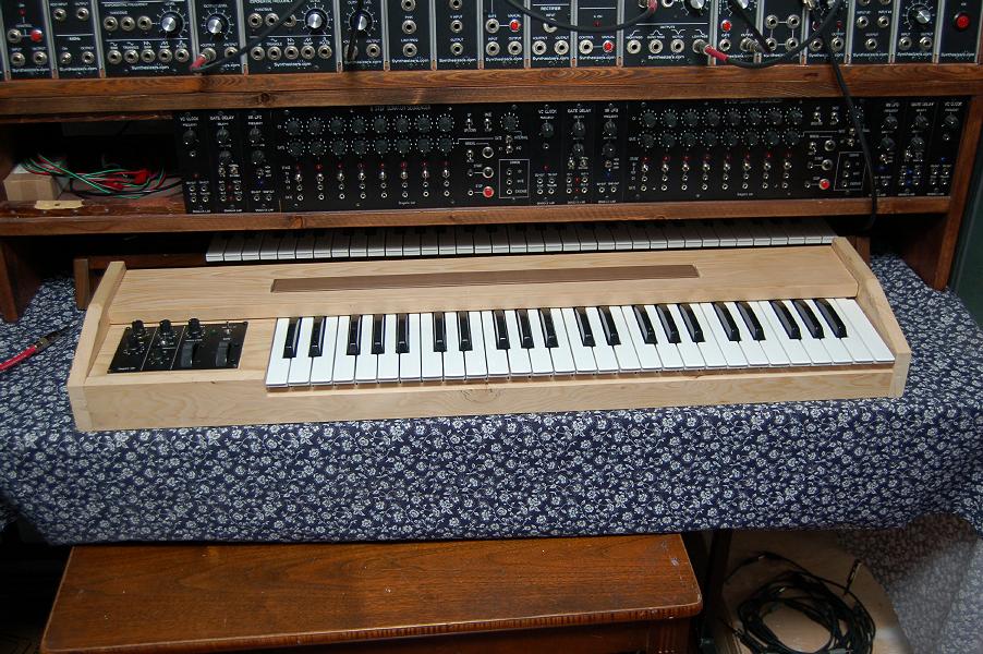

Well the weather warmed up enough to get out to the shop and cut some boards, and mock up a case.
Generally, this is what the keyboard will look like, dimensions are 36"x 10"x 3.75" high (at the back)
It needs a bit of tweaking, before finalizing the design, mostly to eliminate the visible screws.
I added a 6 pin din plug to the rear panel, that way the keyboard can be powered from my dotcom system, or alternatively I can put a power supply into the keyboard case, and use it to power a medium sized dotcom system.
I have also been thinking of hinging the top panel (with the ribbon) to allow easy access to the electronics inside.
One question, would you rather have the jacks on the back, or on the top?
Now to order some nice hardwood planks (and a new saw blade)

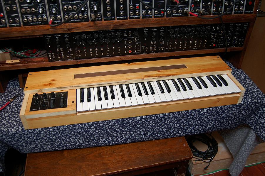

I opted for a complete re-style, I took out the power supply and put in a board to convert a 20vac wallwort to +/- 15 and 5v, this let me cut the cabinet down a bit, the dimensions are 36"x 9"x 3" (3.5 for the end cheeks)
With a 20vac 2amp wallwort there is enough power for a 22 space dotcom studio or portable case.
I also hinged the top, which makes it a lot easier to adjust/scale the keyboard.
Once I can find a reliable source for the keybeds and pitch/mod wheels, I was planning on building and selling complete units, I am also planning on offering stand alone CV and Midi Ribbon controllers, I am hoping to have prototypes made up by mid February.
Now for some sanding and staining, then a few coats of varnish.

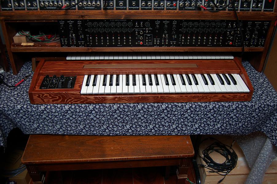

Stained and varnished...
