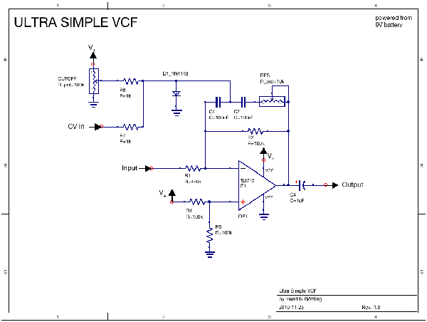

Hey there!
I thought I share a little VCF-circuit I've been working on.
It's a pretty simple circuit using just a single opamp, some resistors two caps and a diode. I'm pretty sure someone else already had the same idea but I still think it's worth sharing. Wink
It's not a very accurate filter but it can be powered from a single 9V battery. And for those who are looking for cheap and simple VCFs this might be the solution (or at least a pointer to the right direction).
I ran some tests with some drum- and synthloops.
It should be ok especially for noise boxes, drones and other crazy and noisy stuff Cool
Enough talk!
Here is the schematic and a little recording with a drumloop and a version with an additional synth.
Have fun!
Greetz
Hendrik

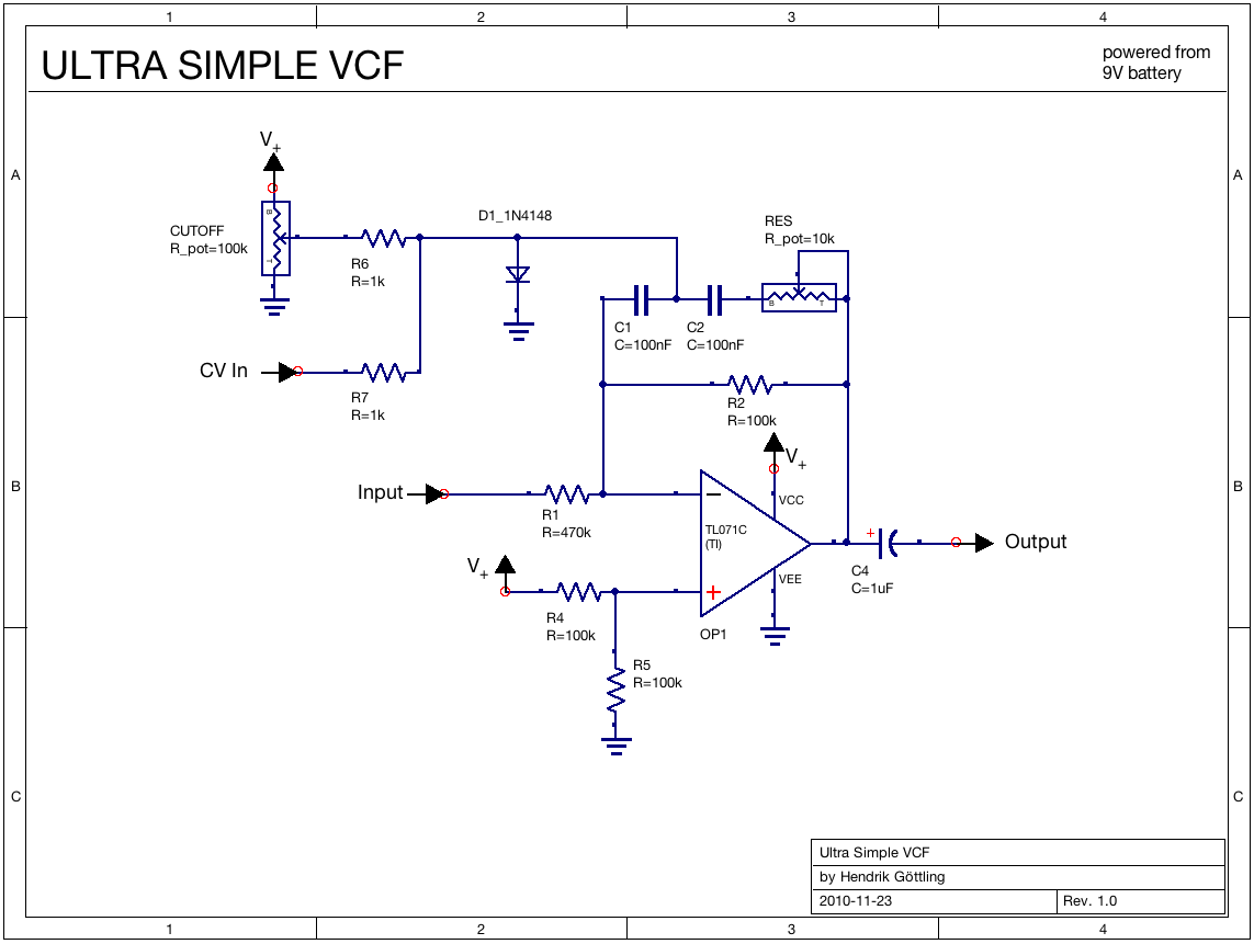

This is the revised version of the schematic

PostPosted: Sun Nov 28, 2010 10:06 pm    Post subject: Reply with quote  Mark this post and the followings unread
Those 1k CV summing resistors should at least be 100k.
And your VCF looks a lot like Tim's
http://www.jiggawoo.eclipse.co.uk/guitarhq/Circuitsnippets/simplevcf.gif
Youtube!
modular demos!
Whacky tunes!
metal_head_82
Joined: Dec 27, 2009
Posts: 34
PostPosted: Mon Nov 29, 2010 4:25 am    Post subject: Reply with quote  Mark this post and the followings unread
Hey Snthmonger,
I lowered to summing resistors on purpose.
They were 100k but that didn't gave me the filter sweeps I wanted - so I lowered them down. The circuit itself has also changed. But it's not finished yet. I'm still trying to improve the frequency range.
The filters you posted look pretty cool. I think I'll have to breadboard them.
My Idea for this filter came from some simple, passive VCF circuits which didn't offer Resonance control. So I tried to include the technique used there in an active design.
I was pretty sure that I came up with something new Sad
But as I already mentioned: I'm sure that someone else had the same Idea.
Had the same issue with a 2 op amp LFO I thought I designed.
But I realized that it was such a simple standard design - it has been posted several times in many forums. So no post here.
I'm currently building a little filter toy with my design. Perhaps the filters you posted work out better. I will give it a try.
Thx for the hint! Smile

PostPosted: Mon Jan 02, 2012 9:23 am    Post subject: Reply with quote  Mark this post and the followings unread
This is an active bridged-T filter.
Just google for bridged-T filter and you should find the equations. I selected the values by trial and error Wink
To improve the frequency range you could exchange the diode with a garden variety transistor. e.g. BC547.
Connect the emitter to the junction of the two caps and the collector to ground (0V). Apply the CV to base. This should improve the behaviour to cv and give you some more control - especially with low CVs. You should then rise the summing resistor values to at least 100k. To limit the filter's frequency response when no CV is applied you could try to place a resistor in parralel to collector and emitter.
I think this is the same way Ray Wilson achieved a VCF in one of his designs. I'm pretty sure I saw this method in one of his old devices. I came up with this when I modified my WSG. Now it has some nice "quasi-vcf" Wink
Hope this helps a little.

PostPosted: Sun Mar 11, 2012 5:42 am    Post subject: Reply with quote  Mark this post and the followings unread
tokyomatik wrote:
when i feed the signal to the filter the volume goes drastically down
Replace R1 with a 100k resistor. This should fix the volume drop problem without (drastically) affecting the operation of the filter. You could even go lower to compensate a bit more if needed. Note that this will lower the input impedance of the filter, so make sure the output of the previous stage has a low enough output impedance, or you could get attenuation from the impedance mismatch (this shouldn't generally be a problem unless you have a volume pot before the filter or something like that)
I'm not sure why R1 is 470k in the first place. It looks like maybe a mistake? Or maybe the attenuation was intentional? Sorry I'm new here.

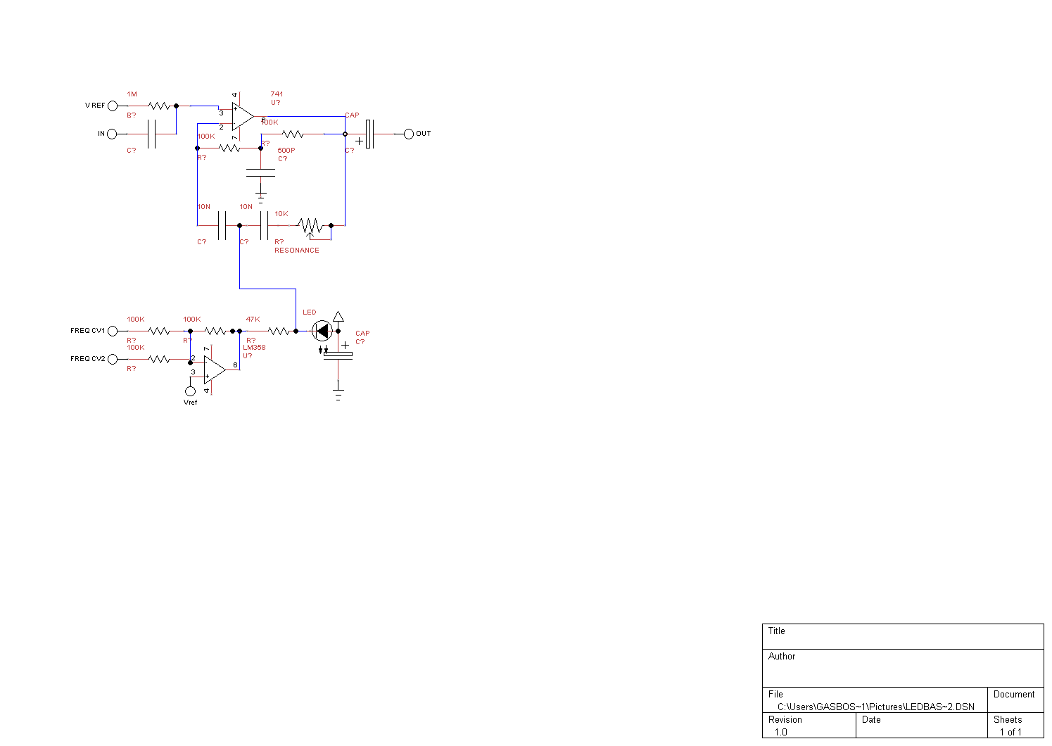

Hi, I'm new so forgive me for butting in!
I made a similar filter, using an LED and a 47K resistor, I got quite a good range from it but it was very unstable bursting into HF oscillation and causing the output to clip. Is this an inherently unstable circuit? Perhaps I need better supply decoupling...

The polarized capacitor you have on your LED might be to blame, if you get oscillation you may need to adjust the resonance control or input amplitude.

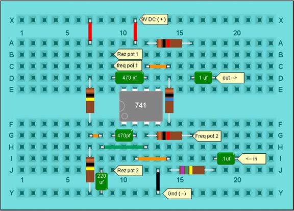

intersting filter
this filter sounds nice and i think we can mix the circuits
 Filesize:  41.08 KB
 Viewed:  114355 Time(s)
