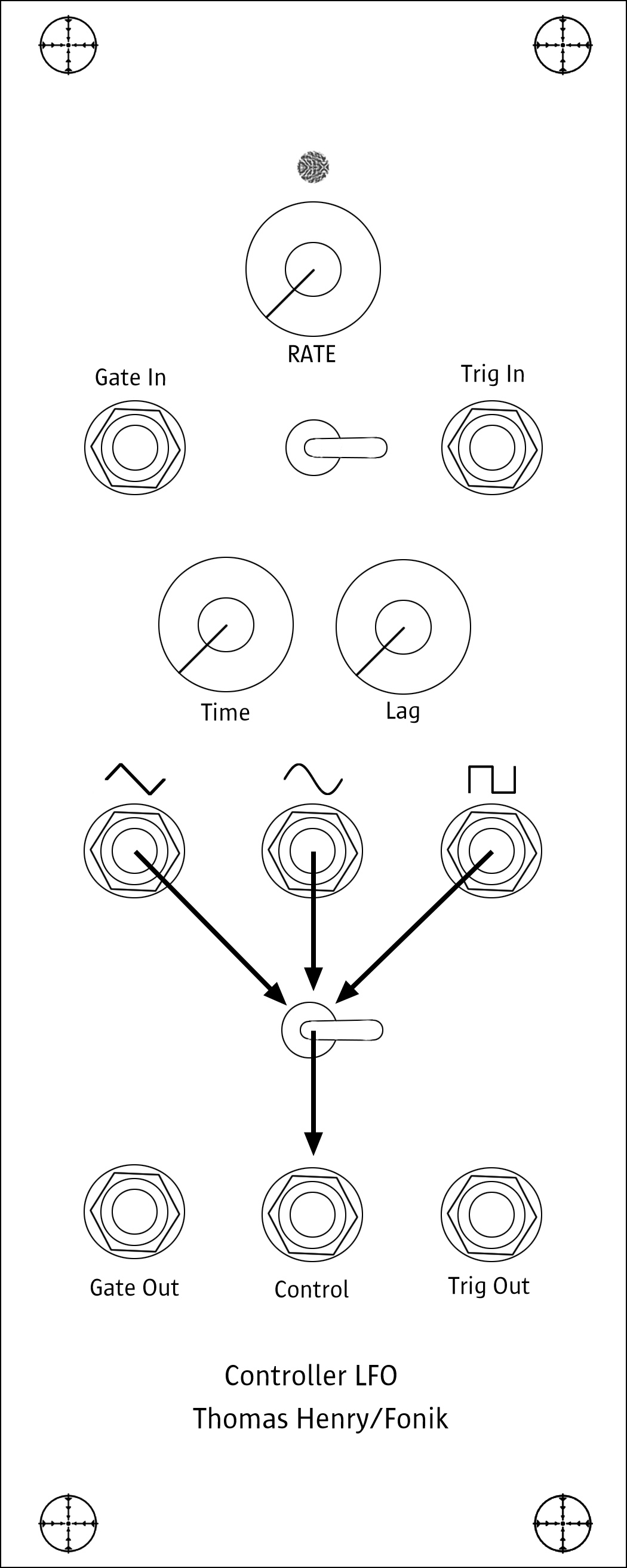

In case anyone's interested and not using Euro format Smile
This is my design for a MOTM-sized panel (2 wide) for this LFO

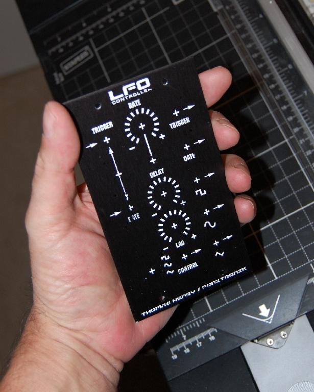

PostPosted: Mon Jan 14, 2013 7:52 pm    Post subject: Reply with quote  Mark this post and the followings unread
Decided to experiment with inverse printing, to try for a more traditional look....
Made some mistakes to learn from on my first try, but still closer to what I would like to see than I've been able to do so far....

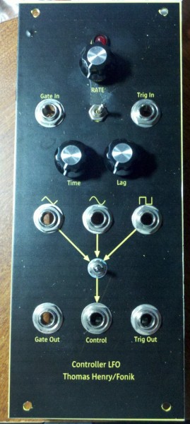

PostPosted: Tue Jan 15, 2013 10:43 pm    Post subject: Reply with quote  Mark this post and the followings unread
To assuage my pain at not having the last 3 100k trimmers I need, nor being able to get them locally, here is the panel with components on it Smile

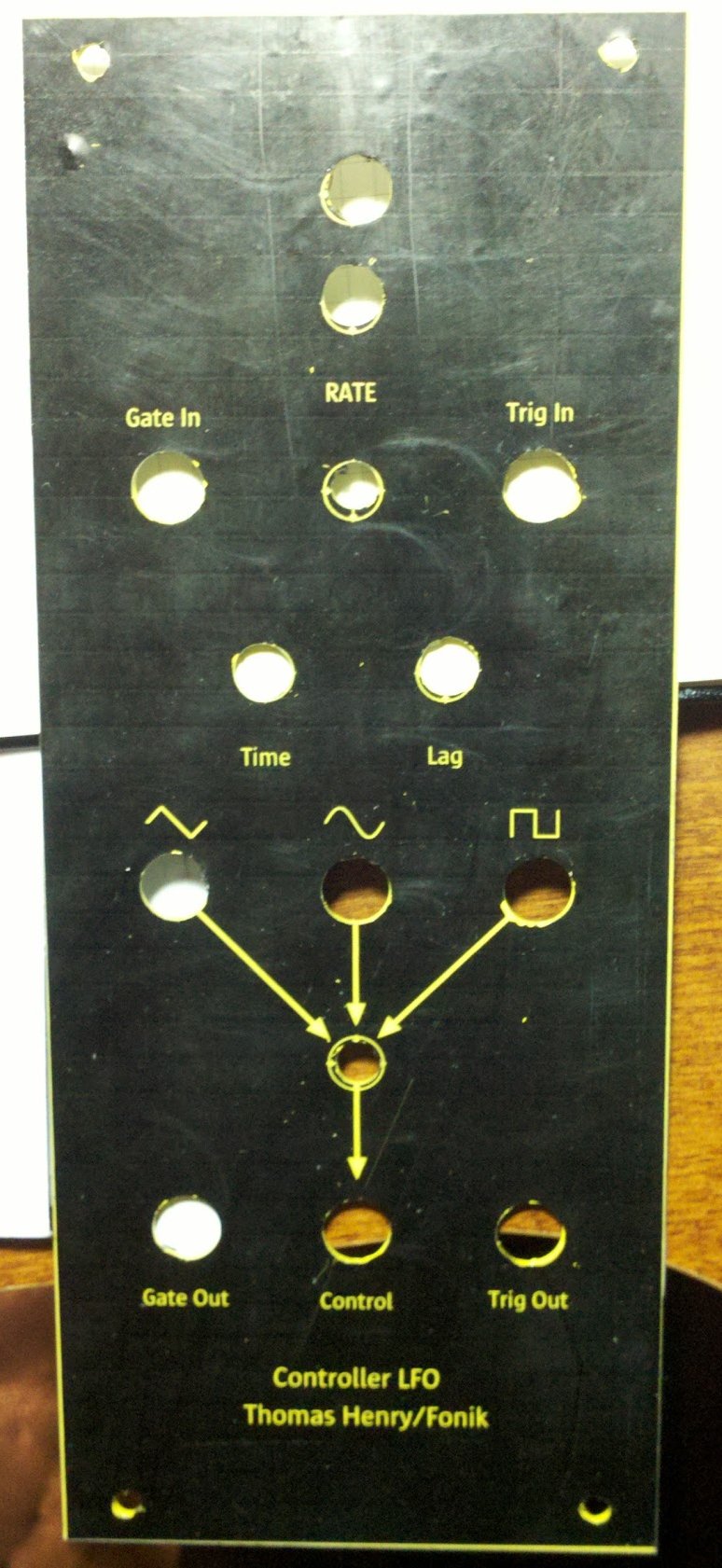

After hearing about DecalPRO on this forum, I decided to try it to make a Frac panel. I took off too much with the tape, and I need to get the alignmnet right, but it didn't come out too terribly:
 Filesize:  58.08 KB
 Viewed:  560 Time(s)

wow, that looks awesome! but it quite a lot of work, isn't it? how many panels had you to make until you got this nice result?
Actually, that was the first try; I lost some detail on the finer lines, and I'll try some wider ones.
It's really not too much work; it's kind of a decal version of Press 'n Peel Blue.
You print the design on the decal paper, laminate it to the white material, peel the white material off, clean off the excess (that's where I'm removing too much material), laminate a clear carrier material onto it, soak the paper off, spray on the glue, and then stick it to the panel. Start to finish, the first one took maybe 20 minutes.
