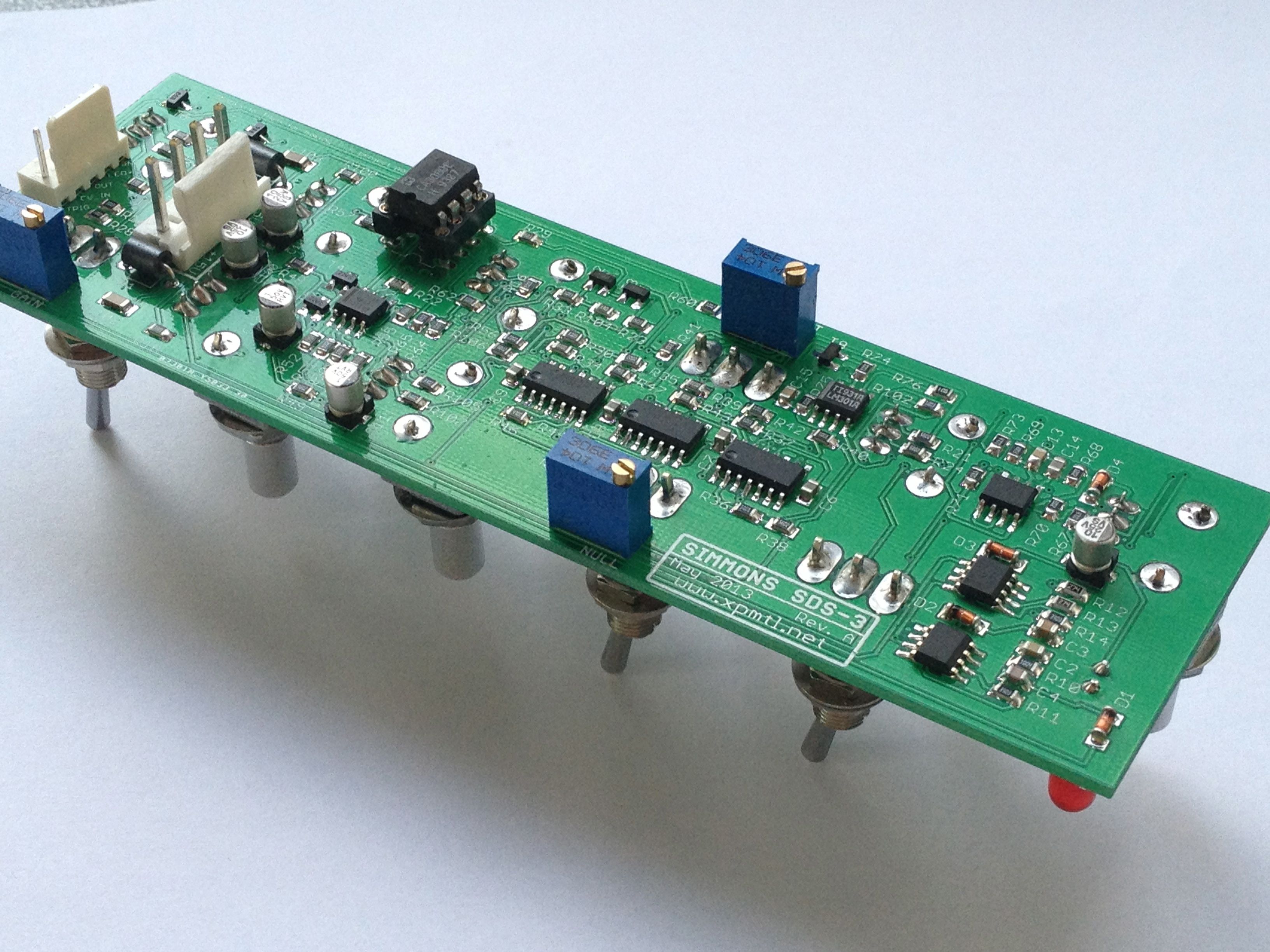

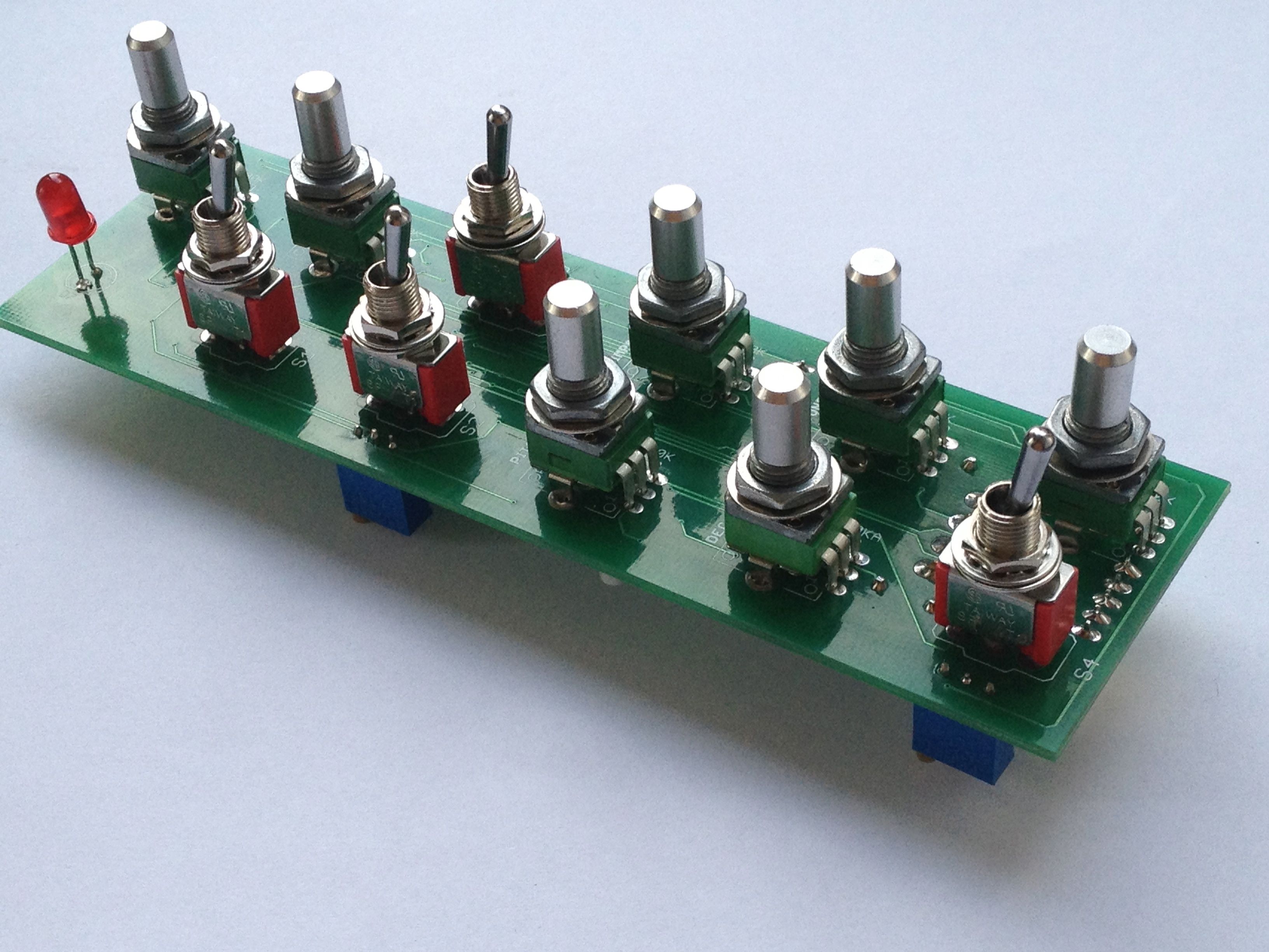

Populated that today.
Few things to iron out (noise is not working)... And i'll need to make another prototype as i wired the decay pot backwards again Rolling Eyes
More debugging to come Laughing
EDIT : Fixed the noise problem, apparently BC547 doesn't work for the noise circuit here, it does on my thru-hole prototype. Very odd.
I've replace it with a 2N3904 and it works. (Tim i'll send you those in replacement)

Nice clean layout xpmtl!
Four of those PCBs side by side would make a great SDS-3 package.
Great work!

xpmtl
Joined: Aug 10, 2007
Posts: 162
Location: Brussels, Belgium
PostPosted: Mon Jul 01, 2013 12:03 am    Post subject: Reply with quote  Mark this post and the followings unread
Thankies !
That was my initial plan Smile (I got 5 pcbs from iTead)
If only I didn't screwed up with the decay pot it would have been perfect Embarassed
Having the shortest decay on CW is a bit odd but i think i'll live with that. I'll just correct this issue for the gerbers i'll share.
I'll send the front panel design to engraving this week so i can test if it fits.
