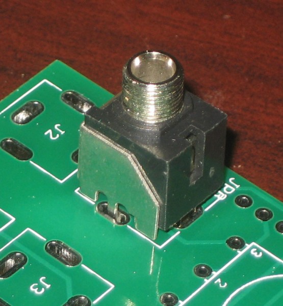

Here's mine. It uses slots on the milling layer, and is compatible with both the Erthenvar (QingPu) footprint as well as Kobiconn.
