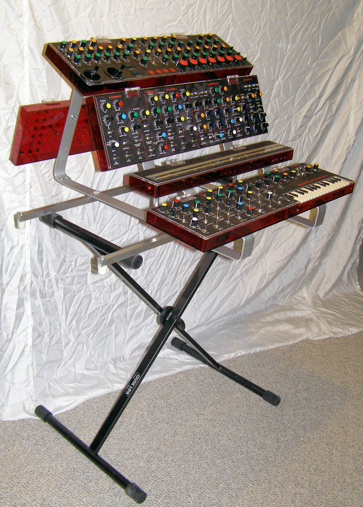

I am currently building a large synthesizer controller system which will include a very full featured volt/octave keyboard, an upgraded appendage ribbon controller module, and a wealth of other modulation controls. Force Sensitive Resistors are also being incorporated into a number of the modules. Details can be found here:
http://www.electronicpeasant.com/projects/synthbend/synthbend.html

PostPosted: Sun Feb 09, 2014 12:11 pm    Post subject: Reply with quote  Mark this post and the followings unread
After a year and a half, this project has finally been completed!

PostPosted: Sun Feb 09, 2014 12:35 pm    Post subject: Reply with quote  Mark this post and the followings unread
Great build Doug, and those synths look amazing too!

PostPosted: Sun Feb 09, 2014 12:39 pm    Post subject: Reply with quote  Mark this post and the followings unread
That's an inspired project! I like how it interfaces with the rest of the modules.
ps. greetings from Berlin from a fellow Albertan Smile
