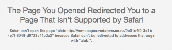

PostPosted: Sun Jan 25, 2015 11:57 am    Post subject: Reply with quote  Mark this post and the followings unread
Very clever as usual!
Works fine for me here in chrome, in Safari though it balks when trying to download the file:

PostPosted: Sun Jan 25, 2015 3:42 pm    Post subject: Reply with quote  Mark this post and the followings unread
Thanks Bob
Safari haven't made a PC browser for quite some time so it has fallen off my list of things to check.
Seems synthesizing a file download object using an array buffer is a known problem for Safari and there might be a work around I can try.
It doesn't work on IE, even IE11 for some reason as well. They are doing some major revamp of their browsers this year. Fingers crossed they will just start using webkit. Laughing
