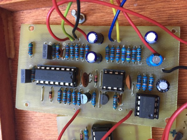

Finally a picture of the board, still not working..... Sad should i take a picture of the copper side too??

Posts: 5881
PostPosted: Mon Jun 01, 2015 4:22 am    Post subject: Reply with quote  Mark this post and the followings unread
yes please, and maybe a photo that shows how the pots are wired although I don't really doubt you did that correct.
(but have to rule everything out) the resolution is great! thumleft
I will take a look at it this evening and maybe do another test with my scope. Last one wasn't very succesful because
the levels are very low and there is a large DC offset voltage throughout the circuit. So I couldn't really get it into view
on my (old) scope and the AC setting seemed to screw it up. What's the level of your noise source ?, so I can use a similar
level.

Posts: 5881
PostPosted: Mon Jun 01, 2015 4:32 pm    Post subject: Reply with quote  Mark this post and the followings unread
I'm not 100% sure but it looks like you used a 4K7 resistor instead of 47K for R5. It's attached to pin4 of the LM13700
and on your photo it's in the top left corner between the 1nF and 22pF capacitor. Brown and red look a bit alike
though so measure it to be sure. The rest of the components are correct from what I can tell.
