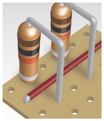

Generally that indicates that you extend the leads of whatever the component is so that it spans that many rows....

Yes, it is what elmegil just said. I can see the confusion though.
Some of those resistors are mounted upright. R1, R2, and R3 span three holes and are bridging the jumper wire which you circled in red on the left.
Also, C7 is a large capacitor and is shown mounted upright. You may find a different style with two legs at the same end. Whatever the type, mount it between the first and second row of holes in that position.

when you say bridging , you mean that it goes over the top of the wire with out touching? is that correct

Sorry about the confusion. It should look like this:

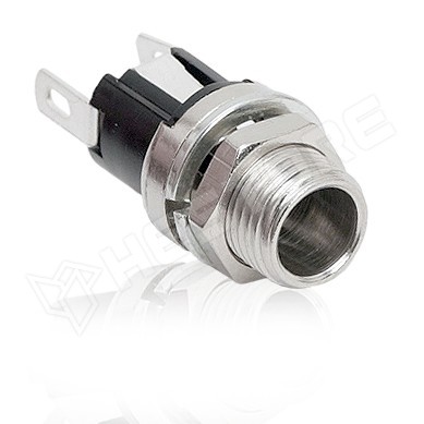

I'm having a serious grounding problem as well.
I've used this type of DC jack :
...instead of the normal plastic black one, now I know, It was a bad idea...

PostPosted: Mon Oct 02, 2017 12:16 pm    Post subject: Reply with quote  Mark this post and the followings unread
So, finally fixed. Amazing little thing!
