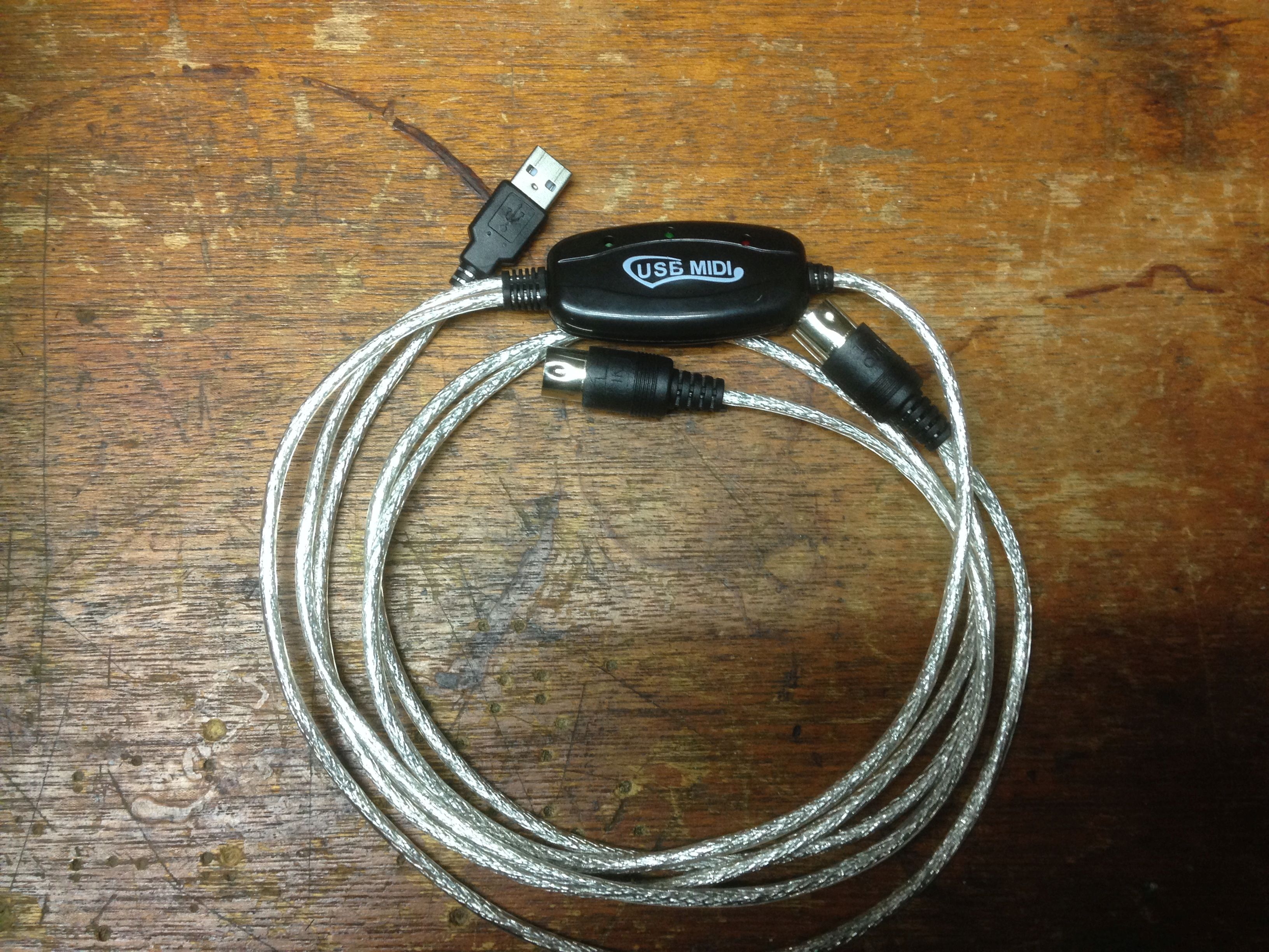

I have discovered that when transferring sysx files to the NL2 via CHEAP CHINESE MIDI CABLES such as the one pictured below your nord may do weird spasmodic things, like produce a godawful hanging ringing high pitched noises, and changing every patch in the bank, and even hanging notes like a hold function is engaged. I just purchased a Roland UM-1EX and all my problems have gone away and now my NL2 has all new patches uploaded on it !!! Hoora !!! So this is a post for future problems and hope someone finds this useful Smile
Cheap Chinese POS that was the root of all of my problems

Over the past decade I have seen many problems by users in several forums resolved by getting rid of improperly designed 1x1 interfaces. I have seen some write-ups of the apparent causes of the issues, including one excellent, very well detailed site. I will see if I still have or can find the link.
As I recall, sometimes it can be hardware related, sometimes it can be firmware related, including issues with lack of two-way communication, improper handling on running status and/or sysex, etc.
Glad you got your issue resolved. Thanks for sharing the resolution that worked.
