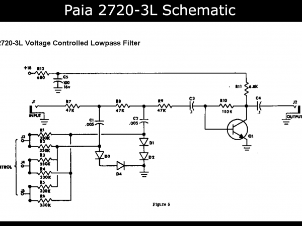

Hi all
Quick question for those of you with a stronger electronics background than myself.
I want to perf board this schematic up to play with. However I would rather use my existing 15v+- power supply for this version.
If I'm thinking correctly, I just need to change the values of R10 and R11
Problem is I loaned out the book I would usually refer to in such sercumstances.
Any suggestions?
I would like to try it rail to rail on the power supply to eliminate the offset
I'm thinking the diodes for control would still attach to 0V. Am I thinking correctly?
Could you elaborate on this, because I have no idea what you mean?
Are you saying you want the emitter of Q1 to -15 volt?
Because the input as the output are both AC coupled.

Yes grumble. That is what I was thinking.
Started to think about replacing the transistor with an op amp.
Not sure what my best option is.

why not use the circuit as drawn? there is no offset, the output is ac coupled as is the input.

Will give it a try.
