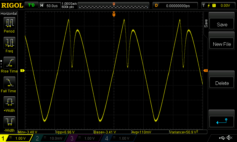

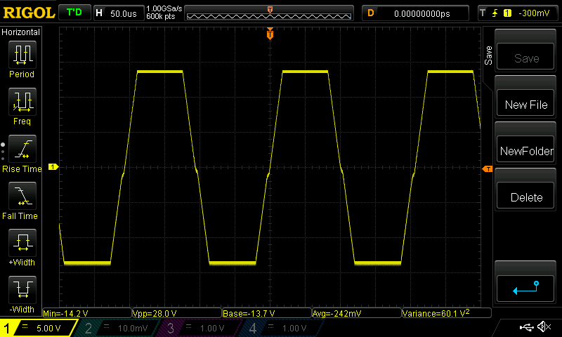

I've been given a VC-LFO2 module to check because "it won't go slow enough".
While trying to calibrate it I noticed the strange triangle and square waves.
Also if I try to modify the square wave there is no 10% - 90% scale. It goes to 'straight' line at +3 and -3.
See attached pictures.
Any idea? I have already replaced the BC557B, 7555 and U3. The original builder (not me) used TL084 and TL081 chips. Could that be the problem?
Also the resistors seem to have the right values.
KS
Measured at pin 8 of U2

Have you trimmed T1? Do the range switch and rate pot have any effect on the frequency?
I would focus on getting the saw waveform correct before worrying about the other outputs (the other outputs are all derived from the saw). The saw output should go between -5V and +5V.
The clipped triangle is odd though. Makes me wonder if pin 1 of the 7555 is connected to -15V instead of GND. Does it use a board etched from the Yusynth layout?
I don't think the 81 and 84 chips would be a problem.
The 7555 should create a ramp waveform at pin 5 of U2 from 5V to 10V. U2b buffers this ramp (pins 6 and 7 should match pin 5), then U2a inverts the waveform, doubles the amplitude and shifts the offset as adjusted by T2a and b. When set properly, the waveform on pin 1 of U2 should go from -5V to +5V.

I replaced both TL084's and that temporarily, kinda, fixed the problem, but it's still not working correctly. I notice the 7555 and bc557 are getting warm, where the bc557 is even getting too hot to touch for longer than a few seconds.
The problem still is that it 'stops' if I turn the frequency too low. The waveform just disappears.
All the controls are working correctly and pin 1 of 7555 is connected to and.

No, 0V is correct for those pins. The base voltage looks low. Not grossly out of wack but too low. I think it just needs T1 adjusted to get into a reasonable range.
The frequency that is shown in the scope shots from your first post are way too high (if I'm reading it right, you're at 50uS/div which means about 5kHz, shouldn't be over about 100Hz).
See if you can adjust T1 to get the frequency in a more reasonable range (base voltage above 14.5V). I'm hoping that this will also bring the emitter voltage up close to 15V. I'm thinking that it's dropping due to the low base voltage.
