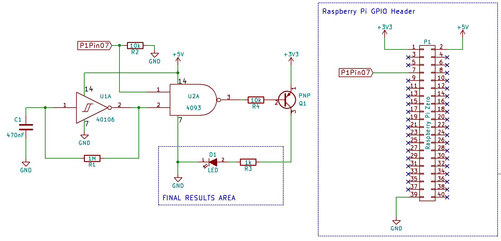

OK, I made the modifications as you suggested and it seems to be working.
I took out the addditional LED (Q1 onj the original schematic) as it was causing unnecessary confusion.
This circuit seems to be working properly, but I'm not sure if I have everything in the proper place.
Even though the output voltage of Pin 7 is 3.3v, it seems to be triggering the NAND gate effectively (I checked the data sheet and the lowest voltage is right below 3.3v, but it states that it requires a 5v trigger). I don't have any AND gate IC's yet, so I need to wait until I get one.
Do you see any short circuits or design flaws with this particular schematic?
This is a revision of the original schematic (that contained short circuits and errors). This schematic removed the flag indicator LED to make it simpler.

gdavis
Joined: Feb 27, 2013
Posts: 359
Location: San Diego
PostPosted: Wed Dec 14, 2016 4:36 pm    Post subject: Reply with quote  Mark this post and the followings unread
I'm a little late to the party so I haven't read the whole thread in detail, sorry if I missed something, but in your latest schematic, why the 5V instead of just putting everything on 3.3V?
Why is R2 there?
cerkit
Joined: Nov 17, 2016
Posts: 17
Location: Montgomery, AL USA
PostPosted: Wed Dec 14, 2016 4:40 pm    Post subject: Reply with quote  Mark this post and the followings unread
Why is R2 there?
The CMOS chips I'm using have trigger voltages of 5v and I'm driving all of my Lunetta CMOS chips at 5v.
R2 was recommended when I had a transistor on that Pinout frOm the Raspbery Pi, it may not be necessary any longer. However, when I'ts not there, pin 1 of the 4093 doe not ever go to 0v since there seems to be some signal coming through the Pin7 of the Pi when my program exits. Maybe it's floating at some unknown value.

cerkit wrote:
Why is R2 there?
The trigger level should be relative to VDD, the 4093 data sheet I looked at states a minimum VDD of 3V. If you're feeding it 3.3V, you really should supply it 3.3V.
if you want to drive 5V out then the transistor should be on 5V, not 3.3V.
You need to decide where you want to shift your level from 3.3V to 5V. If you want to keep consistent and run all your CMOS logic at 5V (which I think is a good idea), you should level shift the output from the PI. It may seem to work now, but as you noted from the data sheet, you're right at the limit which could make it unreliable.
R2 was recommended when I had a transistor on that Pinout form the Raspbery Pi, it may not be necessary any longer. However, when I'ts not there, pin 1 of the 4093 doe not ever go to 0v since there seems to be some signal coming through the Pin7 of the Pi, even when set to low.
Hmm, if the output is actively driving high and low the resistor shouldn't be necessary for the current circuit. I suspect the output might not be configured correctly, you may want to look into that.
cerkit
Posts: 17
PostPosted: Wed Dec 14, 2016 7:28 pm    Post subject: Reply with quote  Mark this post and the followings unread
gdavis wrote:
cerkit wrote:
Why is R2 there?
Thanks, that's basically the same conclusion I came to.
From an earlier post (I know this thread is a bit long):
cerkit wrote:
I have been doing research on the web to learn this, but sometimes it's good to get pointed in the right direction. I was also looking at the logic level convertors at Adafruit. I put the transistors in as a learning exercise for me.
I'm just going to wait until I get the logic level converters and do it the correct way. My "experiments" with transistors simply taught me that I have a lot to learn about theory. I'm trying to balance my time between "hacking" and learning theory. I know there's a basic level that I need to get to so I have enough working knowledge that I don't zap all of my components or kill myself with hooking things up wrong. Shocked
Ultimately, I do plan to graduate beyond blinky lights and actually come up with experimental applications combining CMOS Oscillators, counters, dividers, and the Raspberry Pi (plus my favorite programming language) to do interesting things with code and hardware.
