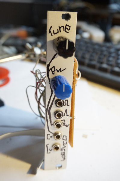

joshco
Joined: Nov 14, 2008
Posts: 55
Location: germany
PostPosted: Wed Aug 09, 2017 11:12 am    Post subject: Reply with quote  Mark this post and the followings unread
After almost ten years I finished finally a Rene Schmitz 4069VCO on perfboard Wink
4969VCO
 Filesize:  1.28 MB
 Viewed:  305 Time(s)

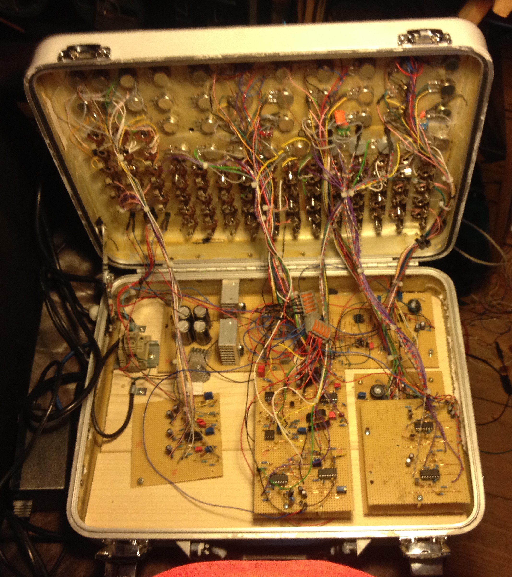

wackelpeter
Joined: May 05, 2013
Posts: 461
Location: germany
Audio files: 10
PostPosted: Sun Sep 03, 2017 10:23 am    Post subject: Reply with quote  Mark this post and the followings unread
Spent some days within the last weeks to start a new little case.
Not really finished so far as i have to build in the 4th VCO and some knobs are still on the way, but will be completed soon as i think.
When completed we have here:
4x ASM01 VCO with a Thomas Henry Expo converter
1x Serge triple wave shaper
1x Yusynth saw animator
3xLFO (from the Yusynth saw animator)
1x BPF from the Mutant Vactrol Filter by Scott Stites
Maybe must have a look at the BPF again as it's resonance is a bit too wild for my taste, even with the clipping diode and higher resistors in the feedback path... Guess it has something to do with my home made vactrols and their resistance specs...
Also have to sort the rats nest of wires at least a little bit.
 Filesize:  764.28 KB
 Viewed:  274 Time(s)
 Filesize:  989.11 KB
 Viewed:  289 Time(s)
PostPosted: Sun Sep 03, 2017 10:31 am    Post subject: Reply with quote  Mark this post and the followings unread
Synth in a Suitcase! I like it, definitely different to the Eurorack suitcases I've seen before.
wackelpeter
Posts: 461
Location: germany
Audio files: 10
PostPosted: Sun Sep 03, 2017 10:47 am    Post subject: Reply with quote  Mark this post and the followings unread
Thanks Alan,
for travelling definitely some advantage compared against handling a whole rack. Very Happy
Wish i had enough space left to build some little speakers in.
