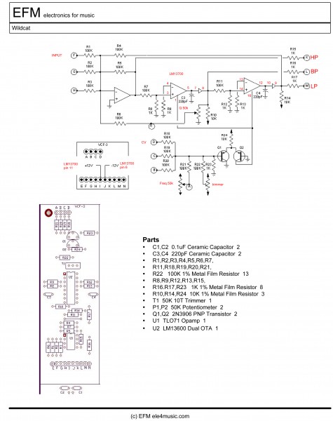

Made a layout for VCF-3 from EFM's Wildcat ,it's Oberheim type VCF i built once ,liked it so i thought i'll make another ..there were two errors in the layout which i corrected ,but there's no silkscreen so if anyone's making it gonna have to follow schematic ,that's what i do )) ,for the expo pair i used BCM857 cause i had some ,you can find SMD to DIP adapter at the Buchla 258 thread ,here is schematic and ready for print layout ,it could have been done better i'm sure ,there's a 10K resistor going from the expo converter to the OTA which is missing in the schematic but is included in the layout

there's another error in this layout ,the 10K from output to -15 , but there is room to drill two holes and put a resistor there to fit nicely ,i will update the layout

this is a really filter that i like , it sounds sweet , and at high resonance it's wild but not as bad like steiner can be .. this pcb layout is bit wrong ..around the expo , i never fixed it , and i lost the layout , i plan on making a oberheim sem type , but discrete ota based if i get it to work i will prolly post the layout , i used BCM transistors and rebuilt it on stripboard , i dunno how close it's to the demo you posted , it sounds nice

Does the schematic above have any errors? I know that the original schemo was missing a resistor and the layout above was missing a different resistor...
