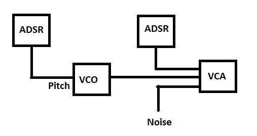

gabbagabi
Joined: Nov 29, 2008
Posts: 652
Location: Berlin by n8
PostPosted: Sun Sep 03, 2017 9:01 am    Post subject: Reply with quote  Mark this post and the followings unread
hm,
i need to understand ur needs better.
The way iam doing drums is like in the attached blockdiagram.
there i dont have a need for osc that can work with negative cv.
may u have a blockdiagram of what u are planning to do a bit more in detail?
for the tri vco - do u work with opamps or logic, which kind of power supply u are using? single/dual/12V/15V ?

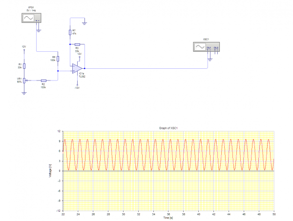

PostPosted: Sun Sep 03, 2017 9:39 am    Post subject: Reply with quote  Mark this post and the followings unread
Unless the VCO CV input range is larger than your CV signal you shouldn't need any gain at all.
If you do need gain then increasing R5 or R7 should indeed work. Personally I would increase R7.
In the simulation I powered the opamps with +-12v and simulated a +-5v sinewave as the input cv to the summing opamp..
With the standard 100k resistors doepfer mentions as the feedback resistors I only get about a 2 volt positive waveform at the output.
I did try increasing both the feedback resistors to even 1 M.. but it has the opposite effect of actually lowering the gain..
I checked and triple checked the schematic in the simulation and unless I decrease the resistors I see no net gain..
thepaddiscuile
Joined: Jul 11, 2007
Posts: 28
Location: ireland
PostPosted: Sun Sep 03, 2017 9:43 am    Post subject: Reply with quote  Mark this post and the followings unread
g.gabba wrote:
hm,
Yes this is how I am implementing the drums, but in order to modulate the drum vco cv with my modular vco's which would be +-5v I want to bias the negative portion of the modular vco's output to ground.. Assuming that I use a vco that is simpler to build running of a +v dc cv only..
I hope this explains it better..
Posts: 5873
PostPosted: Sun Sep 03, 2017 9:59 am    Post subject: Reply with quote  Mark this post and the followings unread
Something somewhere is wrong with the simulation. With all values 100K the output should be identical to the input.
At least when you leave out the offset resistor (=R8 in the doepfer schematic) which I think should be 240K for what
you want if it is connected to +12V. It is odd that it says 33K in the doepfer schematic although it doesn't mention what
voltage it is connected to. A 33K resistor together with the 100K will give a gain of 3x so if that is connected to +12v
the opamp just clips the signal. That could actually explain why you get the results you have and why lowering the gain
seems to help.
edit: gain of 3x was calculated without the potentiometer and input resistor
thepaddiscuile
Posts: 28
Location: ireland
PostPosted: Sun Sep 03, 2017 10:07 am    Post subject: Reply with quote  Mark this post and the followings unread
Whoops.. Rolling Eyes
I had the negative rail of the opamp mistakenly powered from 12v, I forgot to type in -12v as the power supply..
A 47k limiting resistor for R8 gives my a perfect 10v positive sine now..
Posts: 5873
PostPosted: Sun Sep 03, 2017 10:15 am    Post subject: Reply with quote  Mark this post and the followings unread
well that helps, good thing it is just a simulation Laughing
47K seems low but I calculated without a pot which would act as a voltage divider. If both have a value of 47K it would result
in half the voltage so 6V a bit more than needed but depending on how good the software is this could actually be correct.
So you could just connect a resistor from +12V directly to the inverting input of O1 which I think should be around 240K.
Unless you want the offset level to be adjustable of course.

PostPosted: Sun Sep 03, 2017 3:30 pm    Post subject: Reply with quote  Mark this post and the followings unread
I came up with this non inverting version.. It looks good in the simulation

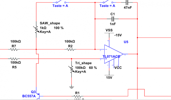

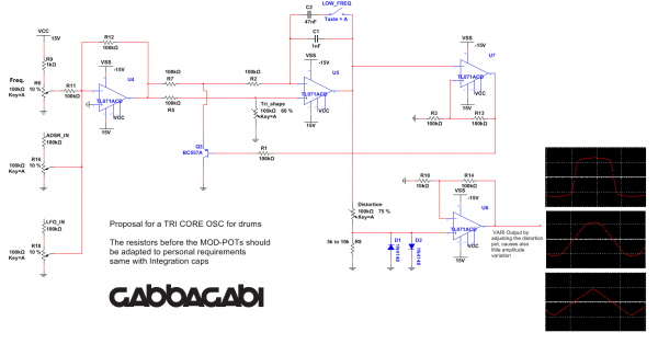

PostPosted: Mon Sep 04, 2017 4:03 am    Post subject: Reply with quote  Mark this post and the followings unread
the osc u have choosen is also my first choice for tri core osc.
i attatched a schematic of how i would do it. Only 4 OPamps so u can use a quad, and a little Variety on the Outputwaveform by distorting the Triangle.
The core does work with negative Voltage (by using a PNP Transistor), so u can use a inverting summer for mixing ur CV's. U dont need to pre-offset ur cv before.
from my experience i would do the resistors before the Modulation-Sensivity-Pots even higher to get more adjustebility, cos normally i apply only very small amount of modulation when it comes to drums
edit: pic2, there is even a little Hack i found in a elektor book on how to get a saw out of it

thepaddiscuile
Posts: 28
Location: ireland
PostPosted: Mon Sep 04, 2017 7:13 am    Post subject: Reply with quote  Mark this post and the followings unread
that's pretty cool.. Smile
Thats how I would have done it too with the summing stage but I didn't know about the Pnp trick.. So with a pnp instead of an npn you can use negative voltages ? Why have you tied the frequency pot to ground instead of a negative voltage if that's the case.. I would assume it would give you more range if it were tied to ground.
That sine shaper schematic I have used myself before.. Works great although I could never get a proper sine from it.. But close enough for music purposes..
Thanks for sharing your ideas..

gabbagabi
Posts: 652
PostPosted: Mon Sep 04, 2017 8:23 am    Post subject: Reply with quote  Mark this post and the followings unread
yes, with the trick-pnp u can, and must use negative CV.
so if u feed in a positive voltage in the inverting summer it comes out negative at the output. Than this negative voltage is going to the vco. So if u would tie the freq pot to -15V, after the middle position there would be a positive CV coming out of the summer, in that case the vco would stop.
regarding the shaper if ur incoming triangle is 10Vpp and well balanced around 0V u use a combination of resistors that have the relation of 1:6,8 u should get something similar to sine out. i use normally 10k/68k, yusynth for example uses 22k/150k. But of course it could never be a real pure sine.

gabbagabi
Posts: 652
PostPosted: Mon Sep 04, 2017 1:21 pm    Post subject: Reply with quote  Mark this post and the followings unread
the vco is working only with negative cv, but u apply positive voltages to the iverting summer which then provides the needed negative voltages to the vco.
if u set with the freq pot 10V and apply the full 10Vpp from ur lfo the CV is swinging from 5V to 15V or if u set 5V at the freq pot it will swing from 0V to 10V. Then everything inverted by the inverting summer.
